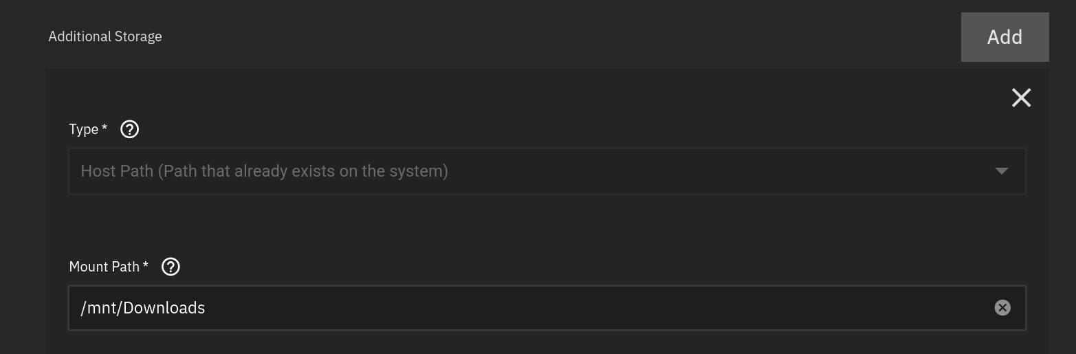

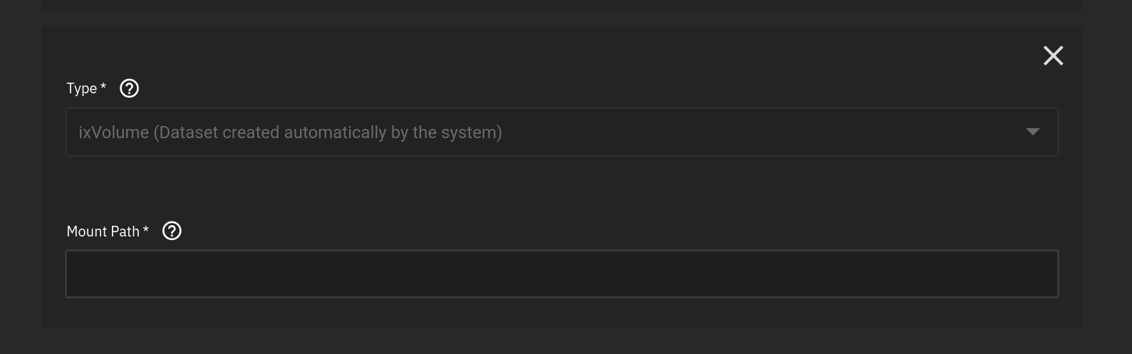

Hello, after upgrading my images, I noticed that for some of my apps (radarr, sonarr, jellyfin, deluge and sabnzbd), I am unable to edit (add or update) Host paths under Additional Storage. The Type box appears grayed out after I click on Add whereas I was expecting a dropdown. This was working previously. Moreover I am unable to see the existing host paths in the UI but I've confirmed that they are correctly mounted by dropping into the shell. Please see attached screenshots. For. e.g for Jellyfin, I'm running 10.8.11_1.1.1.
Unable to add a new path

Existing working host path but it is not shown in UI

Well it's literally written in the field: when choosing ixvolume, truenas will create a path znder ix-applications, which cannot ne Changed. Only when choosing hostpath you're able to choose an existing path or create a new one.

Thanks for your response. Previous to me upgrading those apps, I was indeed presented with that choice so I think I know what you're talking about. However post upgrade, I am saying that I am unable to choose between a) path under ix-application and b) hostpath.
