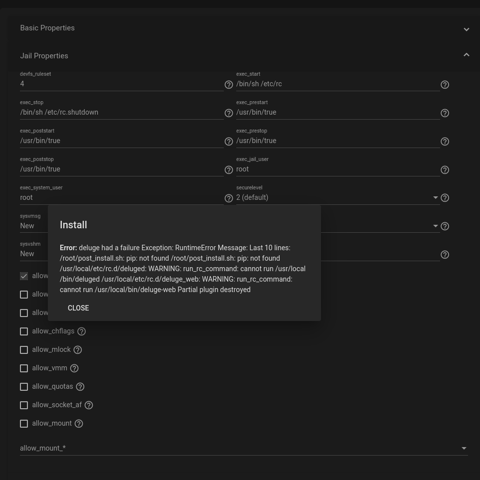

So i decided to delete entire jail and install a new. This to my amazement also failed and i cannot get deluge jail installed at all.

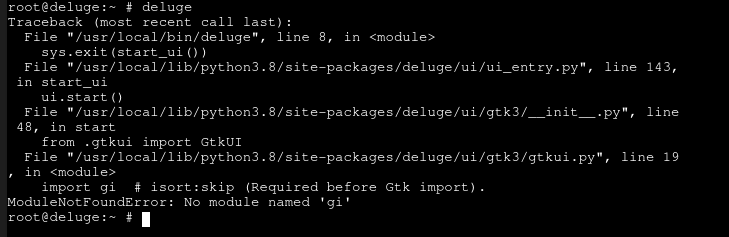

Before i removed the jail and after package updates there was some errors present when i write command "deluge" in the jail shell.
Attaching the pictures that contain errors i get.
It feels like phyton update in free bsd to 3.8 version somehow causes this. If anyone have some suggestions on what to do?

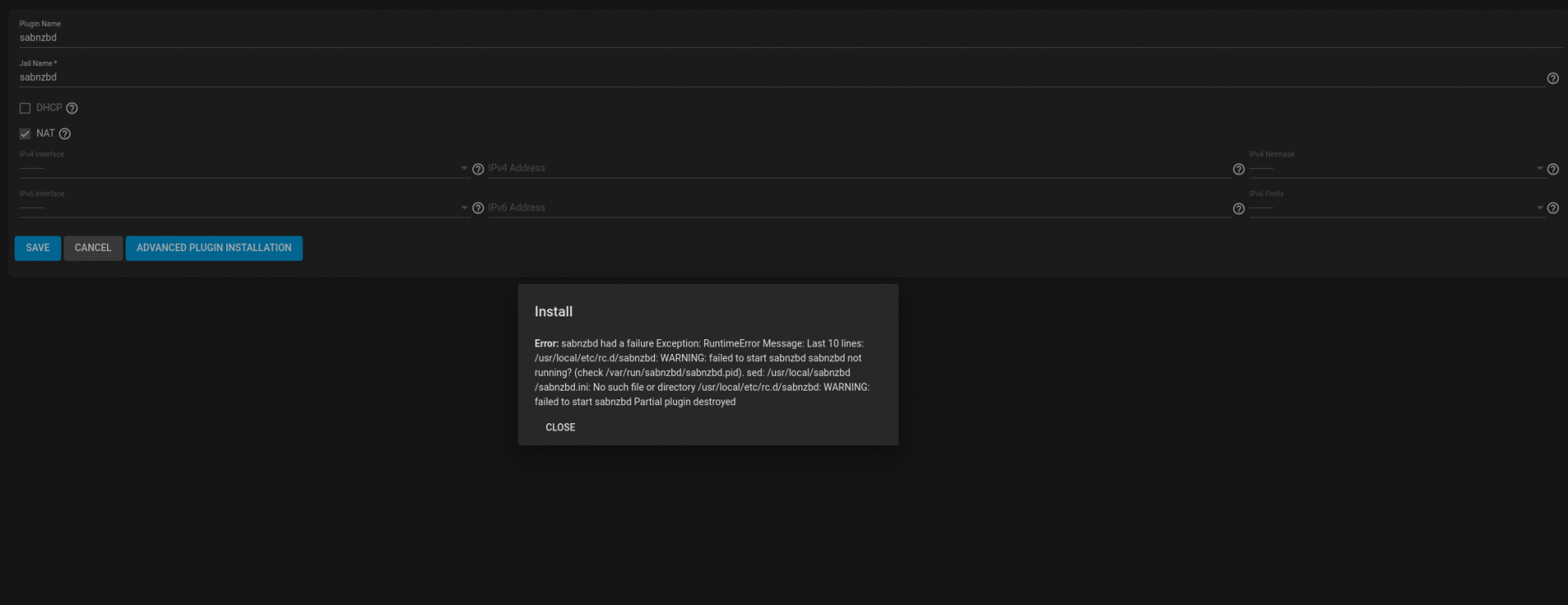

I'm getting a similar error on SABnzbd plugin install. Would you mind trying to install SABnzbd, to see if you get this error too?
Error: sabnzbd had a failure Exception: RuntimeError Message: Last 10 lines: /usr/local/etc/rc.d/sabnzbd: WARNING: failed to start sabnzbd sabnzbd not running? (cat). sed: /usr/local/sabnzbd/sabnzbd.ini: No such file or directory /usr/local/etc/rc.d/sabnzbd: WARNING: failed to start sabnzbd Partial plugin destroyed

Yes i can confirm similar error when trying to install SABnzbd.
Can anyone help us with this please.

It seems that main reason why plugin does not work is command pip which is not found if ran according to project script.
Hope this helps to someone.
