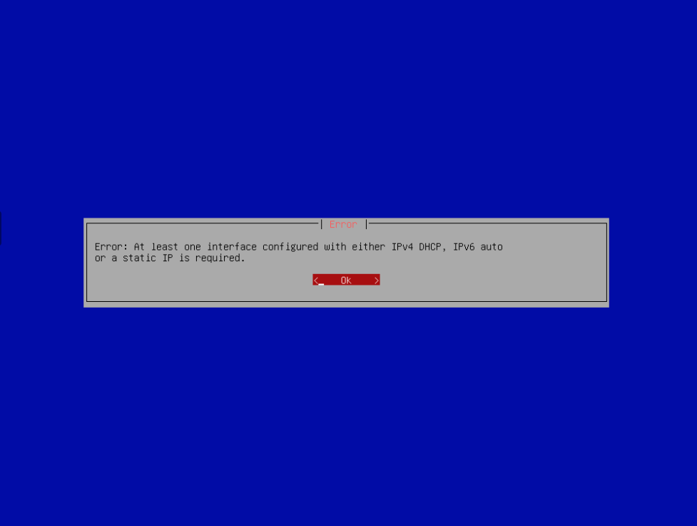

I can edit the interface and set DHCP to no, but there is no place to enter a static IP address. Then, after applying the change, the following pleasantry is received. Delete to remove the interface does nothing. The only option is to quit.

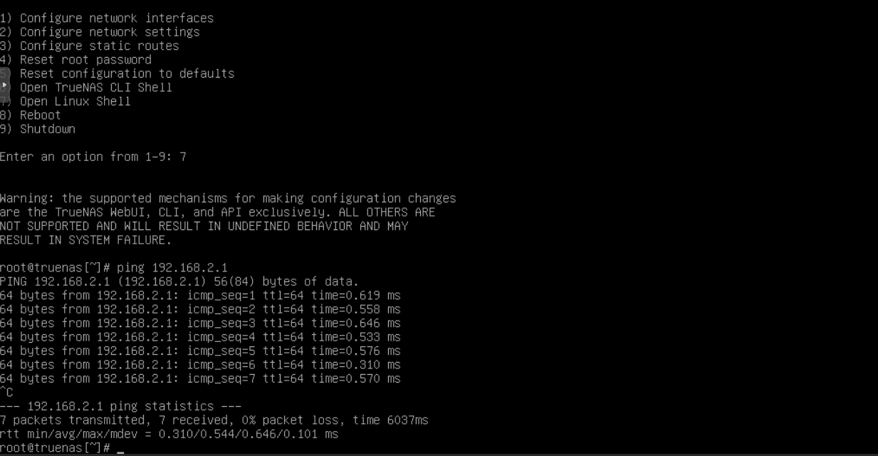

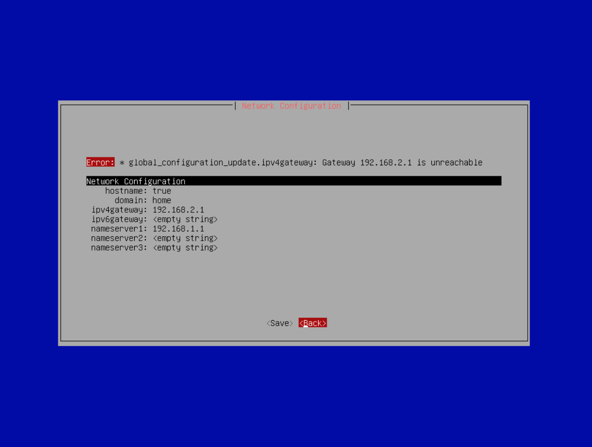

When I try to change the gateway in option 2 to a new subnet, I am greeted with this doozy...
Even though I can ping it from the Linux shell, so it certainly is not unreachable!

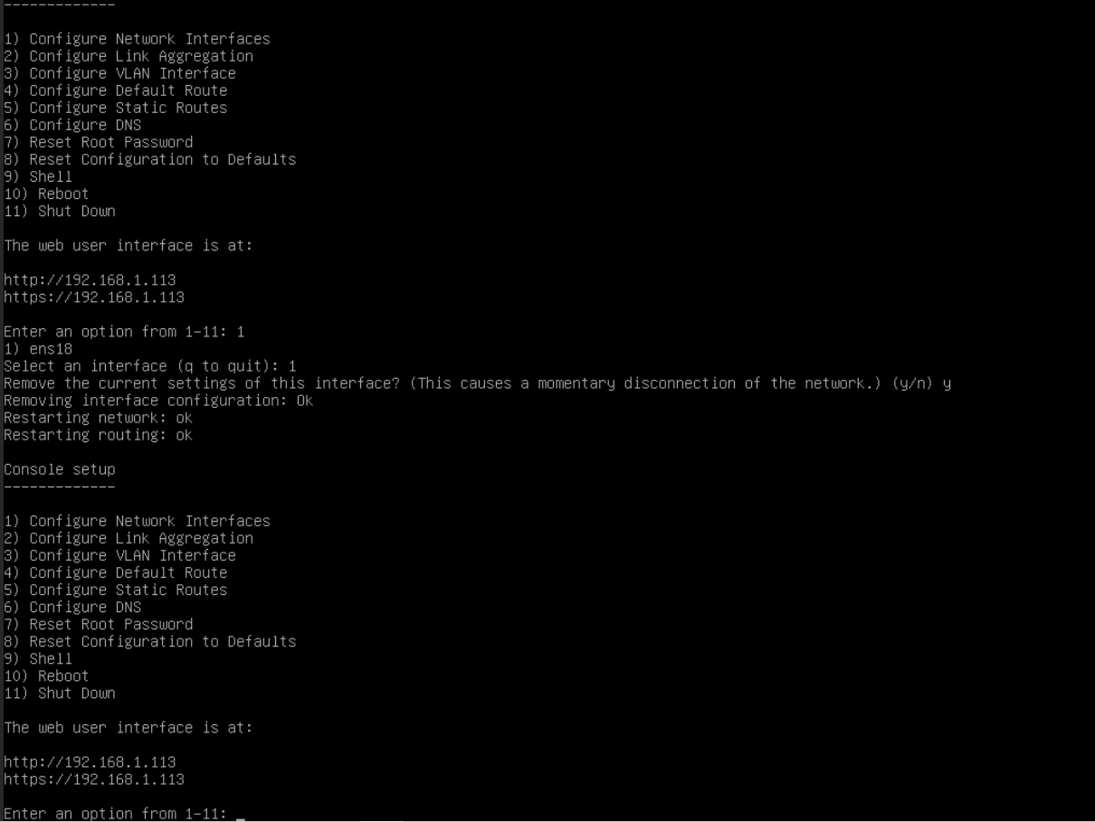

I tried running /etc/netcli and got the following...
As you can see... the network settings are removed, but the network is immediately restarted and the DHCP-derived IP config restored. No option is provided for removing the DHCP setting or entering a static IP config.
