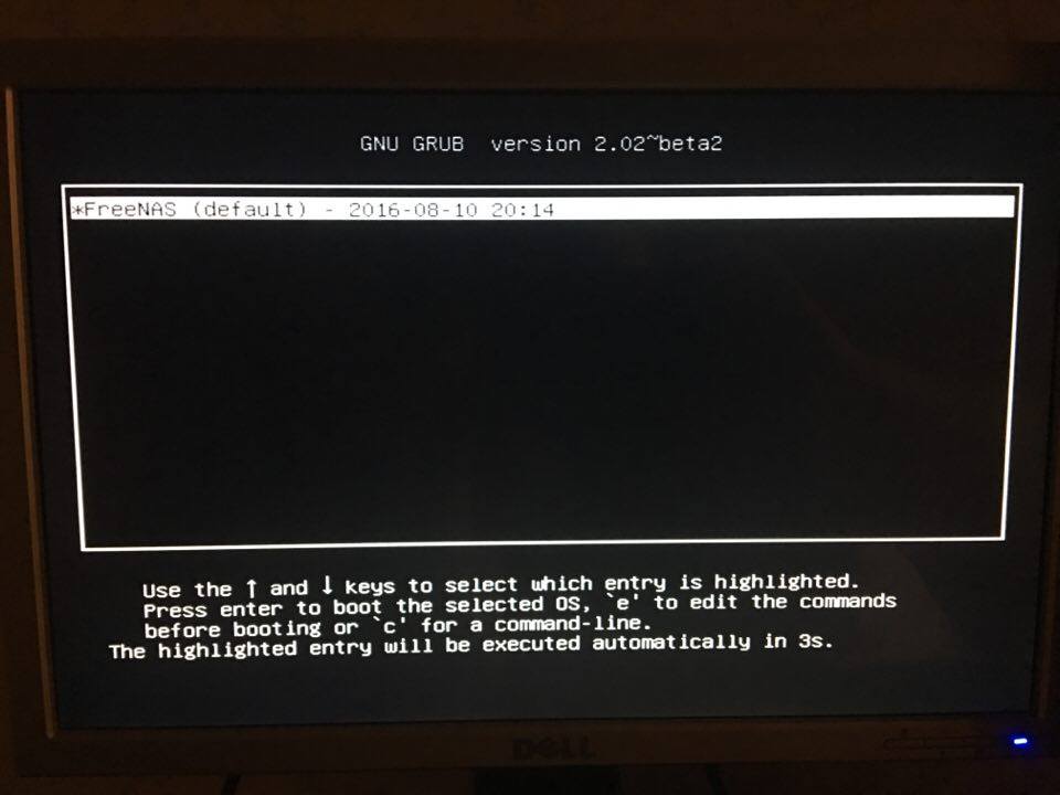

I have 3 1TB WD Blues installed currently but I'm not even getting to the point where it shows the command menu and IP Address of the system. I have attached a picture of where it gets. I can hit enter and get into the boot options and I can hit E to edit the three options. Once I try and boot it goes to a blank screen with no cursor. However, the screen is still lit and light is still blue (active). Doesn't matter to which option I boot I get the blank black screen with no cursor.
Tried searching and found a lot of stuff about blank screen WITH a cursor but nothing about just a blank black screen. It has no problem getting to the point below but seems as thought it will not load any further.
Thanks for your time.

how did you install freenas? did you follow the steps in the manual?
Me thinks something obviously went wrong. It has nothing to do with your drives because it seem you are not even booting into FreeNAS. FreeNAS should boot fine even if you don't have any data disks setup.
Have you checked in the BIOS to see if there are settings pertaining to booting from USB drives? Sometime boards can be finicky about this although I do not have any experience with the TS130 so hopefully someone who does will chime in.

Got it!
Hit enter at the screen I posted. Hit "E" on normal boot and changed the line from "set kFreeBSD.kern.vty=$kernvt" to "set kFreeBSD.kern.vty=vt" as per a suggestion in another thread.

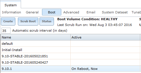

Edit: The "default" boot environment was set to initial-install, so silly noob mistake there. If you don't mind explaining what the edit does, and how it could be made to survive reboots that would be awesome!

Okay, then can you try this:
  1. Backup your config - [System] - [General] - [Save Config]
  2. In the GUI, select the "initial-install" and set that to [Activate]
  3. Then once that is done, select the "default" and set that to [Activate]
Try a reboot and see what happens.
