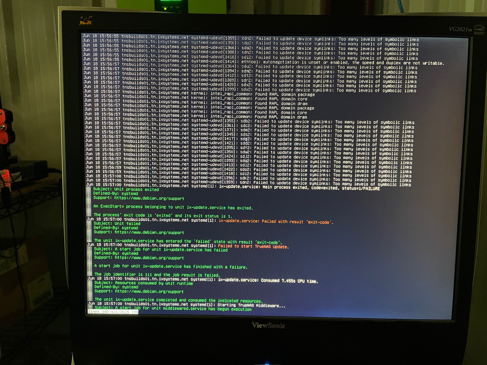

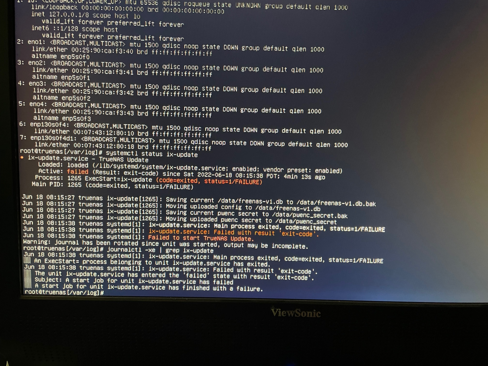

Edit 2: No, still no luck. I noticed during the reboot after uploading the config file that there was an error about the ix-update service having failed, and then it gave me the same message about middleware not running. Output of journalctl -xe wasn't particularly helpful:

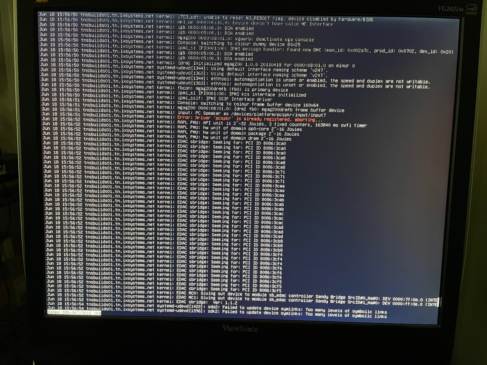

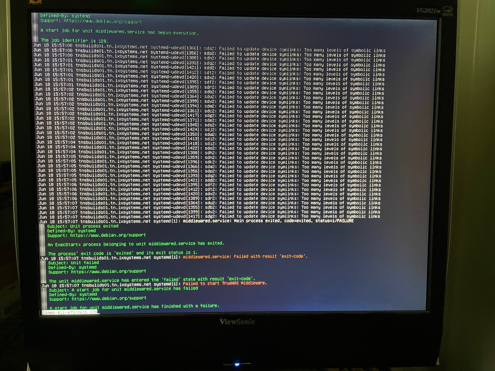

OK, I realize "install SCALE and upload the config file" isn't a "sanctioned" way to do the upgrade (though I think it should be). So back to the "official" way. Installed -U8 to what was to be the SCALE SSD, uploaded the config from my running -U8 w/o the LAG interface, rebooted. All worked fine so far. Uploaded the SCALE manual update file through the GUI, rebooted, and the same thing continues to happen. Trawling through the output of journalctl -xe, it looks like there's a problem creating symlinks for hard drives:
I'm also seeing some strange attempts to contact a LDAP server on a 10.0.0.0/8 IP, but that doesn't seem like the primary problem right now.
