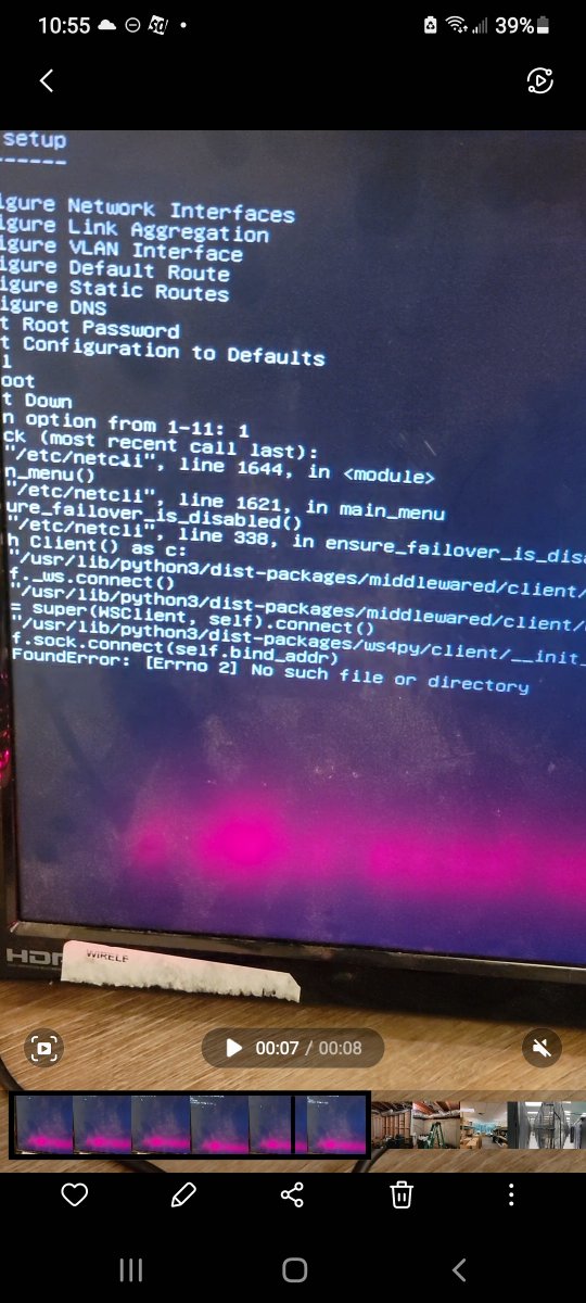

Hello, so i managed to install Scale no issues but when i transfer the data from CORE General-Save Config to Scale the server reboots and then i don't have a gui nor ip. When i press 1 to setup network nothing happens i see some words that flashes really fast but then it goes back to the main menu.

I took a video with my phone to capture the error

Patrick M. Hausen
Nov 25, 2013
7,776
Time to open a bug ticket in JIRA I guess ...

@Patrick M. Hausen Sadly enough in the video Tom uploaded a CORE config file into SCALE.
Like you said: Thats not supported, so @fvargasfrank shouldn't had to file a bug report.
He didn't just import a pool, he indeed uploaded a core config file as well. Which is not supported.
Please remember folks: Tom actually bricked the system in the video.

It was my understanding that he was trying to import a pool on a clean installation of SCALE. @fvargasfrank if you didn't, please try that. If you did, I would still recommend the bug ticket, because ZFS itself should have feature parity and import is supposed to work.

NO! You cannot import the config. Period.
Fresh install of SCALE, boot system, go to the UI - Storage - Import, import existing pool.
That's all that is supported currently. You will have your data but you will have to re-create all users, all shares, essentially all configuration.
