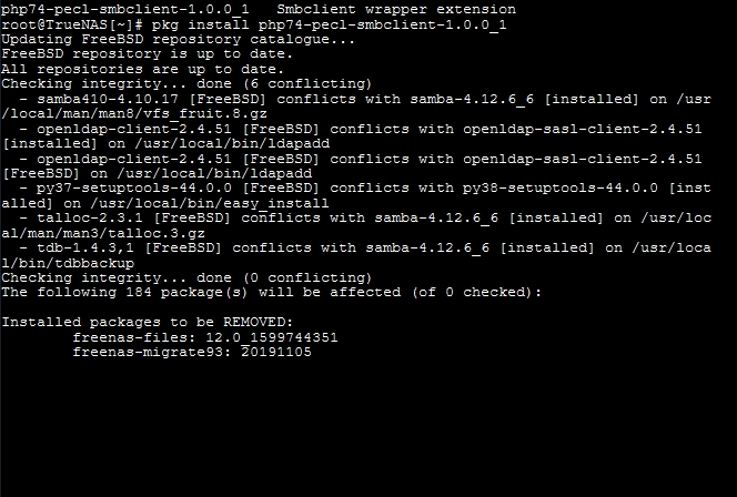

Hi there,
I'm trying to install the missing php 7.4 smbclient module, required for mounting external storage services and devices for Nextcloud jail running on TrueNAS-12.0-RC1.

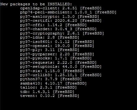

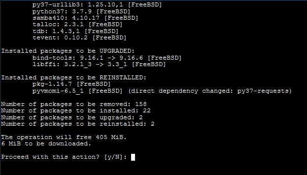

The issue is that the pkg manager wants to remove a whole bunch of packages including a couple of freenas ones (1s attachment)
The result is that the boot sequence becomes corrupted and asks for manual root filesystem mounting, that fails with different codes .. 2 , .. 5
Can you please give me a hand on this, 'couse I'm lost here.
Thank you!

You don't install packages on the root file system, you install them in the jail.
