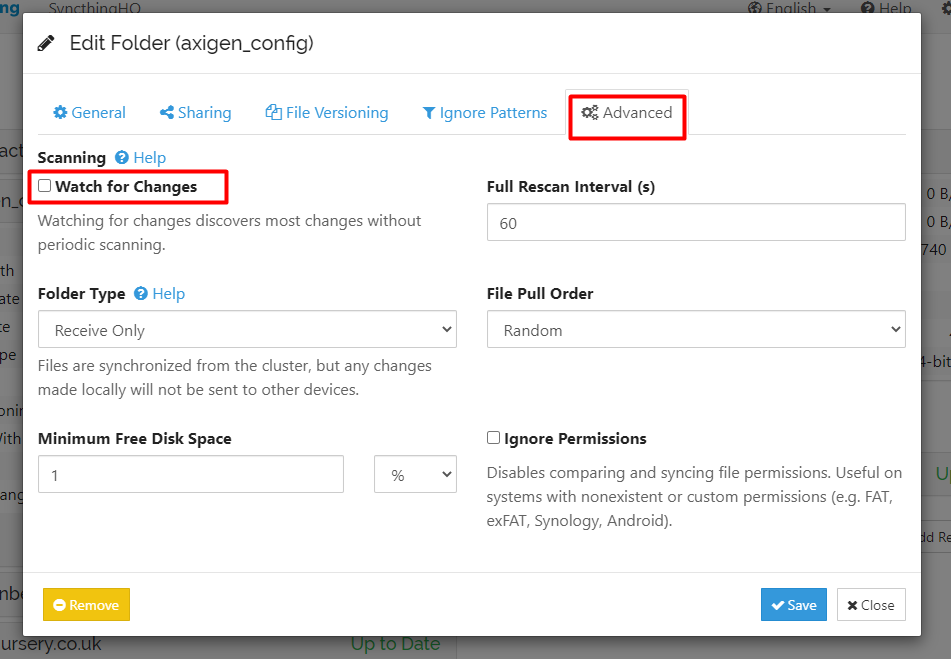

My system work perfectly as long as the do not set the watch for changes to files.
I have 15 folder in my Syncthing, and the folder's size vary from 2GB to 25GB. How does your setup compare if you enable 'Watch for Change' on multiple large folders ?

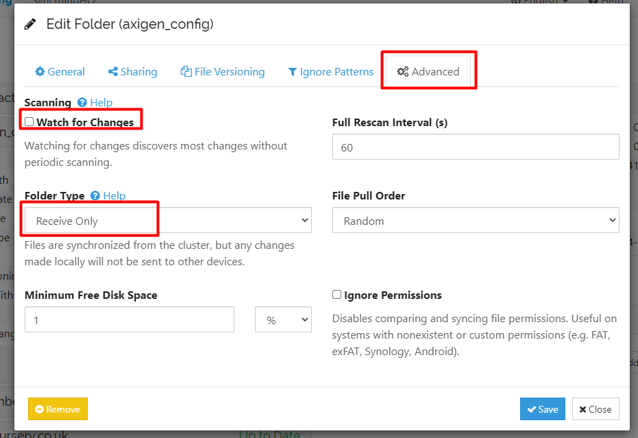

Assume I will remove Syncthing from TrueNAS, and just use it between my 2 pc's and phone in stead.
...OR just do what I do. If you unchecked the box I mentioned in previous entry..Everything work fine. TrueNAS is the recipient so I dont need to watch the folder.
In the Syncthing on TrueNAS, I set the folder to receive only and disabled 'Watch file'

I have syncthing running in a business setting on TrueNAS Core. It's about 800gb of data and 100's - 1000's of file changes everyday. I have turned off watching changes for all shares and set my folder to receive only. The system seems well managed with average 3-5% cpu usage.
