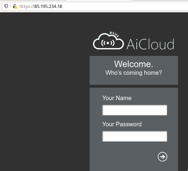

- install and start syncthing plugin, open a shell inside the jail and use: netstat -p tcp
as you can see here, there is an ongoing connection to IPv4 85.195.234.18 at port 22067 (dynamic syncthing port)
I connected via browser to the IP and got this

I do not know the provider, the NAS behind the IP and did not configure the plugin to do so!
Hopefully I'm completely wrong, but it looks like a backdoor in the official plugin to steal data. o_O

I took a quick look here, and it does appear that syncthing makes a bunch of outgoing TCP connections. Syncthing does appear to support talking to a bunch of relay/discovery servers by design though, so this is somewhat expected IMHO:
For kicks I did audit the plugin sources, its super small, so not much to look at. Nothing obviously wrong there, its just running stock syncthing. Suggest maybe posting something to their forums / help to confirm this behavior is expected?
