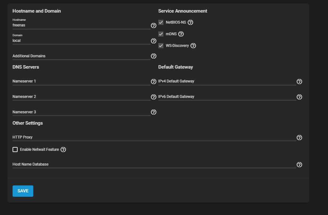

Hi, please see attached. nothing has been configured. maybe this was emptied during theTrueNAS-12.0-U2.1 upgrade.
Shall I enter gateway to the IP of the router and dns as well?
BTW the truenas should receive the IP and gateway by the mikrotik router.
UPDATE: I added the routers IP address in both gateway and dns 1, but no change. [I didn't reboot truenas, is not needed for these changes, correct?]
UPDATE2: I thought of trying to ping another device on the local network, so I added the exception to the firewall rules. And after doing this, suddenly it also worked again for the android boxes. Great of course, but a little worrying that this can happen in this way using a professional router.
