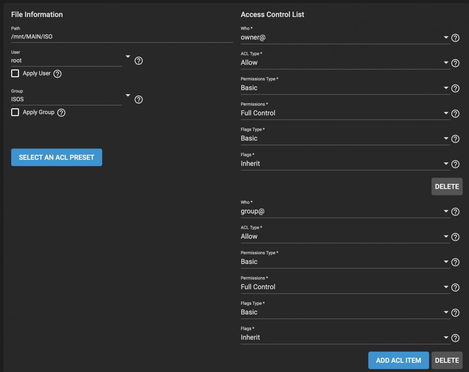

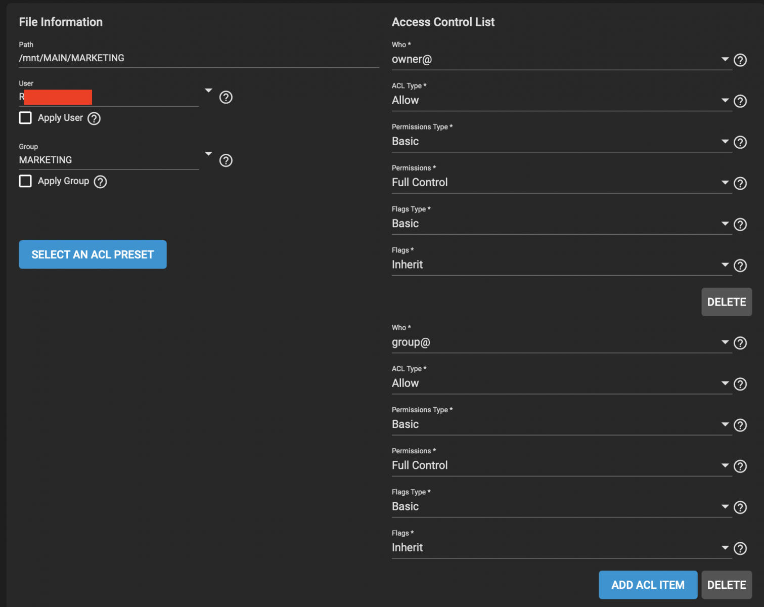

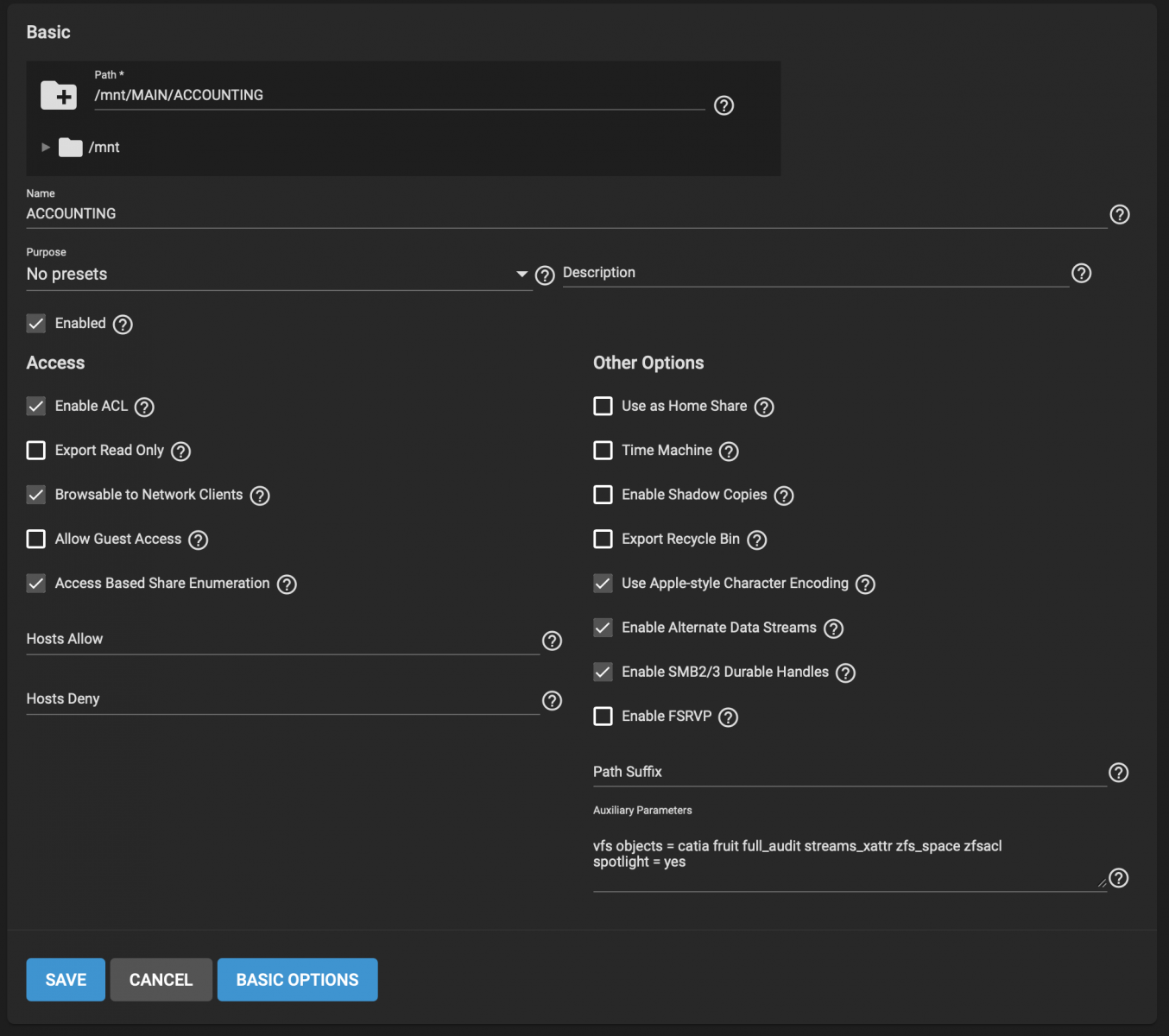

I just updated from 12.0-U2.1 to TrueNAS-12.0-U4 and all my SMB shares stopped working (permission denied)
I saw this in release notes and I assume it's caused by this because all my shares had the user set to root
TrueNAS "root" user account cannot be an SMB user.This is an intentional change to improve software security and suitability for deployment in a variety of environments. Update the SMB configuration to use a different user account.
So after some reading here is what I did
-I deleted all SMB shares configs
-I stripped any ACLs
-Made new ACLs with a new user (not root) and full access from group and user
-Applied recursively
-Made new share configs with the same settings as the old ones
After that defying all logic it still doesn't work
-User is in the needed group
-All files have new permissions that allow access from that group
Had to revert to U2.1 for the time
I'm attaching my before and after ACLs (ignore that its a different folder) and share config
What I'm missing? Probably something very obvious haha
Thanks in advance

I don't see any reason why U3.1 would work, but U4 wouldn't. Based on the screenshot it looks like you are using vfs_full_audit. If the VFS operations that you are trying to log do not exist in Samba 4.12, access to the share will be denied (fail safe regarding auditing).
anodos
Sambassador
Mar 6, 2014
9,553
Why would vfs_full_audit not work in U4?
It works, but you need to understand that vfs_full_audit is intrinsically dependent on the underlying VFS implementation in Samba (its parameters explicitly reference VFS functions). The VFS in samba is in the process of a rewrite. Samba 4.12 removed / replaced many VFS functions and you will need to alter your logging parameters accordingly. See man vfs_full_audit in TrueNAS 12.0-U4 for a list of supported logging parameters.
