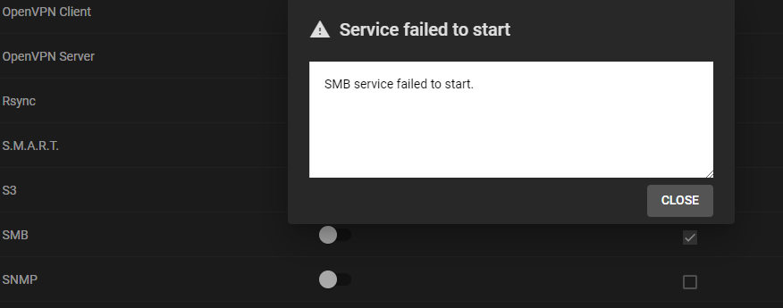

If I go to my Truenas Server through my browser using the ip address the interface is all there but I discovered that SMB shares are not on and neither can I start them. "SMB service failed to start"

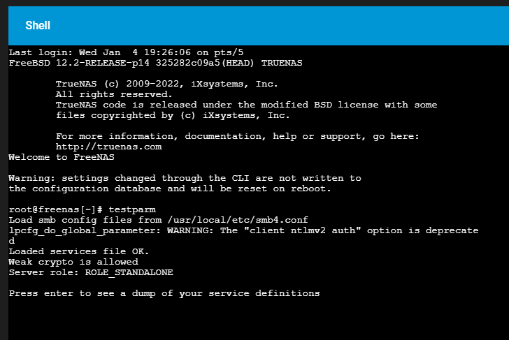

Can you run the following and post the output here in code tags?
zpool status zfs list testparm

Thanks Redcoat, this is one of the first thing I checked. SMB service was stopped but when I tried to start it I just got this:

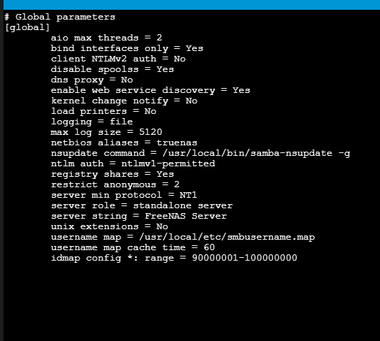

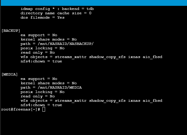

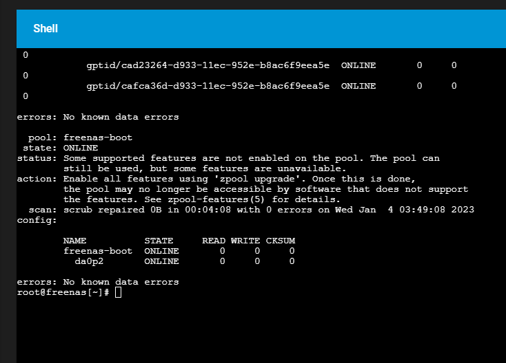

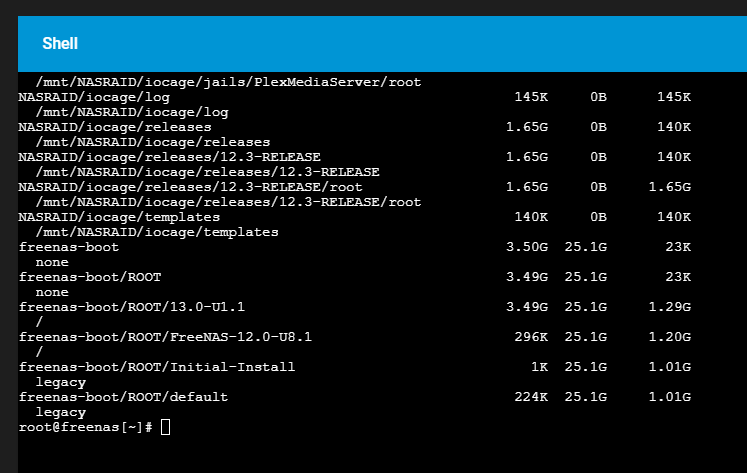

I ran what you asked and these are screenshots of the results. I hope this is what you meant.
Does this help?

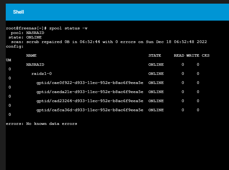

You clipped the top of the datapool status display - can you try
zpool status -v
Vike
Apr 22, 2022
12

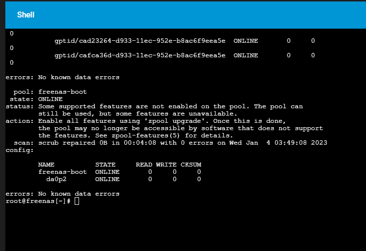

the -v switch didn't seem to make a difference but I scrolled up to take this:

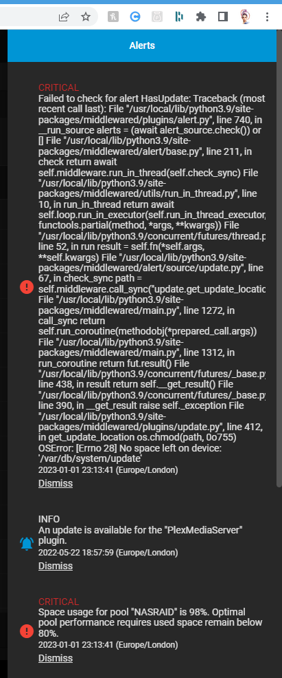

I don't know if these critical alerts help. The lower one about space usage I can understand. But the top one about Failed to check for alert HasUpdate is beyond me.

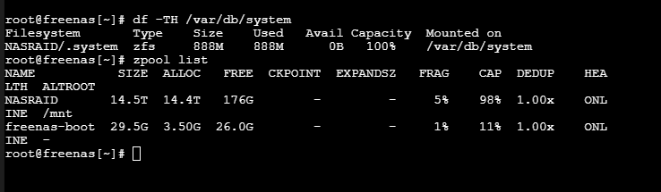

That means that either your boot disk is probably 100% full, which might also explain why Samba is failing to start.
What is output of zpool list and df -Th /var/db/system?

df -Th /var/db/system AND
zpool list:

Yup. Your system dataset is on your data pool and has zero free space available. You'll need to free up space otherwise SMB won't work
OK, so how do I free up space on my datapool if I can't access the pool to delete the oldest data. Would I need to clear the lot and start again?
