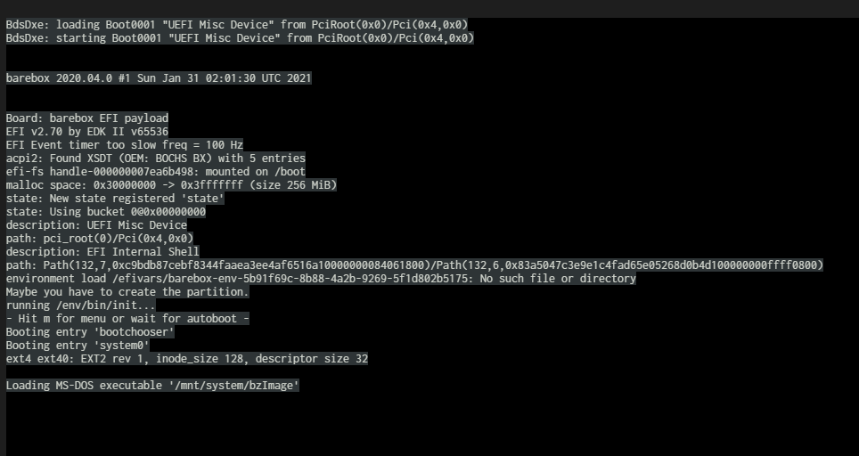

Zain
Mar 18, 2021
124
Hello,
Any idea why I might see the error below? Based on what is visible, I presumptuously increased the amount of ram available to the VM but it has no effect on alleviating the issue.
I'm asking here because I used the method above for the <attempted> install.
TIA
