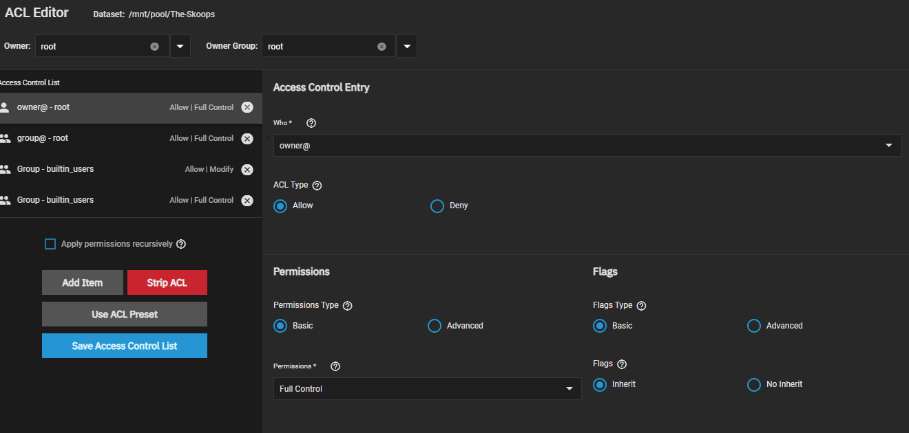

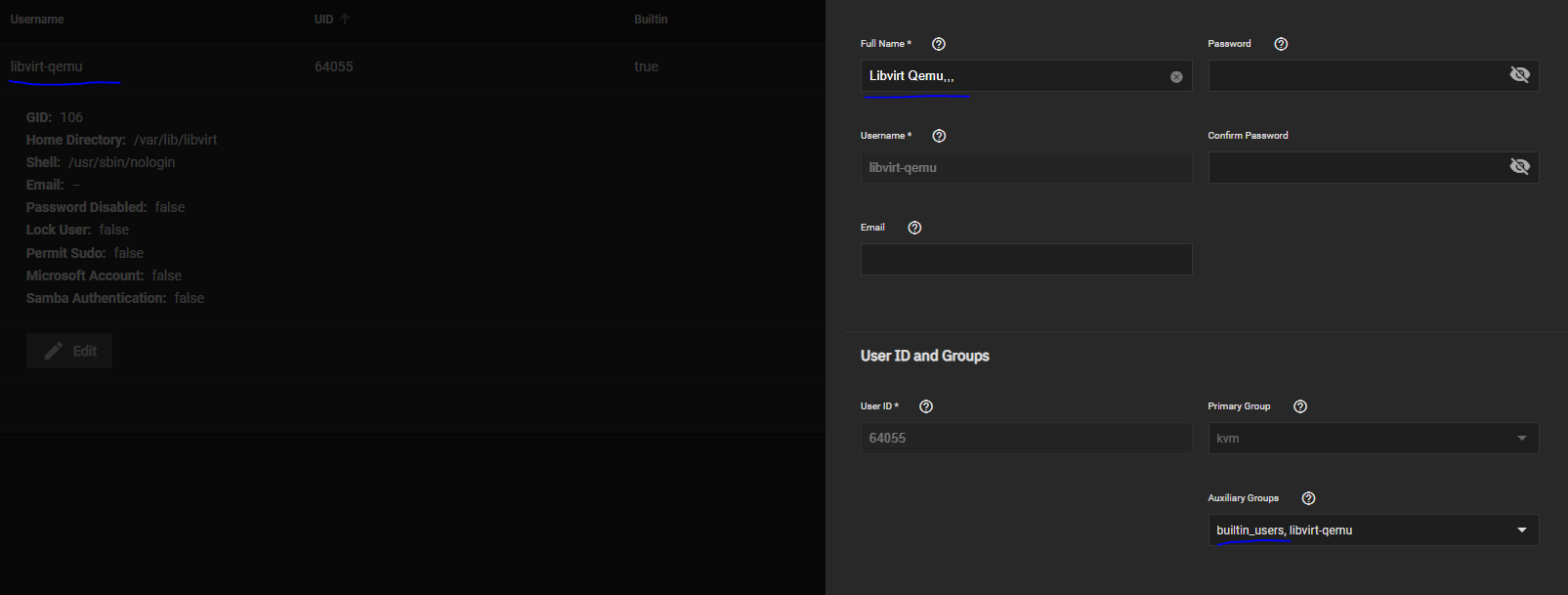

Had the same issue today with the ISO permission and also when i tried to "chmod" with the root user got "Operation not permitted".
I have tired what @anodos said and it worked.
used the GUI, attached screenshot.
In my ACL permission i have "Group - builtin_users" with Full control.
What i did, searched for the "libvirt-qemu" user in users credentials and add this user to "builtin_users" as an "Auxiliary Groups".
Then it worked.
Hope this help

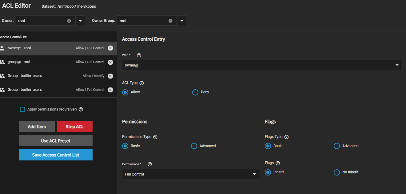

Then it worked.
Hope this help

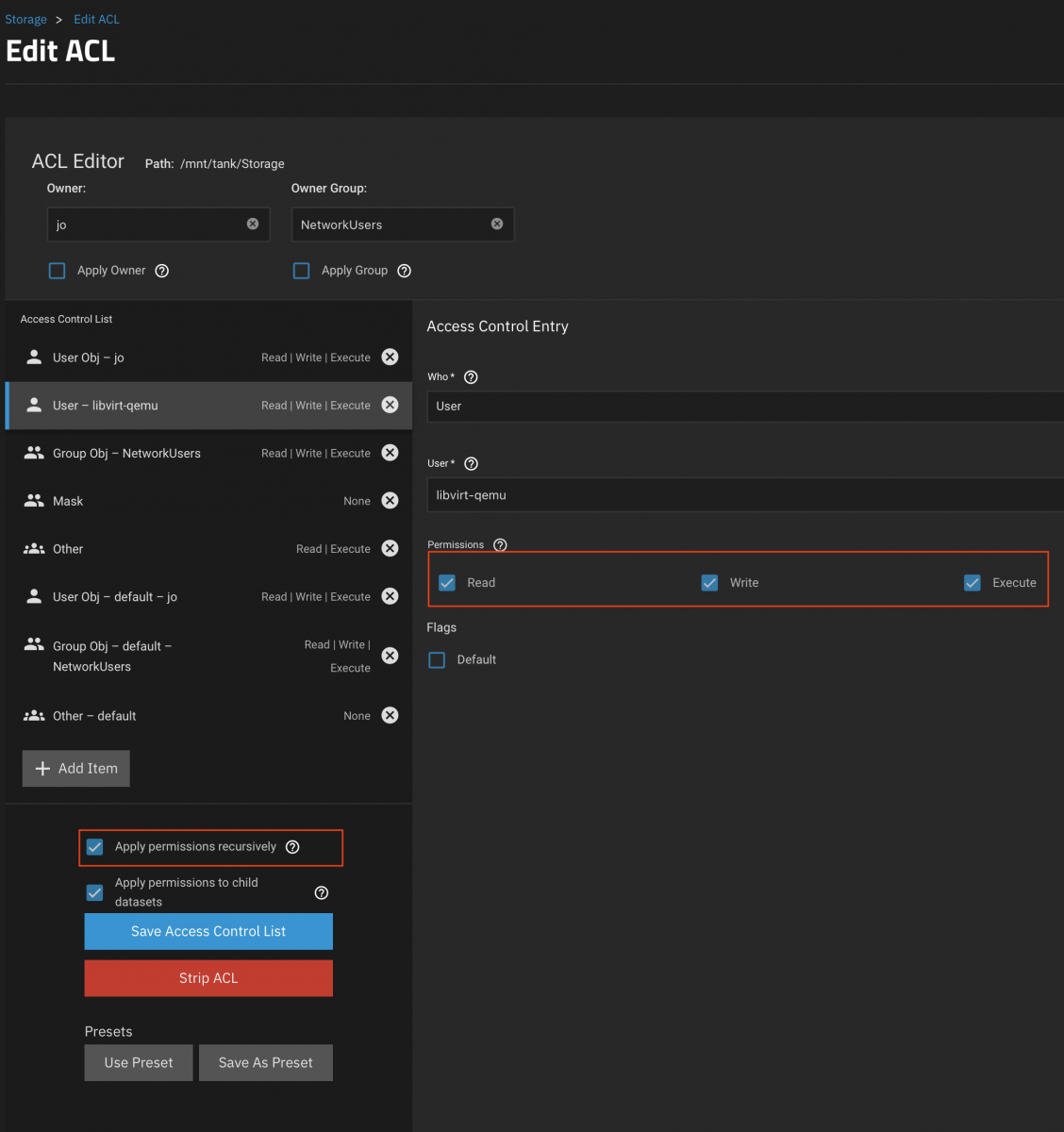

Running TrueNAS-SCALE-23.10.2 for the first time and had the same issue. Was able to select the .iso after relaxing the User - libvirt-qemu ACL on the Dataset where the .iso was located from Read -> Read, Write, and Execute.
