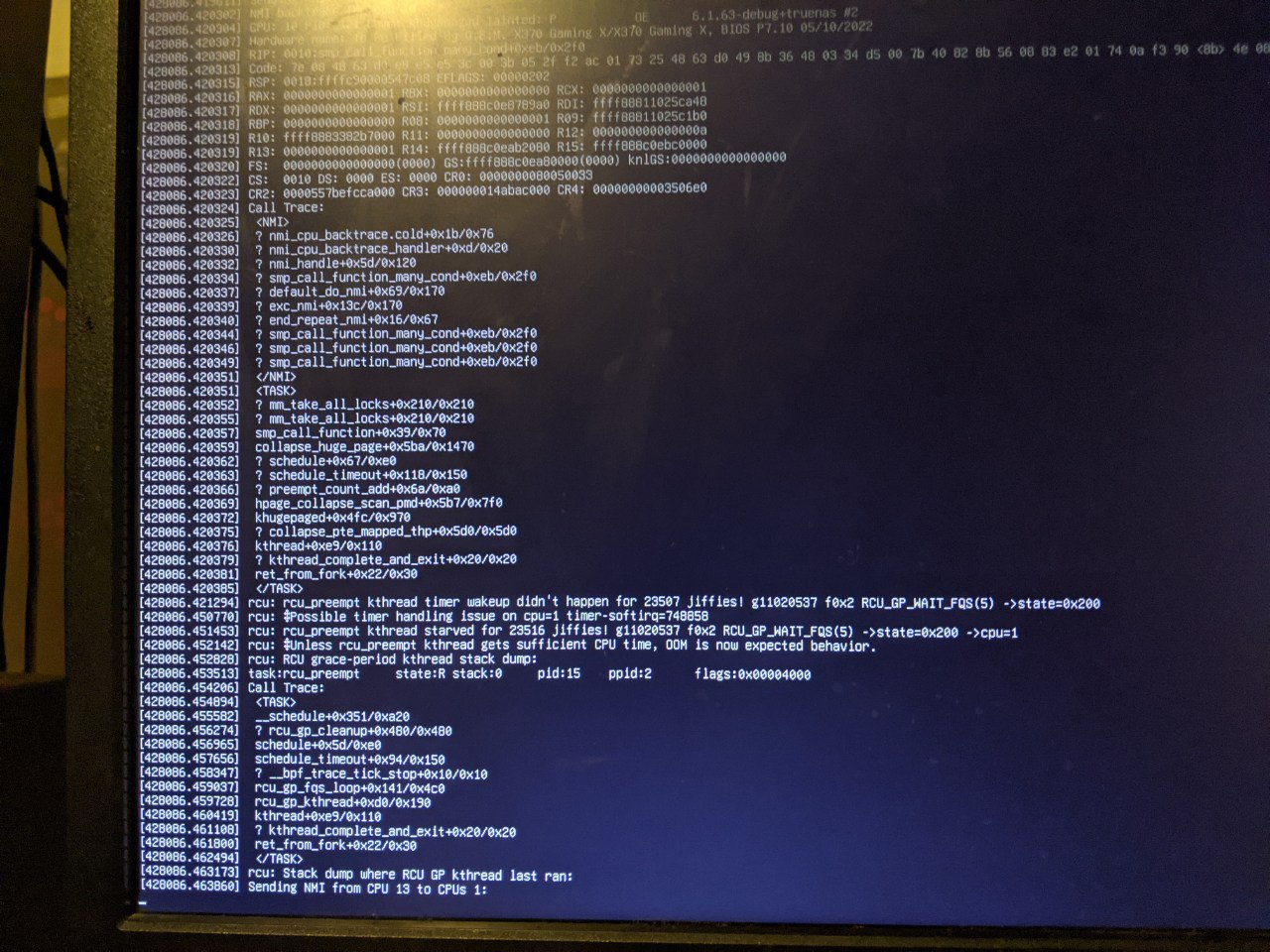

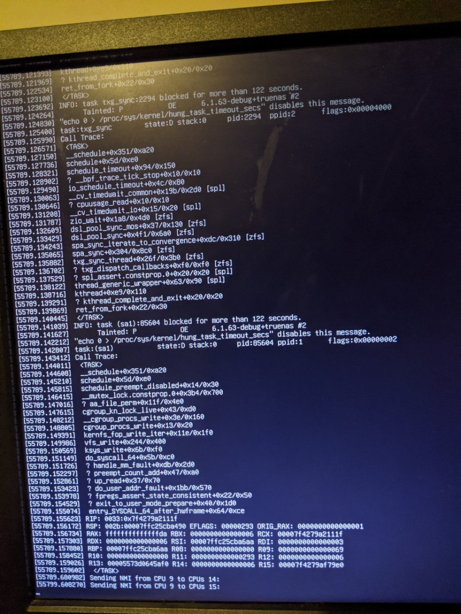

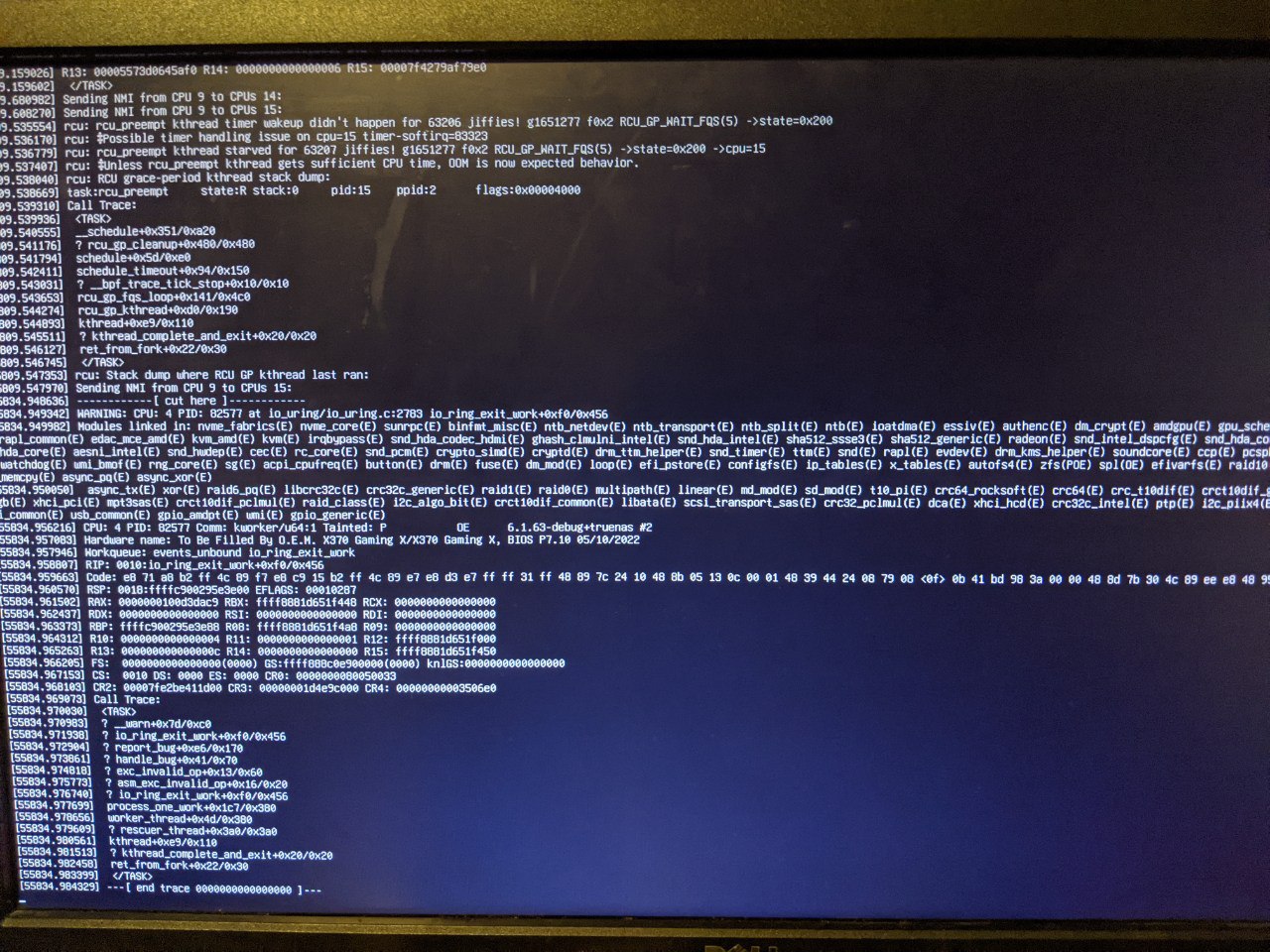

My TrueNAS scale keeps crashing (unresponsive on the network). When i look at the video output on the TrueNAS box, I either find it on the default console set up screen frozen (cursor not flashing) or with output as shown in the attached images.
This happens around once per day and i have to physically reboot it.
Can anyone offer any advice on where to start?

Have you turned off everything to do with power saving in the motherboard BIOS - this is a common issue with Ryzen boards

As far as i can tell from experience the problem is only present with 1st and 2nd gen Ryzen cpus. When i was using a 1600x and a friend of mine was using a 2700x we had the same problem. We both switched to a 3700x and i have all bios power saving settings enabled and no problems.
Seems it is a architechture problem with the first two ryzen generations.
Edit
Try disabling AMD Cool&Quit, ERP-Ready and Global C-States
These were the settings i had to disable for the 1600x to become stable and dont crash

It appears that I had to disable C-states to restore stability. Although, now my CPU consumes 15-20 more watts due to not being able to go into an idle state.
When I have time I'll look into if there's a BIOS update that may have fixed this.
