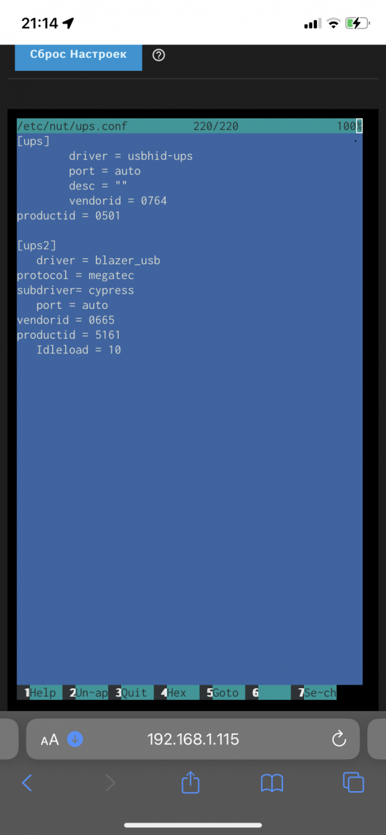

this is what I did first. such settings were on the router. and everything was stable there. and here it shows only one device (

I'm sorry, I overlooked this. When adding, I thought there would be two devices at once. devices are added to homeassistant individually. topic can be closed)
