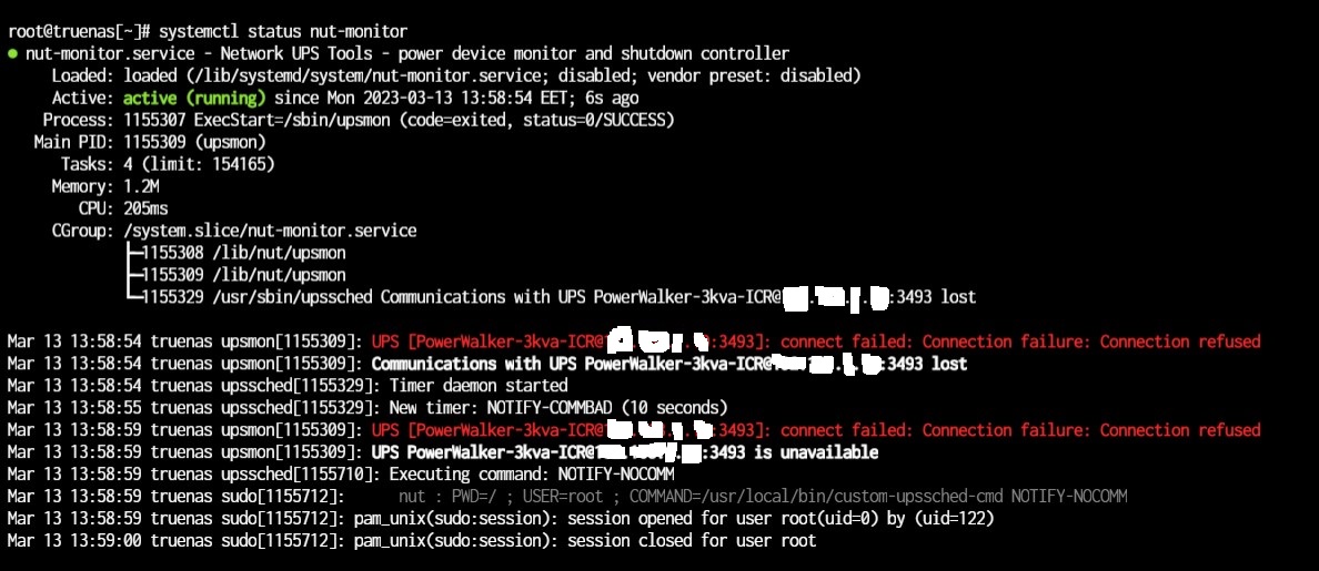

Below is the message that I am getting, running on Shell systemctl status nut-monitor
Am I supposed to create the upsuser on Turenas as well or just use his credentials inside the ups service options ? If yes with what credentials?
Any thoughts of something that I ve missed or didn t configure / check?
