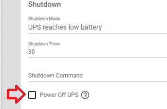

There's no need to manually edit upsmon.conf. There's a convenient check box in the UPS service for this:
Just navigate to Services->UPS, and click the pencil icon to edit the NUT configuration.

Hi Samuel, thanks for the reply. In my initial post, I indicate that changing this setting does not fix the issue. No matter whether it's checked or not, the UPS gets powered down:
If the "Power Off UPS" setting is On, this line changes to /etc/killpower, and for off it's /etc/nokillpower. However, it doesn't seem to matter. Simply the presence of POWERDOWNFLAG causes the UPS to be sent the shutdown command.
