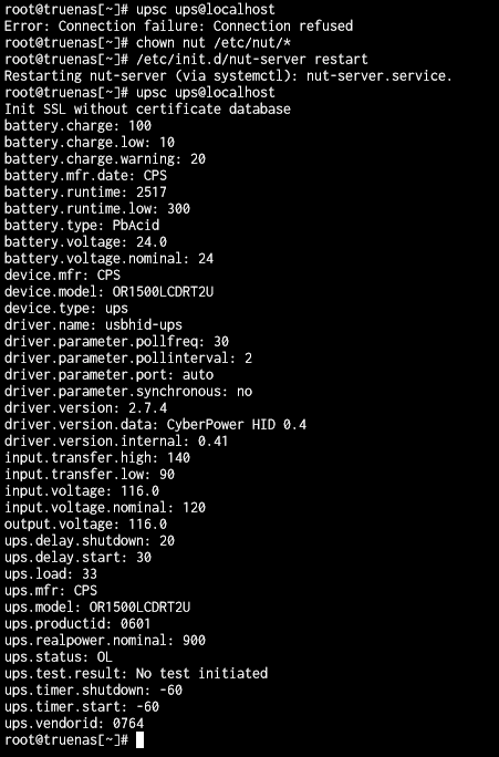

root@zion[/etc/nut]# upsc APC1500VA@192.168.69.10:3493 <--- ip of local truenas system
Error: Connection failure: Connection refused
root@zion[/etc/nut]# upsc APC1500VA@localhost
root@zion[/etc/nut]# upsc APC1500VA@127.0.0.1

The following post might help

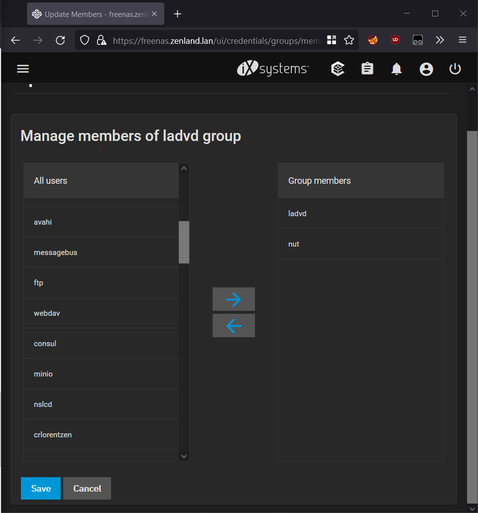

I followed @unixland suggestion by adding the 'nut' user to 'ladvd' group via Truenas gui.
Credentials->Local Groups
Search for 'ladvd' use the gear icon to enable built-in groups
Click 'ladvd' then select Members
Find 'nut' on the left side and move to the right.
This fixes it so that reboots don't require any action
