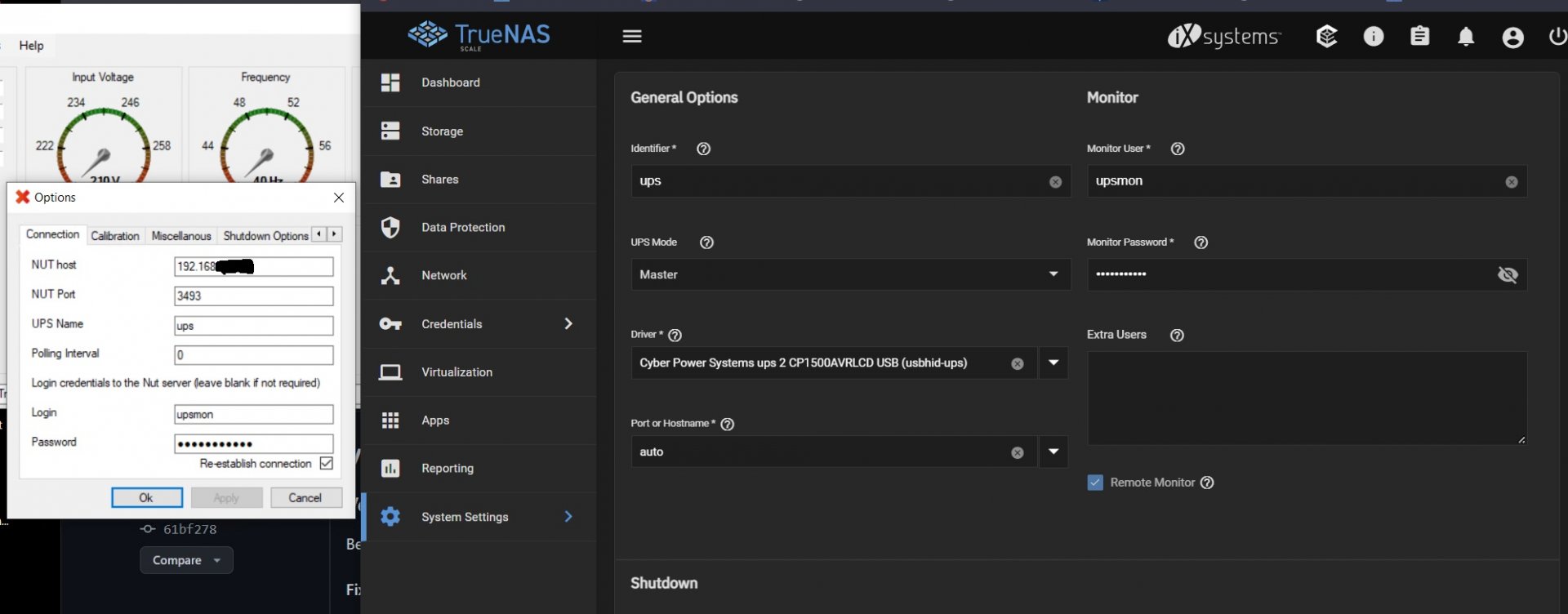

Hi, I'm a newbie to NUT.
I have the NUT/UPS service working locally on my TrueNAS-SCALE system. e.g. shell>upsc ups@localhost shows the attached UPS.
Now, I'm trying to get the WinNUT-client on a Windows10 PC to connect to the TrueNAS-SCALE system, but no luck.
On the right-side of the picture, you'll see the TrueNAS UPS configuration. The GUI sections for auxiliary parameters ups.conf & upsd.com are currently both blank.
On the left of the picture is the WinNUT configuration. I can ping the TrueNAS machine from the Windows10 PC. But WinNUT client tries to connect without any success. I have tried both <my_typed_in_password> as well as "fixmepass" (that is mentioned in the Remote Monitor ?hint).
Do I need to add "Listen" or "extra-user" parameters?
Thanks in advance for any help..

I could not get it to connect to my Cyberpower UPS on my pfSense box.
DavidYLau
Jul 30, 2022
28
I got it to work with my TrueNAS-SCALE box.
I did two steps, it's probably the second step.
Step 1: I created an *.ini file since I was wondering if the GUI was broken and then loaded it with FILE>Import.
The file contents were just equivalent to the GUI fill-in boxes:
MONITOR ups@<ip_of_my_TrueNAS_box> 1 upsmon <password> slave
(I doubt this made any difference. )
Step 2: I changed the polling interval from "0" (default) to 5.
I was reading a github thread with the author of the app and he suggested this to somebody trying to communicate with a Synology box as master. I'm guessing it's this polling interval change that made it work.
Thanks for mentioning this! I was having trouble getting this working and it seemed like I had everything configured correctly. After changing the polling interval from 0 to 5 in WinNUT-client, it started working :smile:
