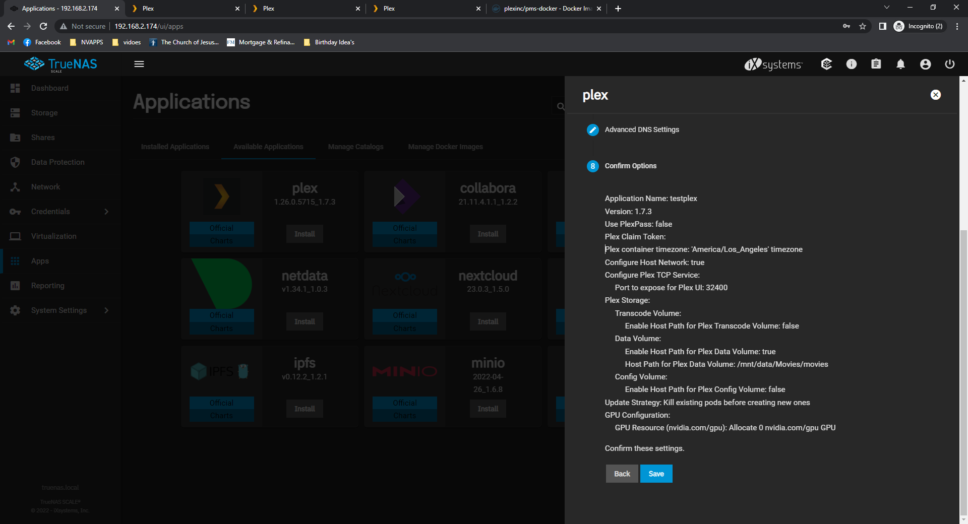

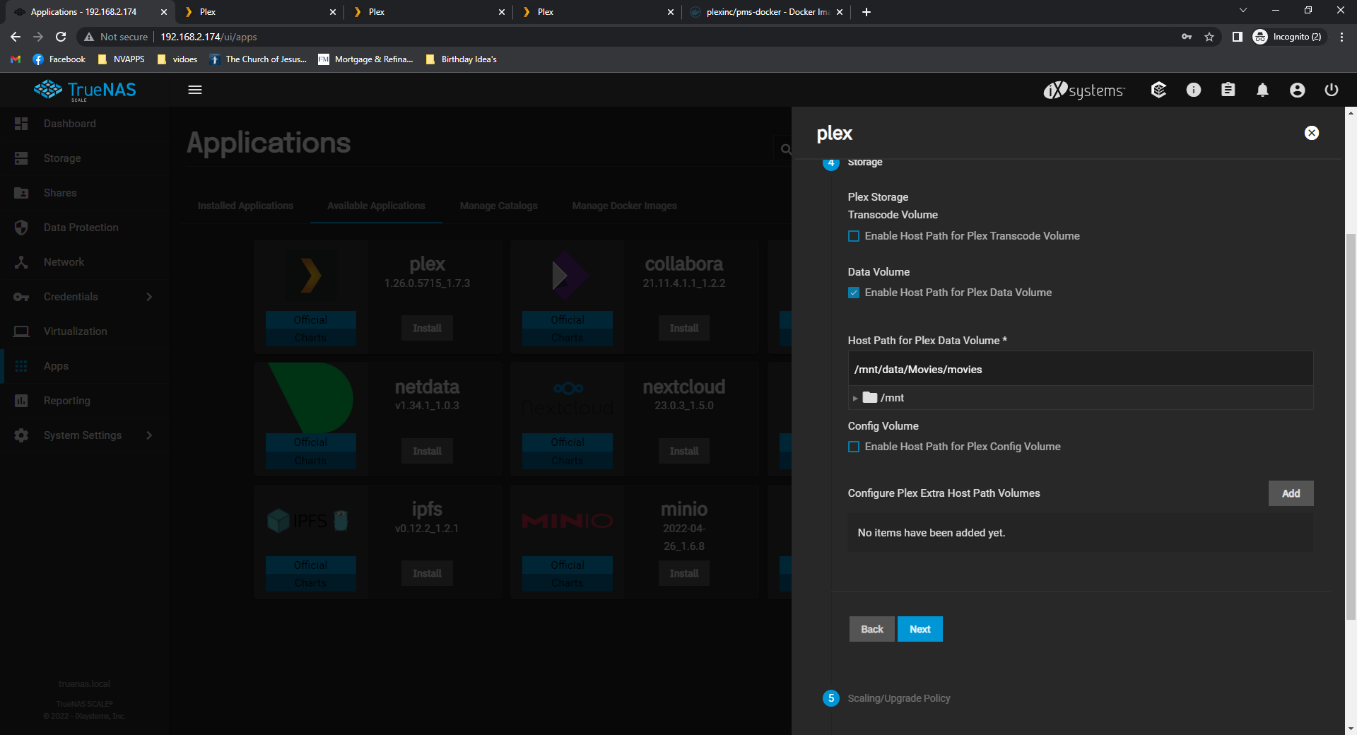

from my experience it is a permission issue as you see the ACL you have passed on directory you must all so pass an PUID AND A GUID in extra parameters do this first before you go hunting down any ACL issue create a new Data set at the root of the pool with no acls dont create any shares to that folder add that new folder to the server and try again you will manually have to add a few videos if the show up you know you have an ACL issue and you just need for correct the permissions you have associated with that folder.
I have been testing the plex app sense pre-alpha I was Critical contributor to the to the code that allowed GPU Transcoding to work in the docker/K3S there were some undocumented MOD probe commands that need to be passed to allow Docker and the K3s apps to pass through GPU resources
Let me get back to topic at hand if you set up GUID AND PUID you can assign your ACLS to those ID's otherwise it would not work all you need for access is Read options you will need excuite for transcoding and Write permission all this can be done easily.
Saberwolf
Feb 7, 2021
63
as to the original topic of the post

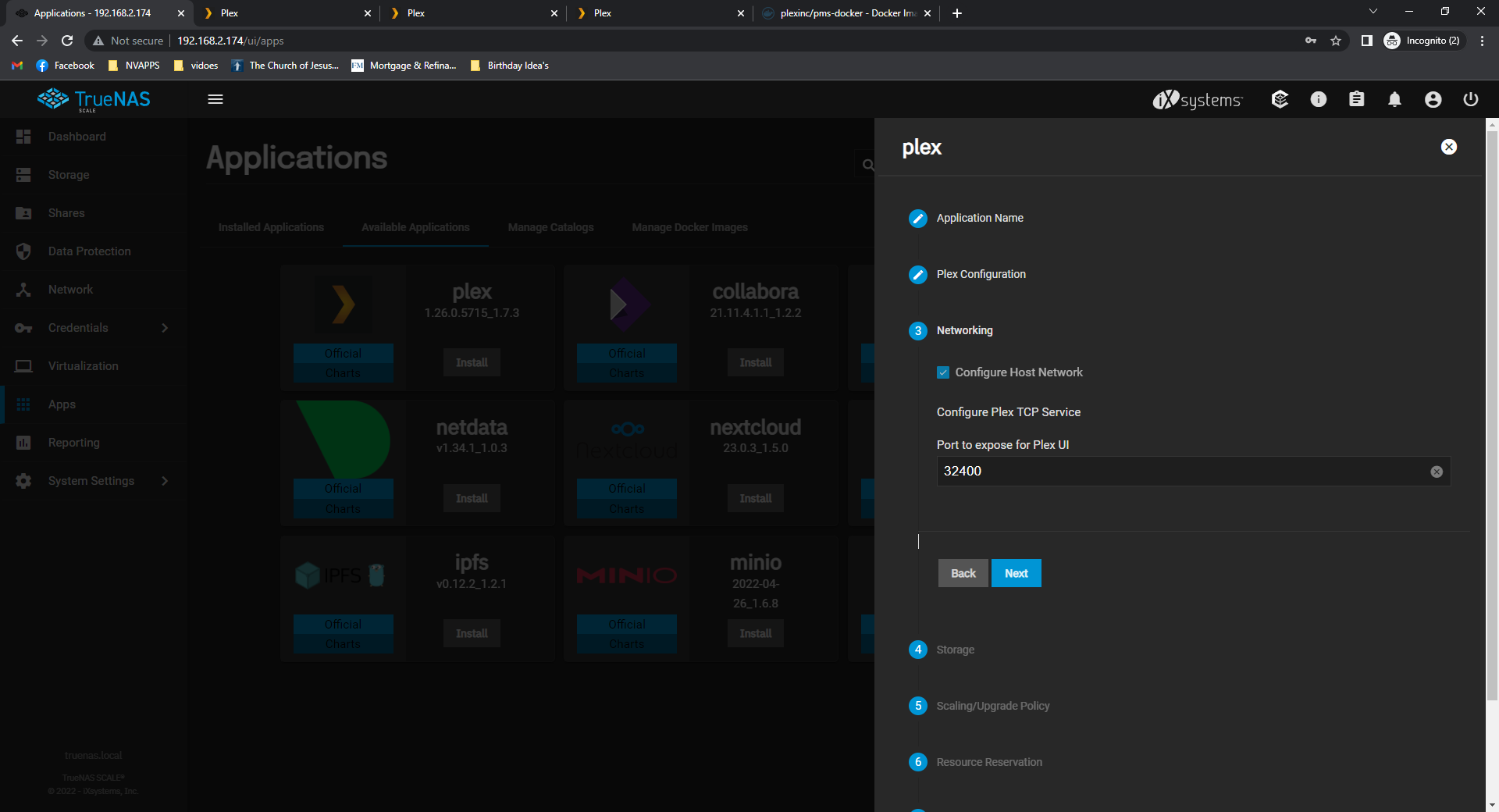

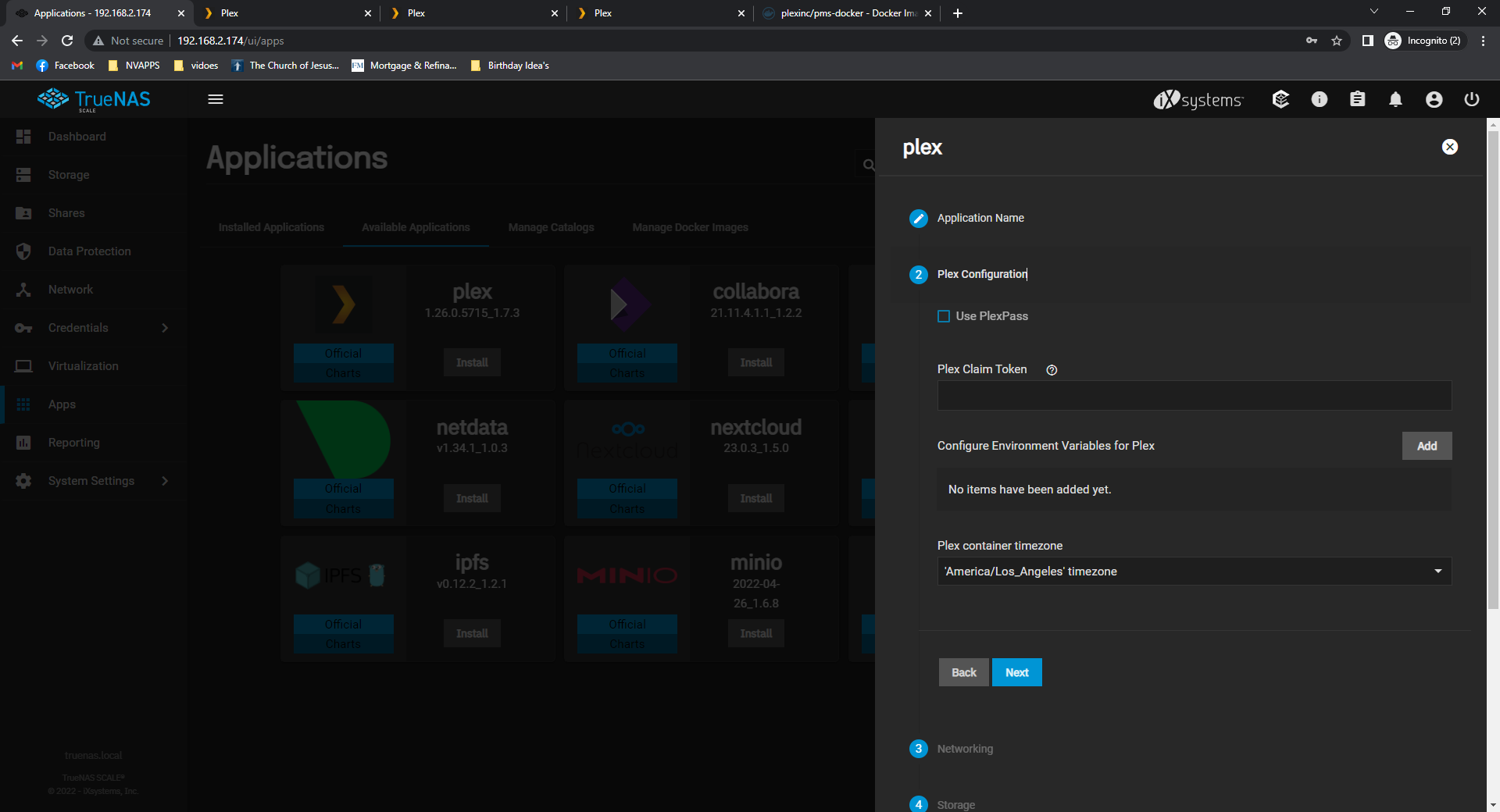

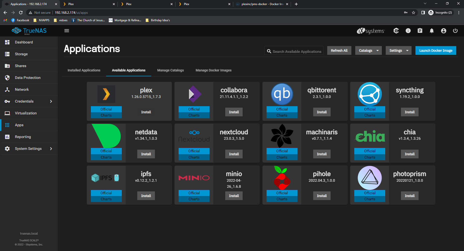

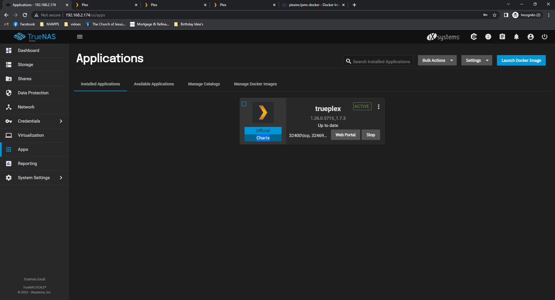

How to install Plex app I can help click install
Name your app all lower case and number no spaces
select if you want PlexPass enabled it does not really matter
enter Claim token from the fallowing website www.plex.tv/claim
add Environment variables for plex Ex. PUID GUID you can find the full list of Parameters from here https://hub.docker.com/r/plexinc/pms-docker/
dont forget the most important one if you are Trying to claim an account witch is ALLOWED_NETWORKS other wise you will get unauthorized access to your server
ensure you have Configure host network checked
set your data volume (NOTE: you will find your share under /data of server when you are trying to add movies to your library)
Set your Upgrade Policy

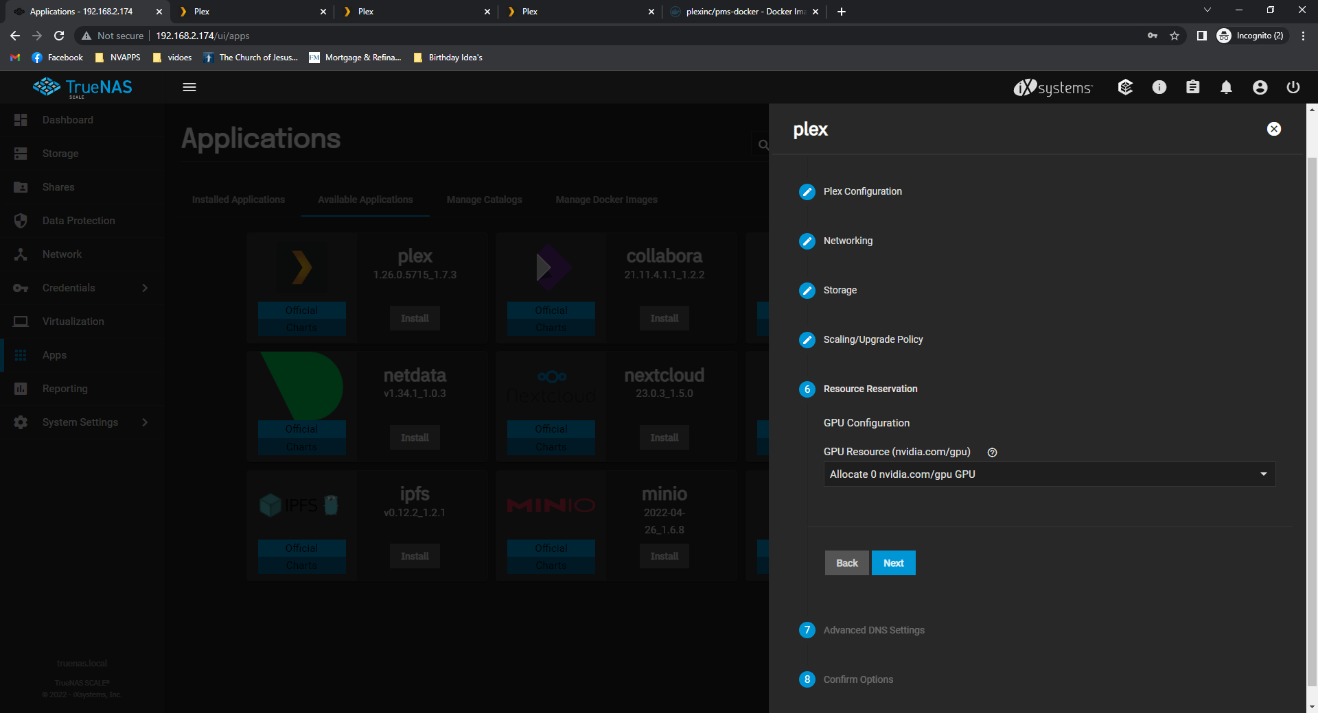

if you intend on passing a GPU through (NOTE: IF YOU DONT HAVE A VISABLE GPU ON A FRESS INSTALL JUST CONTINUE ON and EDIT Config of app after the first deployment)
Confirm your options and save

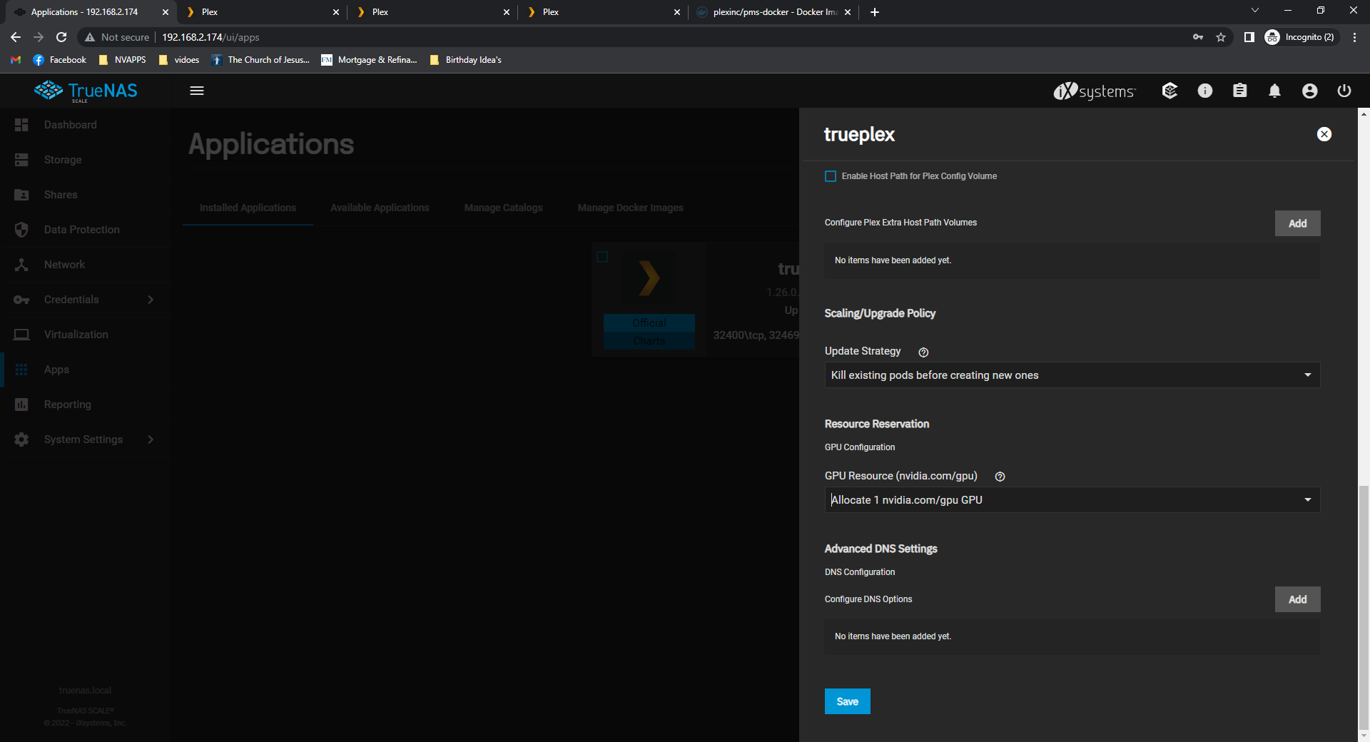

go back to installed applications At this point you will need to check config for GPU passthrough and set it to 1 instead of 0 Click three DOTS and select EDIT scroll to the bottom and look for GPU resource

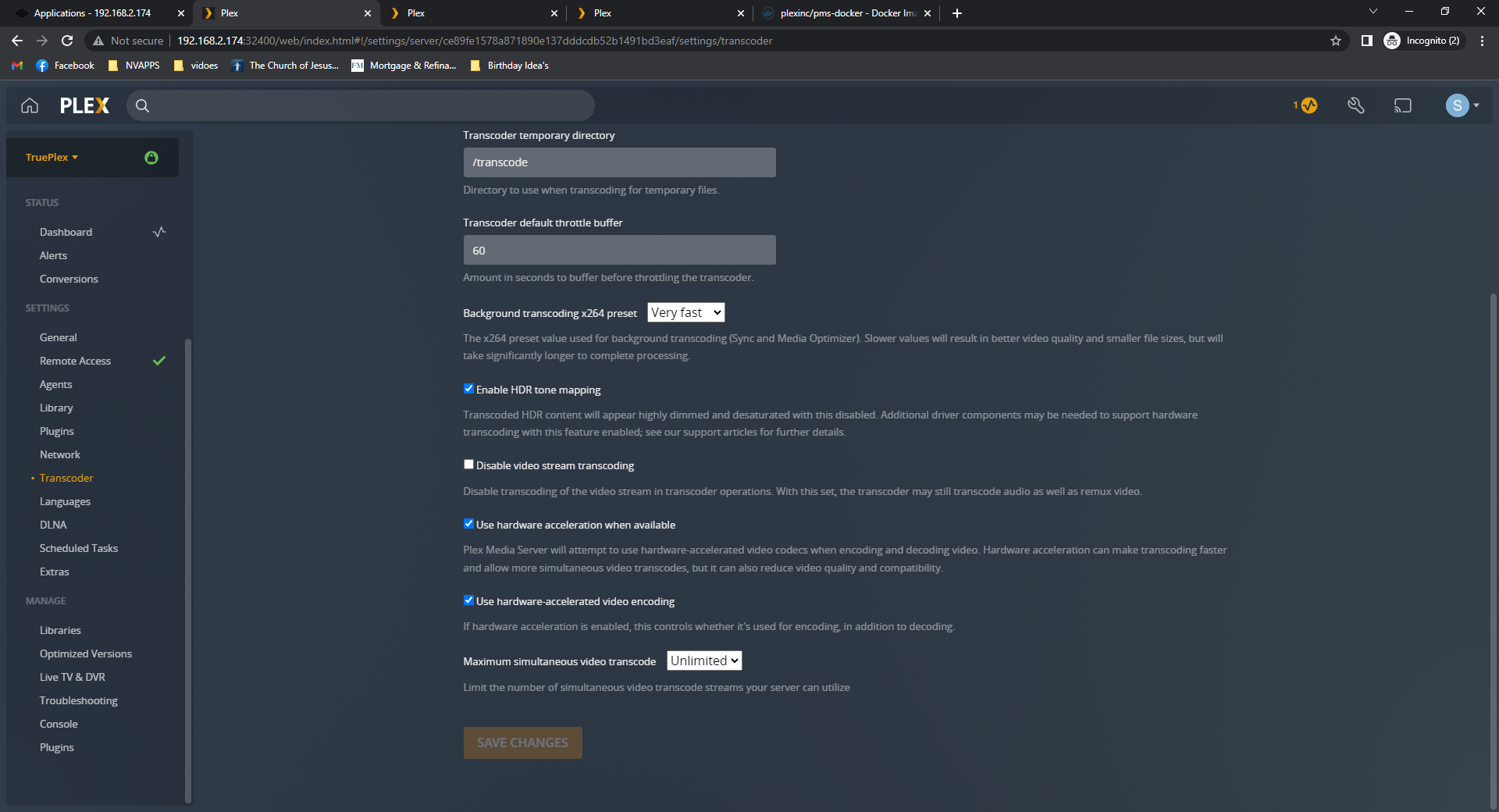

some things to you might notice will be where it says Nvidia.com/gpu might say intel.com/gpu and amd.com/gpu just ensure that the drop down button says Allocate 1 this will enable gpu support you must click save if you click out side of window where you see applications settings will not have saved if every thing was done wright and you click web portal you will be at the initial setup page for plex. the rest is self explainator oh dont for get to sing into your account and go to settings select transcoder and enable USE HARDWARE ACCELERATION WHEN AVAILBE and click save. this setting is for PLEXPASS USERS ONLY
after all that add your library of movies/tv shows/live tv tuners and your off to the market.
