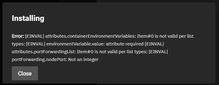

Well the wizard asks a lot of things that I'm not sure of. So I ended up getting this.
Not even sure where I screwed up. Do I have to add a place for it to go or will it be put with the other apps?

looks likes like something is wrong with your Env Variables and didn't put in the nodeport, with out knowing what you put in for each field not sure where you went wrong.

Just made those changes and got this
Error: [EINVAL] attributes.portForwardingList: Item#0 is not valid per list types: [EINVAL] portForwarding.nodePort: Not an integer
Did you actually read the error? ;-)
It literally says you need to add a nodePort.

I did some reading and sounds like I set the port to container port to 6077 and I can set the node port to 9001 and I just search that port to connect to it. Its loading now so fingers crossed. Now I just have to edit that config.ini file to start my test.
