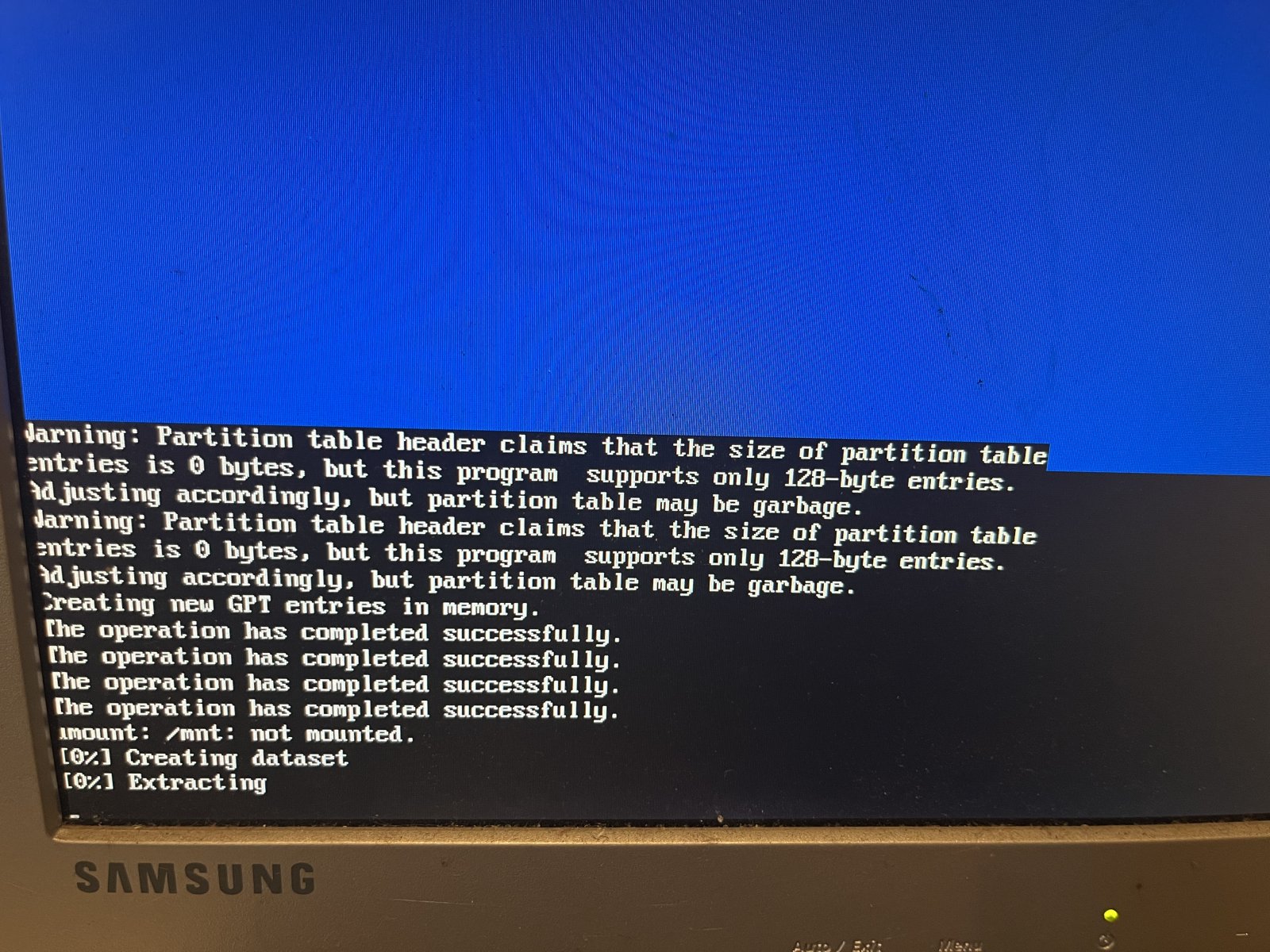

I’m assuming this error message might be important…

Solved
I removed all logical drives and erased with the HP tool, recreated them, reinstalled it, system boots on it no hassle at all.
I have no idea why, or how.
So now Scale is running from 2 hw mirrored 120gb ssd’s.
