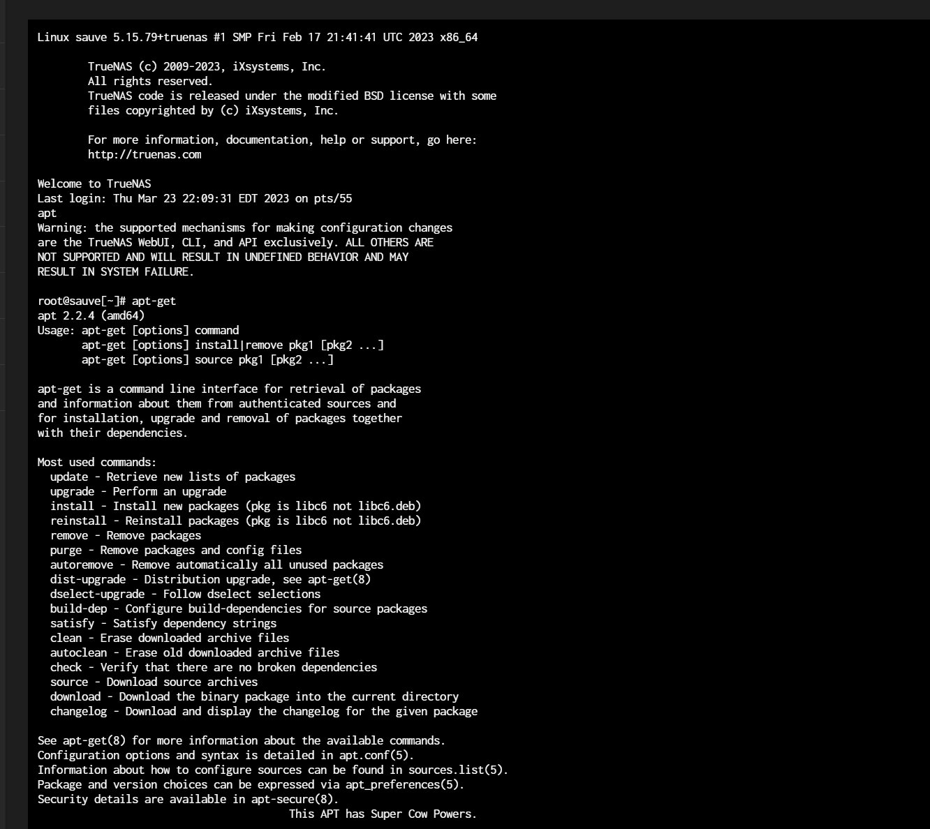

DaSnipe
Jun 26, 2021
86
no apt* has been removed from system to keep issues down. so at this point it is not supported way of adding apps just download the DEB package that is compiled and not source. then use dkpg to install hope this helps.
It's still there, just needs to be enabled ;-)
