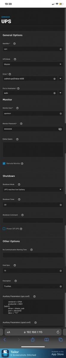

Hello everyone, I've run into a problem with connecting the UPS. there are 2 identical ups, they don't have serial numbers, vendorid and productid respectively are the same... how do i know which usb bus one and the other is sitting on? so that nut could distinguish them at least like this ... thanks in advance for the answer :)

I'm not sure what photo you would like, well, for example, here ...) 2 ups are connected here so far. I don’t prescribe the 3rd one yet, because when I do it, the system catches the first one that comes across, and the second identical one simply ignores

I will try to describe ..) there are 3 UPSs that are connected to the truenas scale via usb, then each of them is monitored in the home assistant. 1 UPS feeds the truenas server 2nd router and every little thing and the 3rd - TV. 2 UPSs are absolutely identical, and it is not possible to distinguish them by vendorid / productid as well as by serial number. but, as far as I know, besides this, in nut you can specify which usb bus the device is connected to, so I want to try at least in this way to force the system to somehow distinguish the UPS from each other
