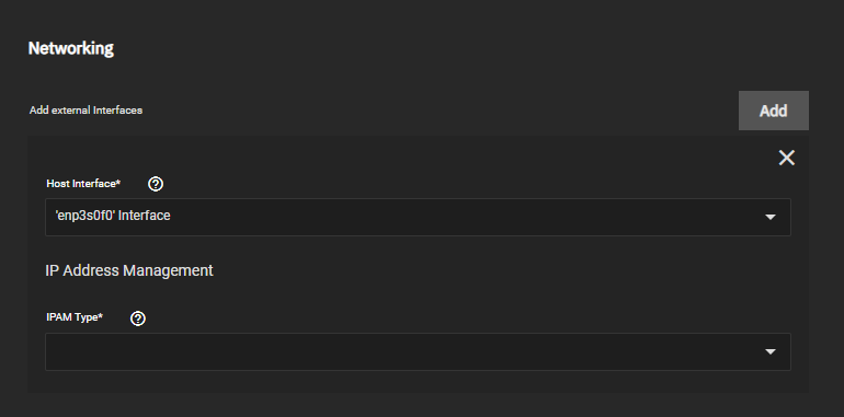

Confirmed its in Angelfish as well currently, you'd see it if you click Edit on an App.

On my system, after installing an app. Go to the three dot menu, and select Edit on the app. Scroll down until you see the network section, where you can click "Add" to attach external interfaces.

Doesn't exist - this was an ix app rather than truecharts
9,703
The advice is that it's for Launch Docker Image apps, not necessarily others.

For MetalLB, our adviced solution, it's in the new WIP enterprise train and is mostly finished by now. (mostly extra tests, metrics and docs needed)
The Direct External Interface attachment, is available under "Show Expert Config".
However: You're bypassing the complete kubernetes stack and it still does not guarantee that outgoing traffic is going via said adapter. So we would *highly* advice using metallb instead.
