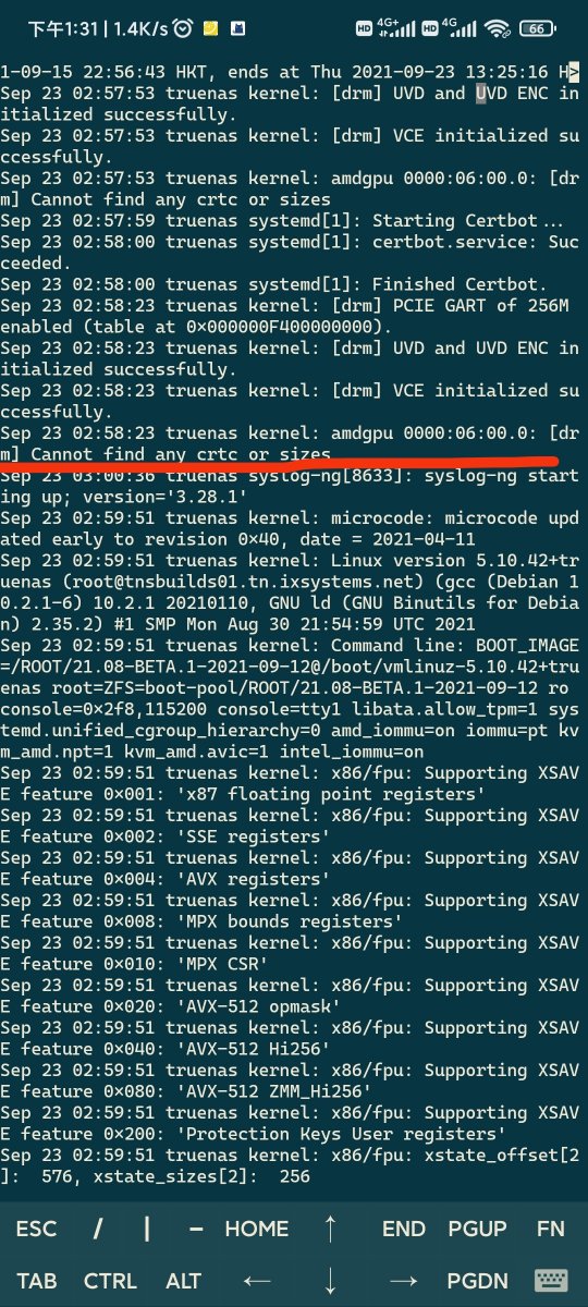

ep 23 02:57:23 truenas kernel: amdgpu 0000:06:00.0: [drm] Cannot find any crtc or sizes Sep 23 02:57:41 truenas env[41452]: E0923 02:57:41.486800 41452 network_services_controller.go:151] Failed to replace route to service VIP 192.168.0.20 configured on kube-dummy-if. Error: exit status 2, Output: RTNETLINK answers: File exists Sep 23 02:57:41 truenas env[41452]: E0923 02:57:41.488009 41452 network_services_controller.go:151] Failed to
replace route to service VIP 192.168.0.20 configured on kube-dummy-if. Error: exit status 2, Output: RTNETLINK answers: File exists Sep 23 02:57:41 truenas env[41452]: E0923 02:57:41.488997 41452 network_services_controller.go:151] Failed to replace route to service VIP 192.168.0.20 configured on kube-dummy-if. Error: exit status 2, Output: RTNETLINK answers: File exists Sep 23 02:57:53 truenas kernel: [drm] PCIE GART of 256M enabled (table at 0x000000F400000000). Sep 23 02:57:53 truenas kernel: [drm] UVD and UVD ENC initialized successfully. Sep 23 02:57:53 truenas kernel: [drm] VCE initialized successfully. Sep 23 02:57:53 truenas kernel: amdgpu 0000:06:00.0: [drm] Cannot find any crtc or sizes
Sep 23 02:57:59 truenas systemd[1]: Starting Certbot... Sep 23 02:58:00 truenas systemd[1]: certbot.service: Succeeded. Sep 23 02:58:00 truenas systemd[1]: Finished Certbot.
Sep 23 02:58:23 truenas kernel: [drm] PCIE GART of 256M enabled (table at 0x000000F400000000).
Sep 23 02:58:23 truenas kernel: [drm] UVD and UVD ENC initialized successfully.
Sep 23 02:58:23 truenas kernel: [drm] VCE initialized successfully. Sep 23 02:58:23 truenas kernel: amdgpu 0000:06:00.0: [drm] Cannot find any crtc or sizes
(by: jim, newly start here)
ep 23 03:00:36 truenas syslog-ng[8633]: syslog-ng starting up; version='3.28.1' Sep 23 02:59:51 truenas kernel: microcode: microcode updated early to revision 0x40, date = 2021-04-11 Sep 23 02:59:51 truenas kernel: Linux version 5.10.42+truenas (root@tnsbuilds01.tn.ixsystems.net) (gcc (Debian 10.2.1-6) 10.2.1 20210110, GNU ld (GNU Binutils for Debian) 2.35.2) #1 SMP Mon Aug 30 21:54:59 UTC 2021 Sep 23 02:59:51 truenas kernel: Command line: BOOT_IMAGE=/ROOT/21.08-BETA.1-2021-09-12@/boot/vmlinuz-....

Can you go back to 21.06... make sure its not rebooting, then upgrade again.
If the rebooting restarts, then" report a bug" seems like the right course of action.
