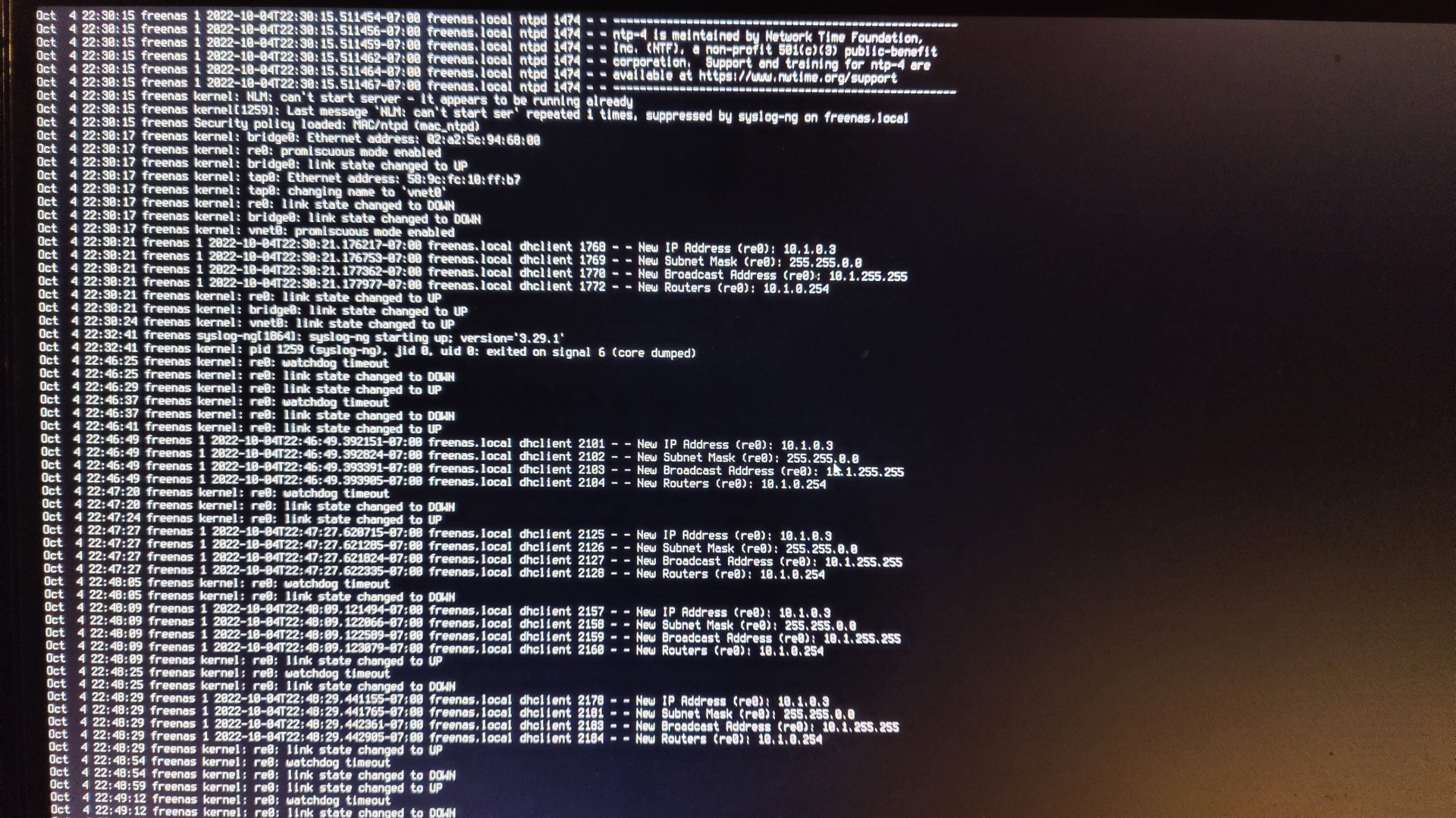

**UPDATE** Aaaand it just went offline again. When I look in the /var/log/messages file, I see a long train of watchdog timeouts followed by a link down then link up. Here's a bit earlier in the messages file:A
Any idea why this watchdog timer keeps doing things?
10.1.0.3 is the address my TrueNAS box is supposed to get from DHCP, so that's working at least.
Does anything else in that screenshot look wrong or sketchy?

There is no conflict with any other IP address. And as I said in my previous message - when I configured the network using the truenas console menu, it worked, but only for about 20 minutes, then it shut itself off, and in the logs I see those watchdog timeouts.
Why am I getting repeated watchdog timeouts? Why is it resetting itself? And also, as you can see in the screenshot, it seems to have configured the network 5 times identically back to back- why more than once?

Last update - after another reboot, it seems to have stabilized. I was getting some funky interaction between TrueNAS and my windows laptop also mounting an NFS partition, but after rebooting both my laptop and my TrueNAS box, both seem to have stabilized and it seems to be functioning properly now. I'm still getting the watchdog timeouts and the link down/ups, but that doesn't seem to be affecting the use as a file server, so I guess this issue is done.
