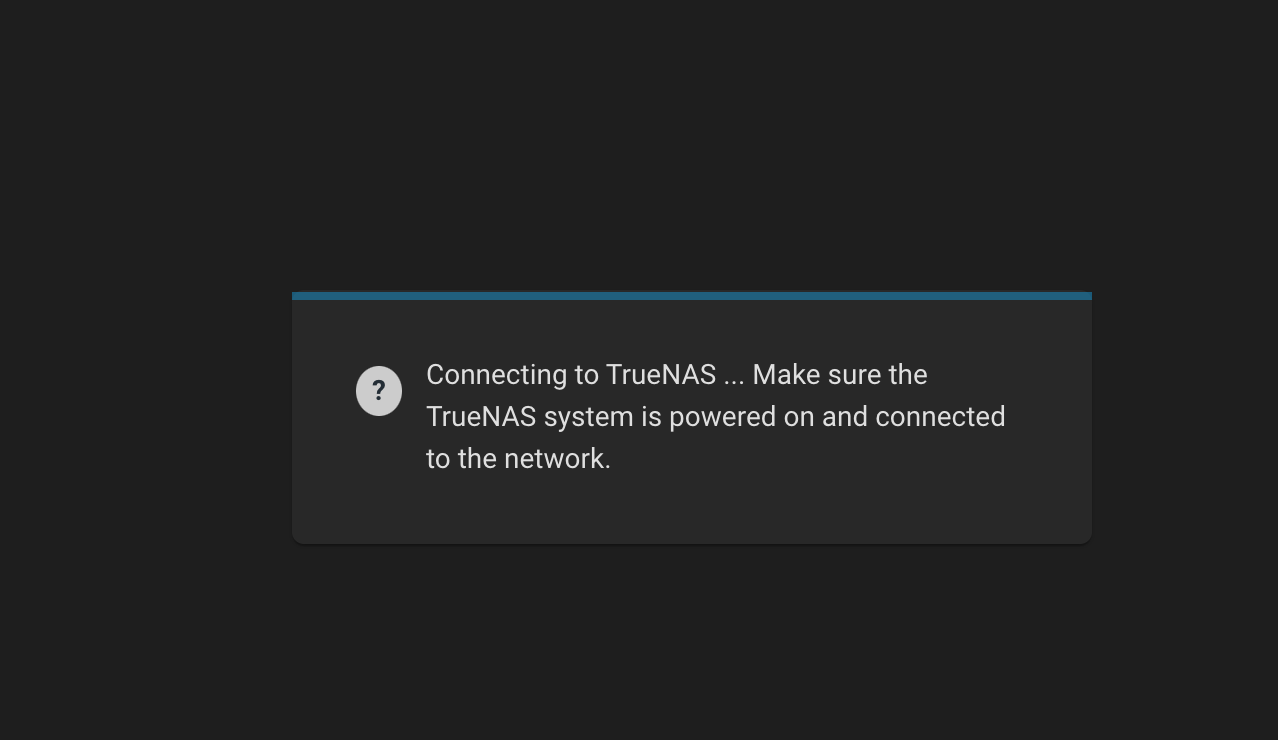

Hello all,
I have a fresh Truenas 12 install. For Jails I created a zpool from an ssd disk.
Everytime I try installing any plugin (plex, clamav, or others) during plugin installations (around 50% completetion) the web UI disconnects and I see the message in the attached picture. It comes back after a few moments, but the plugin is deleted (or probably not completed)
Any clue what may be the problem?

That looks like the middleware crashing.
Have a look at /var/log/middlewared.log and see if it's got anything useful to say.

It looks like the nas is completly loosing connections during the plugin instalation.

from the CLI same issue:
iocage fetch --plugins --name "plex"

that's wrong - DNS works and I don't get it
9,700
What's not working there is the DNS from inside the jail... you may benefit from specifying the defaultrouter and working out how you will give it connectivity (static IP or DHCP) (dhcp="on" defaultrouter="192.168.0.1" bpf="yes")
So try it like this:
iocage fetch --plugins --name "plex" dhcp="on" defaultrouter="192.168.0.1" bpf="yes"
Obviously replace that IP with the IP of your actual router.

looks like I have a network issue. weird. cz everything works perfectly and before the reinstall there ware no opnsesne changes.

9,700
What about if you try just an empty jail?
iocage create -r 12.2-RELEASE --name "plex" vnet=yes dhcp="on" defaultrouter="192.168.0.1" bpf="yes"

that worked. thanks
i will install everything as jail + manual install for services.
however, every time I restart a jail or a plugin, the UI restarts as well and I get disconnected.
