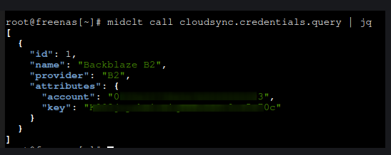

Have you created a credential with embedded spaces? That's the usual cause of SQL parse errors. What's the output of midclt call cloudsync.credentials.query | jq? (Remember to blur out credential secrets before pasting the output here.)

The service was working absolutely fine until upgrading to TrueNAS 13.
I did create a new B2 key to see if that would work, here's the output of your suggestion:
Can't see any embedded spaces.
