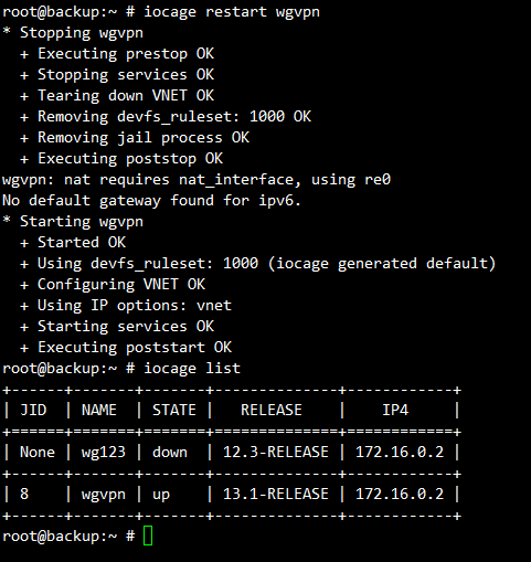

Sorry - 13.1-RC6 is the underlying OS version for TrueNAS 13-RELEASE; the problematic version for my jail was actually 13.0-RELEASE-p11.
The OS versions that work for the WireGuard jail are 12.3 and 13.1.
P.S.: I have had two or three hard reboots while restarting this jail on TN 13 [system is lightly used, and there are no other jails, VM's or plugins running] - I'll investigate this further.

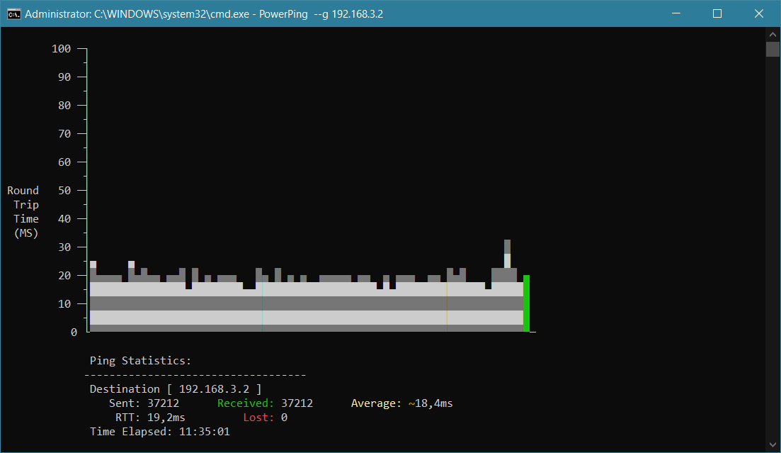

Shutting down the tunnel and reopening, via the Windows client; connectivity to the TrueNAS host itself (13.0-U1), via SSH, never goes down.
I've been running a ping test over the past 11:30 hours, to a 12.3 based jail on TrueNAS 12.0-U8, and there hasn't been a single lost packet - the WireGuard tunnel is rock-solid:

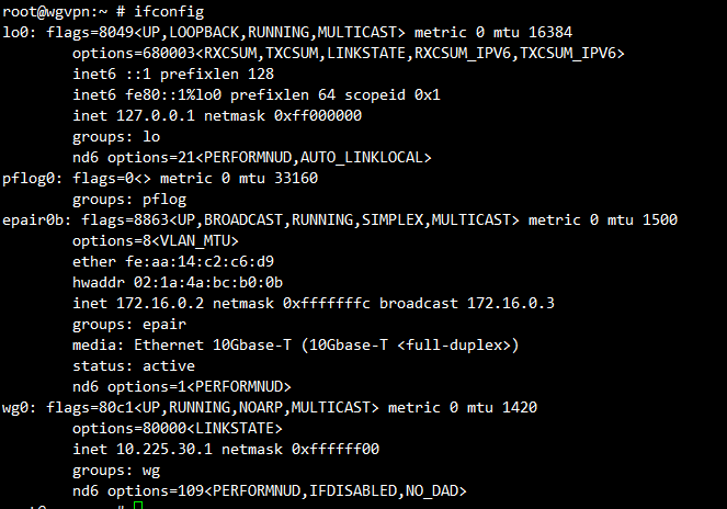

New test (host 13.0-U1, jail 13.1), connection dropped after 85 minutes; wg0 interface up and running:
Deactivating the tunnel and reactivating doesn't work; restarting the jail works, but only after a short time (1 or 2 minutes)
I'm at a complete loss, here
