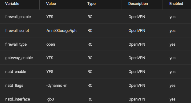

Jun 22, 2021
7
@Stane1983, did you ever get that working?
I seem to have no problem getting things to stick on boot.
Here's my config, if it may help you at all.
My ipfwrules.sh looks like this:
#!/bin/bash
ipfw -q -f flush
ipfw -q nat 1 config if igb0
# OpenVPN requires NAT
ipfw -q add nat 1 all from 10.9.8.0/24 to any out via igb0
ipfw -q add nat 1 all from any to any in via igb0
# Jails that require NAT
ipfw -q add nat 2 all from 172.16.0.0/24 to any out via igb0
ipfw -q add nat 2 all from any to any in via igb0
'System > Tunables' look like this:
I don't have a net.inet.ip.forwarding=1 SYSCTL tunable,
but sysctl net.inet.ip.forwarding returns '1' for me.

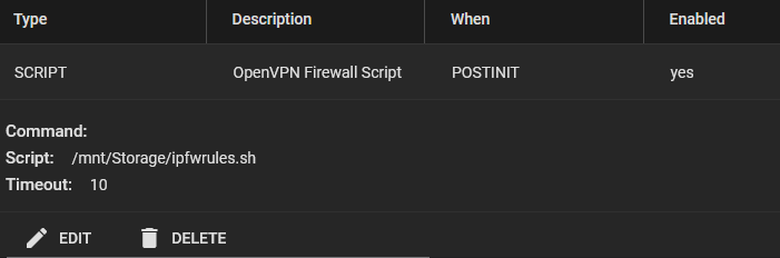

'Tasks > Init/Shutdown Scripts' looks like this:
Best of luck!
