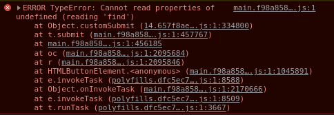

zpool replace ... but!
Never replace a failed drive in TrueNAS with a raw disk device of the new disk. You must create a partition table on the new disk (easiest way is to copy via gpart backup | gpart restore from another device) and then use /dev/gptid/<rawuuid-of-partition> as the replacement disk device.
If you are facing the situation right now, we can help you through the process.
I'm also having this same exact problem (found this thread from google :P), trying to replace a failing drive and the button isn't working, clicking it just throws an error into the browser console, I provided an image below of that error.
If you don't mind, can you guide me through the CLI to get this sorted out? I never used it before so I'm clueless on the process and the chain of commands needed to get to that point :)
