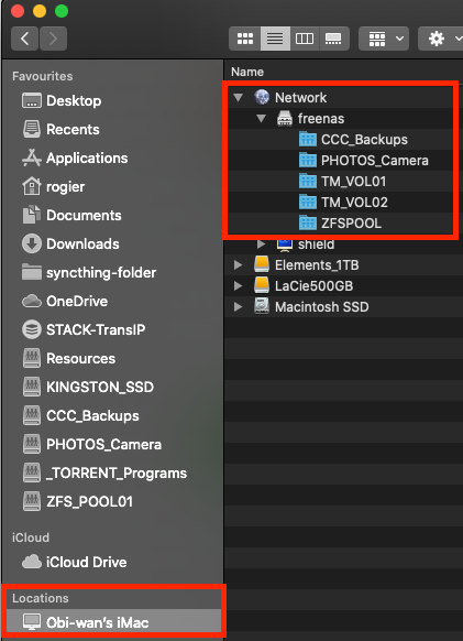

You will have to reconnect to your TrueNAS server again on your Mac.
You can check the shares and connect again via: Finder - Locations - <your-macos-hostname> - Network - <your-truenas-name>
For example on my Mac this looks like this:

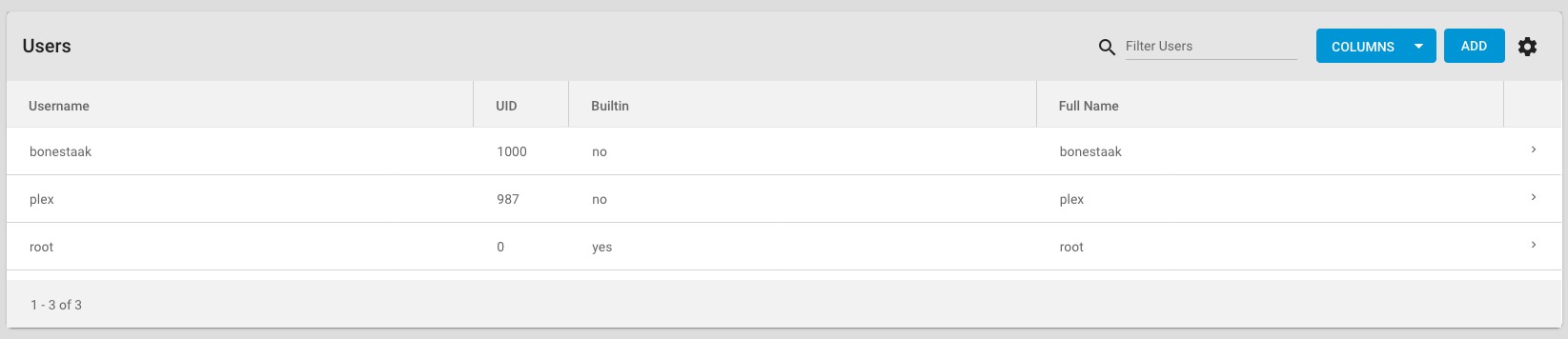

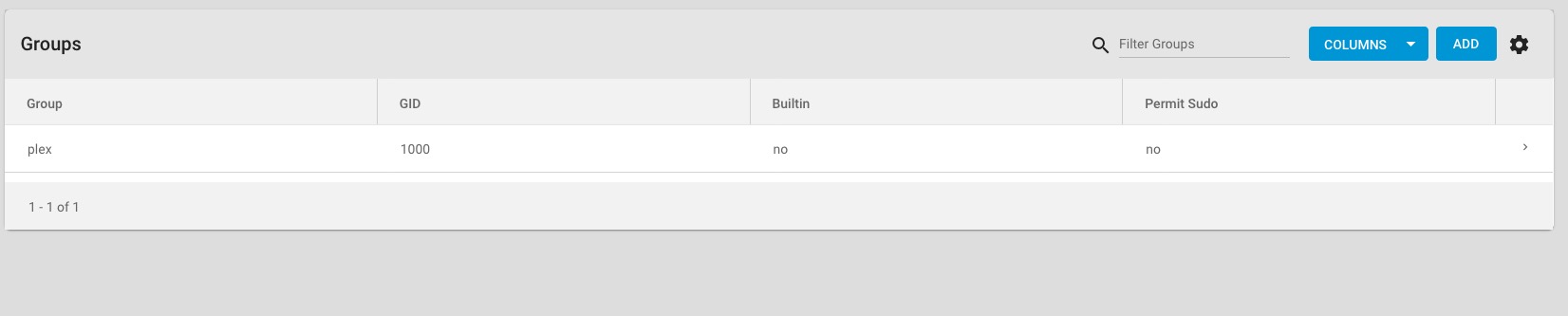

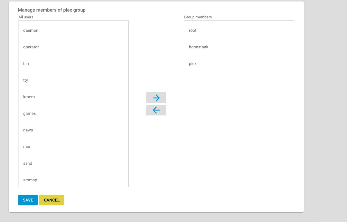

Done that, I have first install Plex (pass) when ending install, i got plex pass with some free files (usual with Plex pass) but after edit permissions i can not get my map plexmedia on Plex

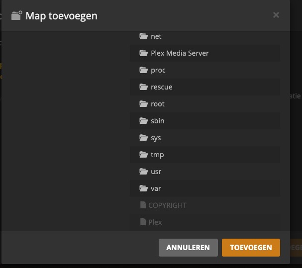

Nope, the SSD is for the camera,
But i tried mount but root is not possible and all maps after, which i choose, on plex that map is grey (unchoosable)

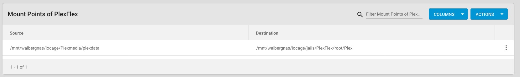

Thats correct, because you mounted it to a location within the jail itself, /mnt/walbergnas/iocage/jails/PlexFlex/root/Plex.
That doesn't work. You have to mount it to a location outside de jail.
Like i said, for example on /mnt/walbergnas/Plexdata

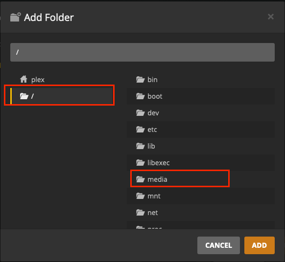

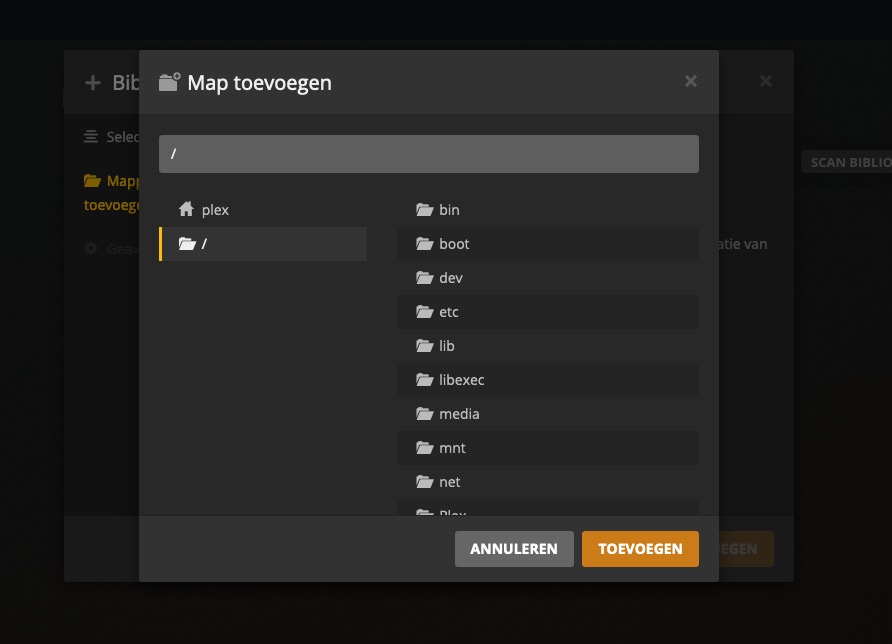

  12. go to webbrowser and log into Plex web gui
  13. add library
  14. now on the "Add folder" popup screen CLICK "/" and then CLICK the "media" folder
  15. plex-lib1-png.42616
  16. you should now see your "plexdata" folder you created earlier in step 10.
  17. when you finsh with the "add library" button (in bottom right corner) you are done.

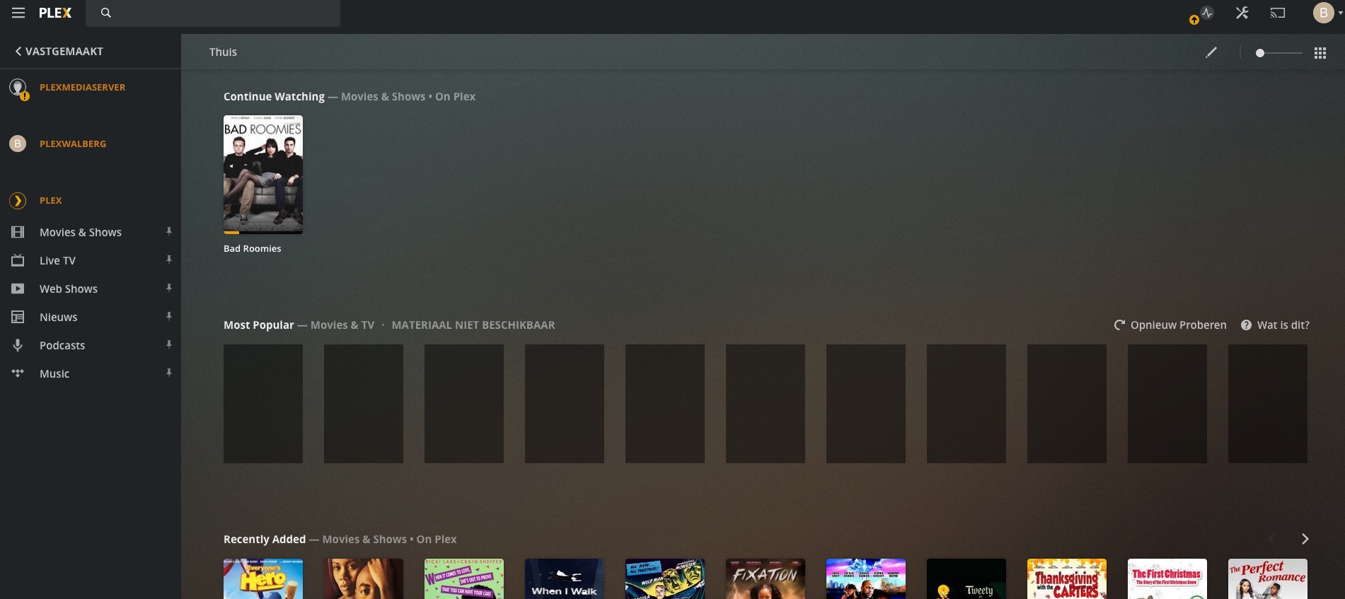

There is also a problem with Plex, i have had now about 5 servers. Sometimes i see the old one with the missing files and now i can not reach the new server.

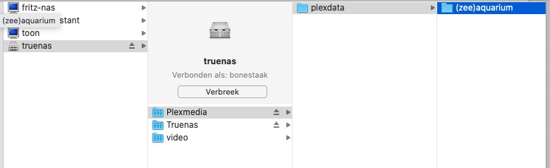

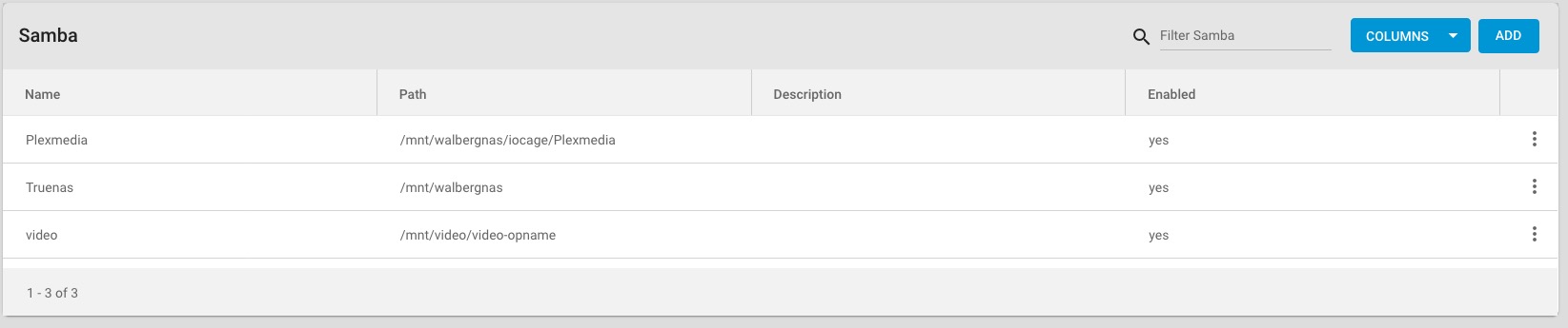

Ah, something wrong with the Sharing Now i follow your explanation and now its working (now i must add plexdata manually at destination.
See my 2 pictures, i now followed your explanation and now Plexdata (not plexdata) is under iocage So now 1 row with download, iocage and Plexdata, Now its working. I shall remove (for space and also because its not movable) iocage/Plexmedia
The 2 pictures with the old config from yesterday
You can login to https://app.plex.tv and remove those old Plex servers.
  1. Sign in on the https://app.plex.tv/ site
  2. Go to settings (click the
    icon in the top right corner)
  3. Then click on the "Authorized devices" in the left column
  4. Click on "All" and select "server"
  5. You should now see all your authorized Plex servers and can remove all but the latest one.
