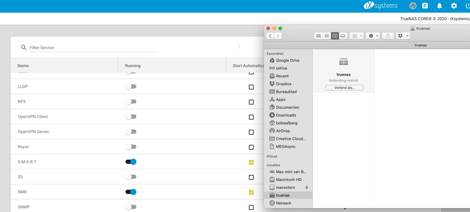

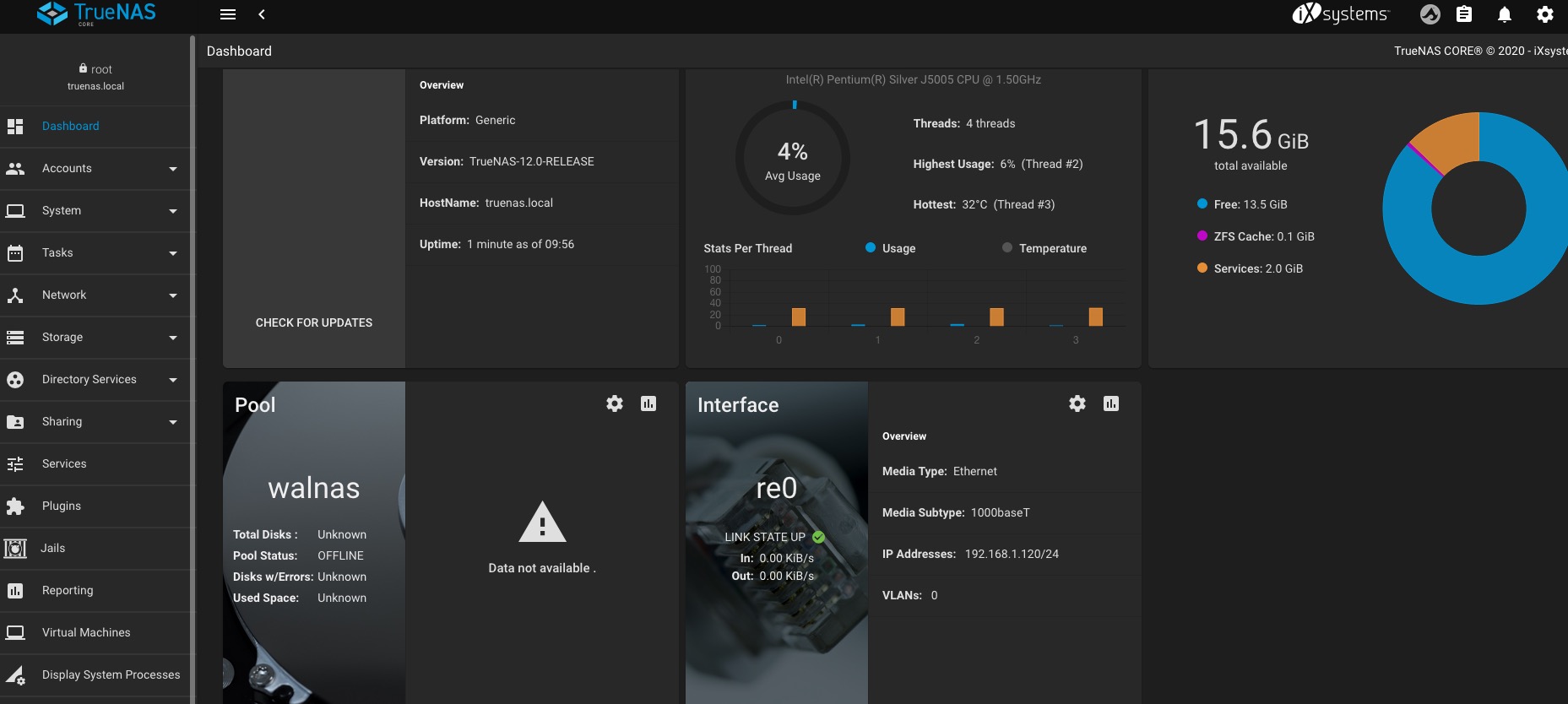

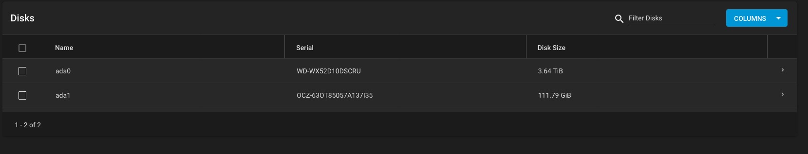

I today swapped my motherboard ssd and HD to my new server case. I got the same, on SSD is my Truenas system and on de HD my pools with data like Plex (pass) i got the same, corrected it, but the HD pool does not start. The drive is spinning and under disks i can see my harddrive but the pool is not started. What went wrong? I corrected netbios-ns

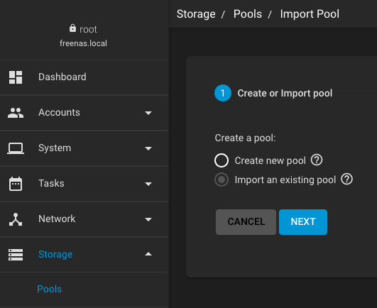

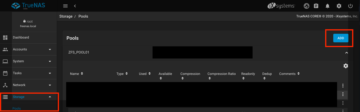

@bonestaak It looks like your ZFS pool is not imported.
You could try to import it via menu: Storage -> Pools -> ADD
And then: Import an existing pool

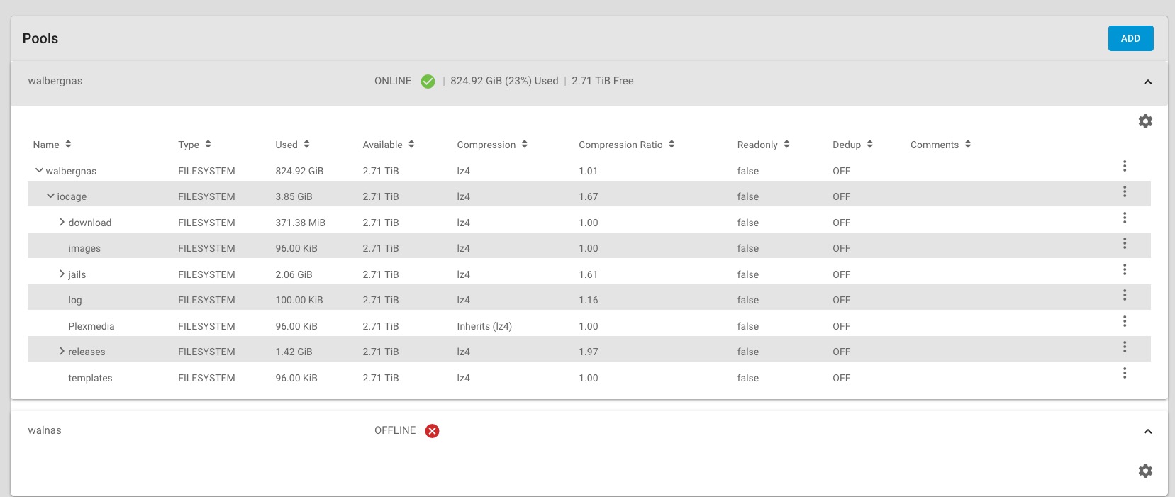

Yes i can see now a part of it, but below, there is still a problem walnas offline, when i go to my Mac and go to smb i cannot connect either and i can not connect to Plex.

Have you renamed your pool?
Or to you have 2 pools? (walbergnas and walnas)
I think your original name was walbergnas(?)
You can delete the walnas pool and use the walbergnas as default.
Then you can check you shares if they still exist (which it should if you export and import your settings)

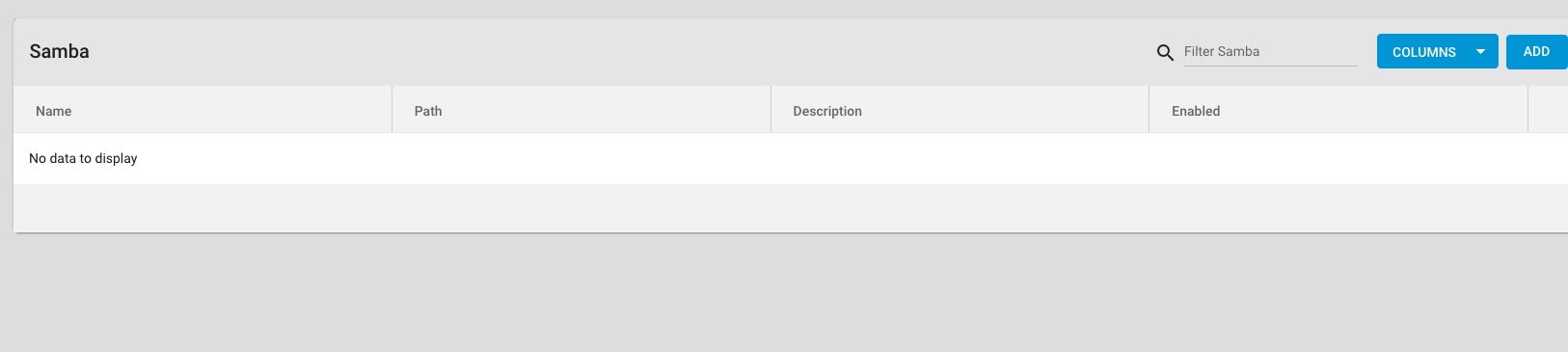

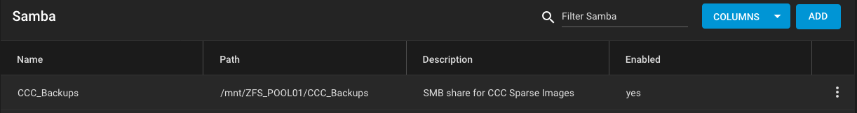

Check your shares via the menu: Sharing -> Windows Shares (SMB)
You should see your shares there, for example on my server:
In your case the "Path" should display something like:
/mnt/walbergnas/Plexmedia
bonestaak
Aug 16, 2020
72
Aha, it has lost. Why? hmm, is there a possibility on Truenas to save whole config (now i must strugle to make a new share pff).

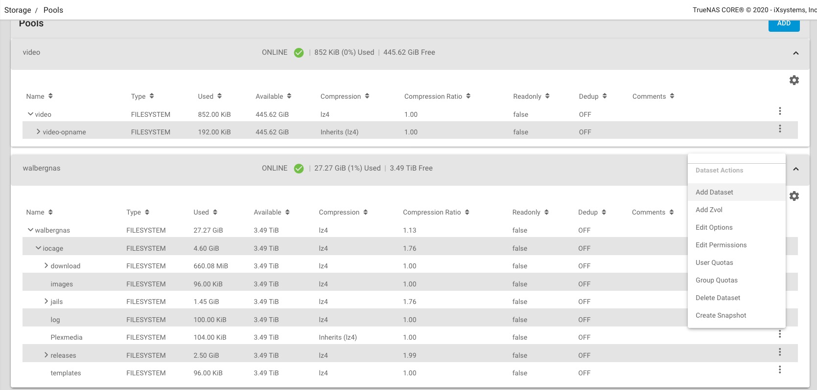

It works for 1 day, now i tried to install another plugin and now my Freenas is not visible anymore from the finder, no SMB one thing that has changed is that i have deleted mount point as a had all my plex media files 2 times? 1 path where i have had placed the media the first time and of course the path under the jail. Is there somewhere a real guide for installing Plex, and Motioneye under Truenas (Truenas is different from the samples on youtube from Freenas.
bonestaak
Aug 16, 2020
72
Setting up again with Youtube from Laurence Systems. I do not get Edit ACL when clicking on the 3 dots. See my map plexmedia
Hendrixx
Jul 6, 2020
32
You can click the "Edit permissions" option this will take you to the ACL permissions.
