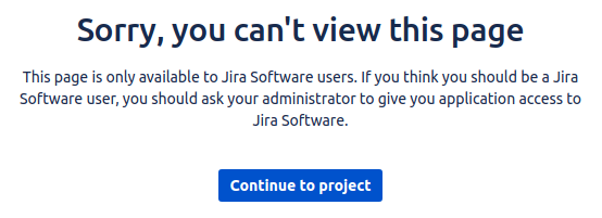

Why are only Jira Software users allowed to view the full changelog of bugfixes with each release?
I went to read the changelog for 12.0-U5, and was met with this:
Apparently, having a Jira account to report bugs is not enough?

I read the U5 release notes no problemo. Maybe they were fixed between 8/4 and 8/13 though.
