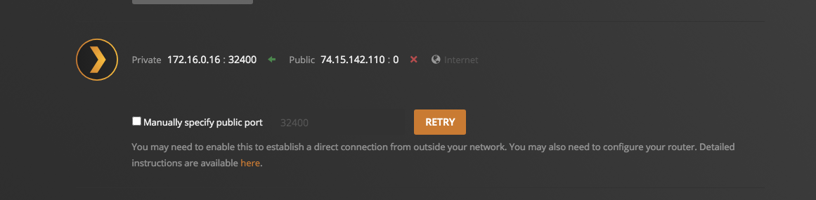

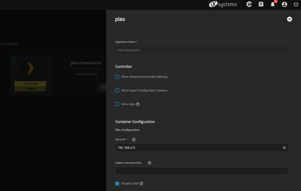

this was the case with 'officiel' Plex package from iXsystems.
things seem to be a bit different with TruCharts package. see attached.

the private ip of plex (192.168.2.5) is showed as 192.168.2.15 and is increasing by 1 at every reboot... .15, .16, .17...
this cause problem in my firewall as i need to forward traffic from port 34200 to the internal ip address.

I'm using the TrueCharts Plex, and didn't specify (and didn't need to specify) a server IP--it's accessible via the IP of your TrueNAS box at port 32400. But the primary support channel for TrueCharts is their Discord server, not here.
