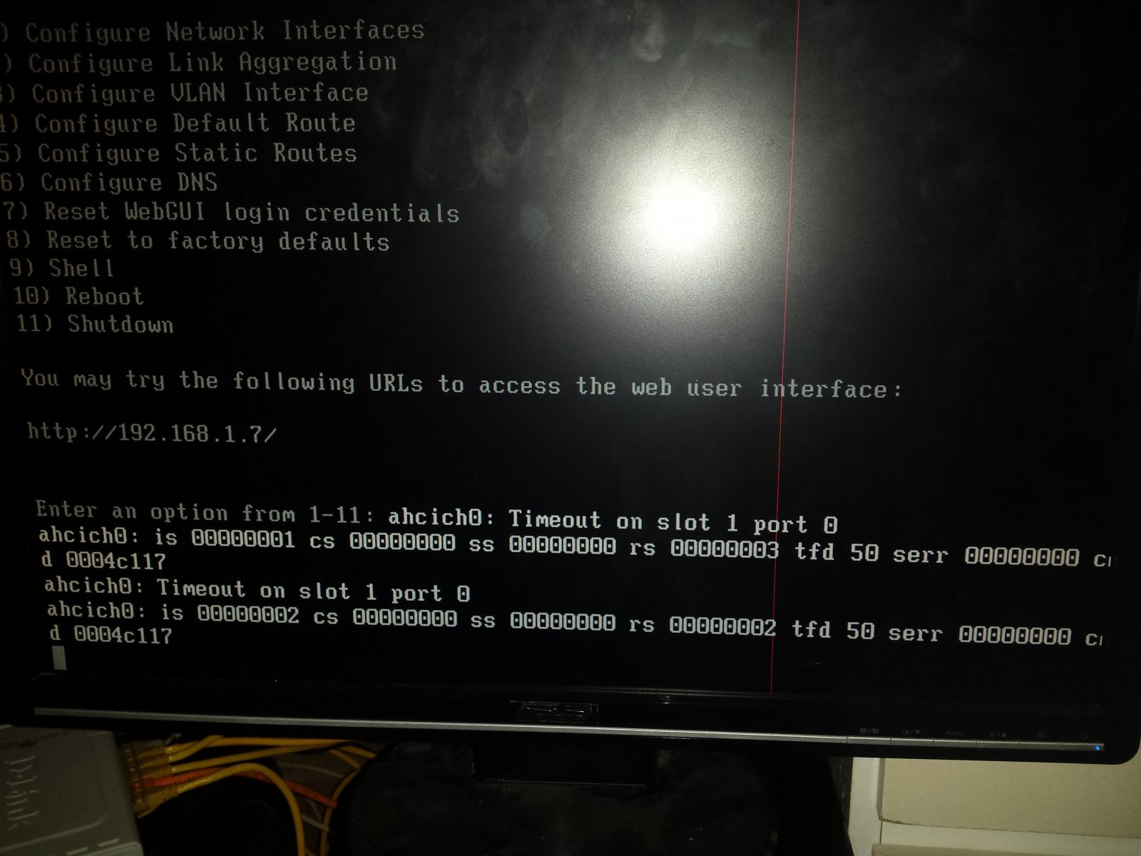

Ok I've got a freenas system set up at the moment.
I'm running Freenas FreeNAS-8.3.1-RELEASE-p2-x64 on a Intel E6400 CPU with an old Asus P5VDC-MX motherboard. I've got 2GB DDR2 ram installed. As well as 1.5TB WD Green and a 2TB WD Red. Both on the UFS format. My Boot drive is an old 80GB WD.
Now this is my problem I have gone through 3 gigabit network card. The first two included the Realtech RT8169SC chipset on them and the current one that is installed is a Intel PRO/1000 MT with the 82540EM chipset.

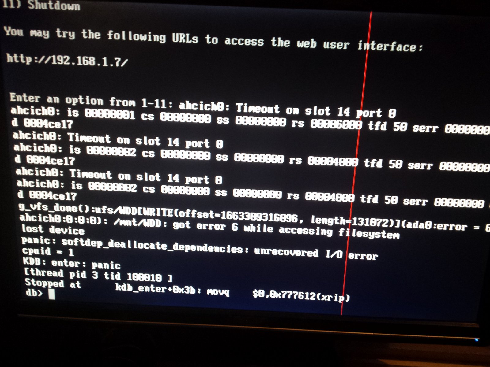

The problem which I am facing is that whenever I want to write something to the hard drive (say backing up my files from my PC), I'm able to copy the files for the first 5-10min, but then I keep getting this message popping up and basically causing my Freenas Server to crash as seen below.
(Sorry for the horrible camera work)
I have no problem reading endless amount of data from both of the drives regardless with the network card in place but it seems like no matter what I do, Freenas will crash whenever I want to write to the drives, Unless I use the stock 10/100 Ethernet adaptor that is built into the motherboard. I can transfer files (however very slow since its 10/100 only) without any issue and the problem goes away. However, as soon as I'm using a PCI network card, I am straight away running into issue.
So could anyone shed some light into my issue as it really driving me nuts.Would there be any benefit of upgrading to the latest version of Freenas?

The AHCI timeout is some sort of problem talking to your drive. I may add some comments in a bit.

Based on what I found from a google search it doesn't look like the onboard SATA controler is playing well. Likely the drivers in FreeNAS 8.3.1 are not very compatible.

It work fine and doesn't cause any drama if I only copy a small selection of files to the drive, however if I say doing a backup then it will keep crashing and causing my system to free and reboot. The problem is still there despite being on a newer version of freenas. It runs fine when I'm using the stock onboard Ethernet adaptor but using one of these PCI Ethernet adaptors seems to cause problem.
Looking at the results from the S.M.A.R.T test, it states that the self-test is completed without any errors.
Could it be a motherboard problem and that I should consider changing out the motherboard for it?

Timeouts on a single device could indicate bad drive, cabling, or port.

I tested it now with a P5KPL-CM motherboard last night with a version of freenas installed on a Quantum hard drive. The P5KPL-CM came with a gigabit Ethernet controller. I installed my WD Red 2TB as well and Lo and behold, I was able to transfer files without any issue. Moreover, I tried using the Intel Card as well and it performed exceptionally well, getting higher speed then the stock Ethernet adaptor. There was no crashing of Freenas whatsoever.
So today I pulled out my old motherboard from my Freenas tower to place the P5KPL-CM motherboard in it. After a bit of mucking around, changing parts around and the odd swear word hear and there, I was able to get Freenas to work the way I want it to.
Thank you to both joeschmuck and jgreco for helping me out. Really appreciated the help.
