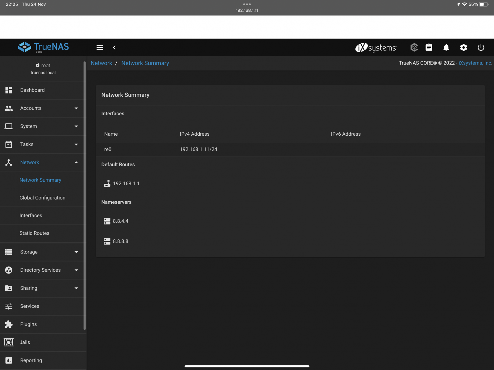

Just keeps getting worse. Restarted again and using Shell I pinged the gateway.. Got like 10 reply’s then it just stops. Checking for updates doesn’t show any updates or give you the message that no updates available. Just has the standard check for updates daily message and current train underneath. No mention of the version its on. Logging into my TrueNas Scale server I can ping the core one continuous without any drops. Nothing has changed in the network settings and I have DNS and Gateway configured as I always did. See screenshot

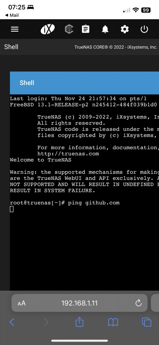

After a restart I can ping GitHub.com from the CLI but it reply’s for about 10 times then just stops. Doesn’t come back with a fail it just freezes. I’ve checked everything on my network, even moved it over to another Vlan but still the same.
