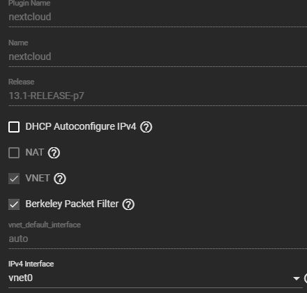

I have very strange problem with my jail accessing the host port. I searched for this over a week and can't find a fix, I even tried it with a second physical interface.
Jail has access to all open ports and devices on my local network except to the truenas host, i have ping to the host but can't access any of his ports. I try to telnet truenas ports from different devices and they are open.
I tried something else too, by changing nextcloud network settings and remove vlan, then the telnet start working but when i try to connect to nextcloud web interface on 192.168.1.12 its loaded the truenas web interface
This is my setup
host ip - 192.168.1.10
This is my setup
