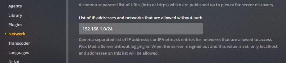

Sorry, add the IP (192.168.10.5/20) where? To some list in FreeNAS? Or do you mean a router setting?
I had that problem with 11.1U4 and this fixed it for me.
Make sure to add to Server/Network/List of IP addresses and networks that are allowed without auth to your subnet for example 192.168.5.0/24 to allow metadata to be downloaded.
Brilliant!!!!!!!
I just migrated from a warden jail to iocage a couple of days ago. I've been having the same issue - my new media will play in plex, but the metadata/posters will not download. Adding my ip/subnet (192.168.1.0/24) to IP addresses and networks that are allowed without auth did the trick! Thank you for the tip!
May 28, 2014
6
This fixed the problem for me.

I just want to report on this as well. This worked for me -- if anyone is having issues. It still doesnt' make sense why it works, but it does.
