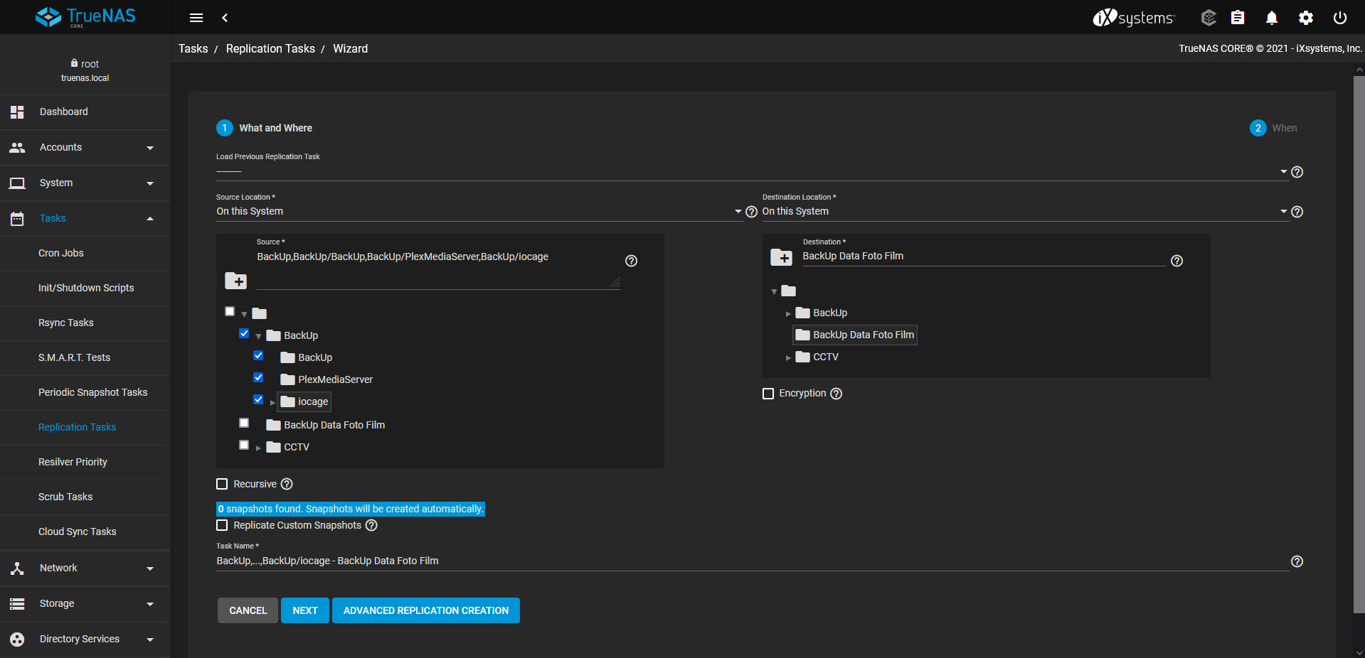

Would like your advice.
What is the fastest way to transfer the complete data from an old drive to a new one ?
It seemed to me that via replication tasks would be the quickest way.
Is this a good idea? See pictures.

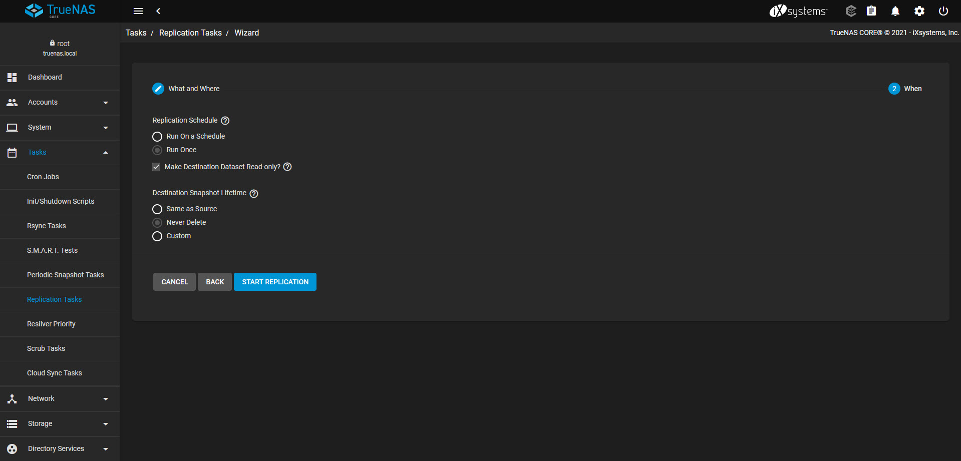

Should work, just "read only" checkmarked makes no sense to me.
K.J
Apr 3, 2021
84
Hey @QonoS
You say that could not be a problem because via replication tasks make a complete one to one copy ?
Read only should indeed be off. Am the only user on the system.
QonoS
Apr 1, 2021
87
Yes, if I am not mistaken TrueNAS replication uses zfs-send and zfs-receivce "under the hood", which is what the other guys recommended too and generally the best way to move data. You just do not need to fiddle around with CLI/Shell. ;-)
Roughly speaking it works like this: (1) A snapshot - lets call it "snap-mig" - of the original data is made. (2) "snap-mig" is being transfered to the new zpool. For a single dataset it would be like this:
oldpool/dataset1@snap-mig >>> newpool/dataset1
If you have multiple dataset as it seems than this happens for every dataset.
Just try it out. Replication won't harm your original dataset.
