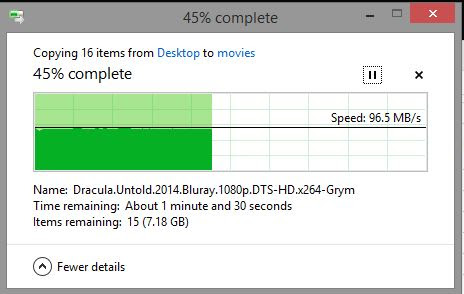

OK so it seems like wifi is my issue.
thanx for the suggestion to try a transfer hard wired into the router.
So now that I know the cause of slow transfer, what do I do about it?
Is there a better card I can get to get better speeds?
With my laptop right next to the router on wifi I got up to 19 MB/s
That shouldn't cause stutter on plex, should it?
How can I tell if the plex stutters are CPU or Network related?

The solution.. don't use wifi. It's a convenience technology, not a performance technology. Wifi absolutely can cause stutter if there is major latency and need to retransmit lots of packets. The solution is to lower the throughput needed for your videos by transcoding them to a lower bitrate.
