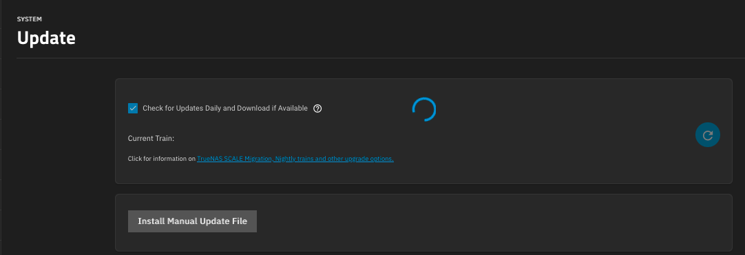

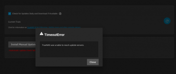

TN Scale update timeout - train is not visible
flashdrive
Apr 2, 2021
264
WebGui:
/ui/system/update
Error Message
TrueNAS was unable to reach update servers.
I can ping a random website via shell - host location is China.
What URL should I check for the TN Scale Update?
Why is the train not visible?

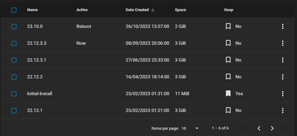

Bejeweld
Oct 25, 2023
6
Update: upgrading/updating this way works.
# cli
[truenas]> system update manual path="/var/tmp/firmware/TrueNAS-SCALE-23.10.0.update"
[0%] ...
[50%] Reading update file...
[50%] Verifying rootfs.squashfs...
[50%] Verifying truenas_install/__main__.py...
[50%] Verifying truenas_install/__init__.py...
[50%] Running pre-checks...
[50%] Starting installer...
[50%] Creating dataset...
[50%] Extracting...
[62%] Extracting...
[75%] Extracting...
[75%] Performing post-install tasks...
[77%] Running autotune...
[85%] Preparing NVDIMM configuration...
[85%] Preparing GRUB configuration...
[90%] Updating initramfs...
[95%] Updating GRUB...
[97%] Configuring FIPS...
[95%] Cleaning up...
[100%] Cleaning up...
[truenas]>

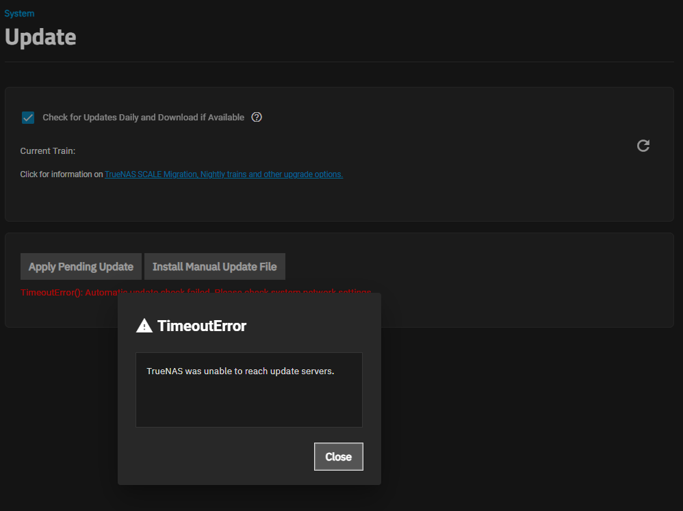

Bejeweld
Oct 25, 2023
6
I still have the same issue, even after upgrading to 23.10.
admin@truenas[~]$ cli
[truenas]> system update check_available
Error: TimeoutError()

Bejeweld
Oct 25, 2023
6
I'm still getting: "TrueNAS was unable to reach update servers."
Manually updating via the CLI works and downloading via your link as well, but it's all manual.
