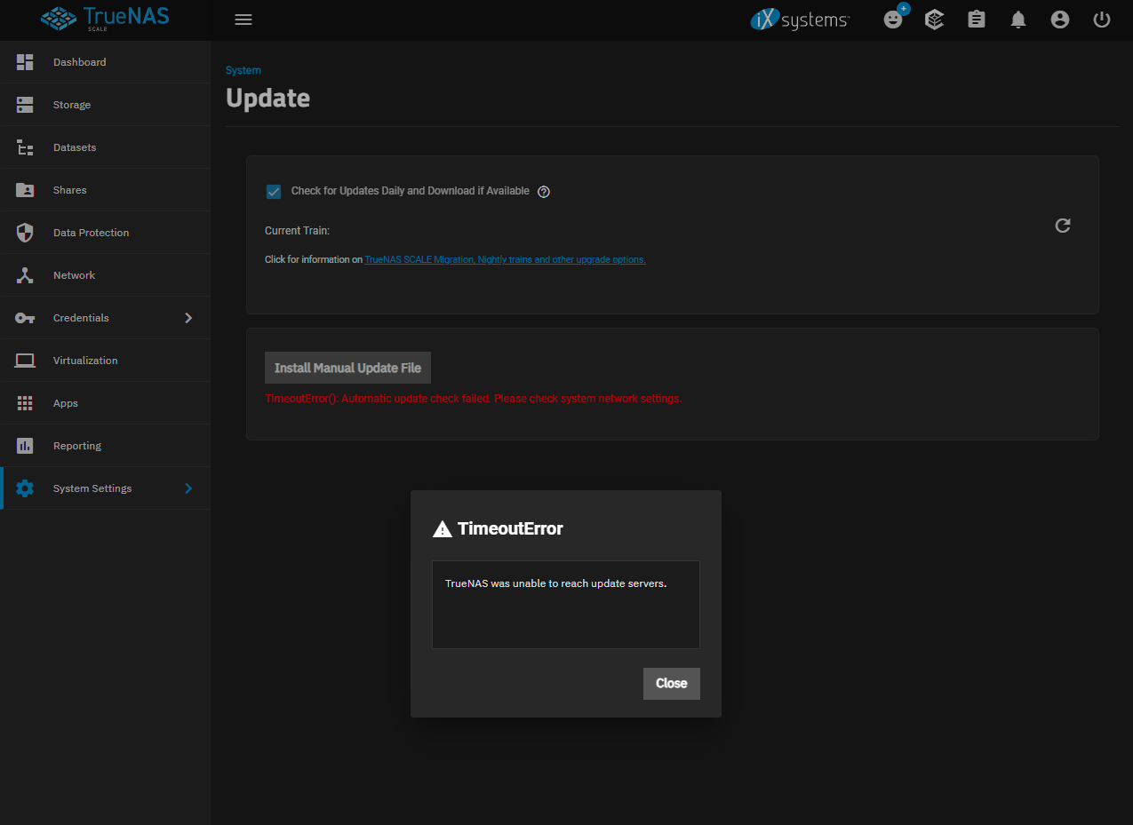

TimeoutError: TrueNAS was unable to reach update servers.
aphex3k
Oct 20, 2023
7
Looks like I have the same issue as posted here: https://www.truenas.com/community/threads/tn-scale-update-timeout-train-is-not-visible.112550/ However, there have been no responses. I would like to provide some addition information beyond what is visible in the UI and what seems to be commonly referred to as checks when a similar issue is mentioned here in the forum.
I'm on 23.10-RC.1 from a fresh install and configuration.
I was able to resolve update.ixsystems.com successfully as well as ping the resolved IP 136.0.77.2.

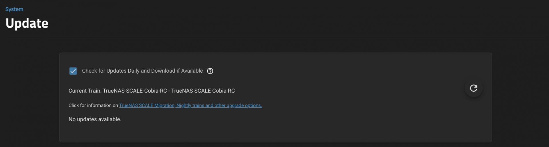

Disabling IPv6 in the TrueNAS network settings resolved the issue but that can not be considered a solution.

The only way I could make it work was by clearing out the IPv6 gateway (a FE80 address), so that only a IPv4 gateway remained. Then the GUI update check worked.
