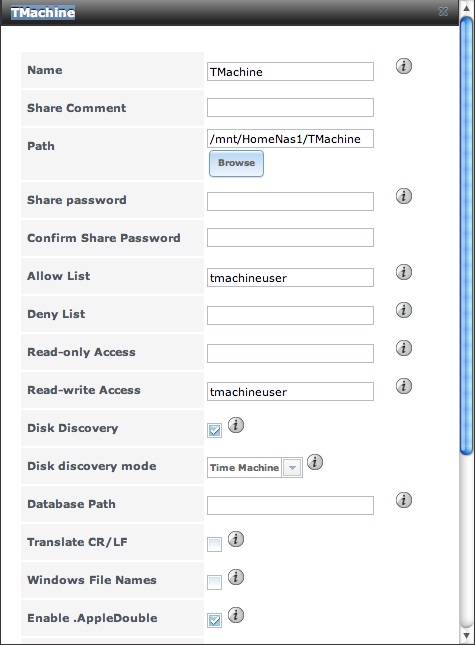

An AFP share with the name of TMachine as been created with:
Path: /mnt/HomeNas1/TMachine
Allow List: Maggie
Read-Write Access: Maggie
Disk Discovery: checked
Disk discovery mode: Time Machine

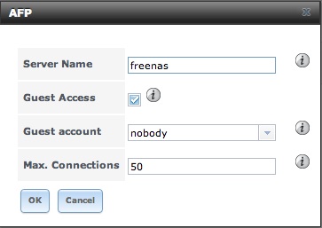

Services AFP has been configured as:
Server Name: freenas
Guest Access: unchecked

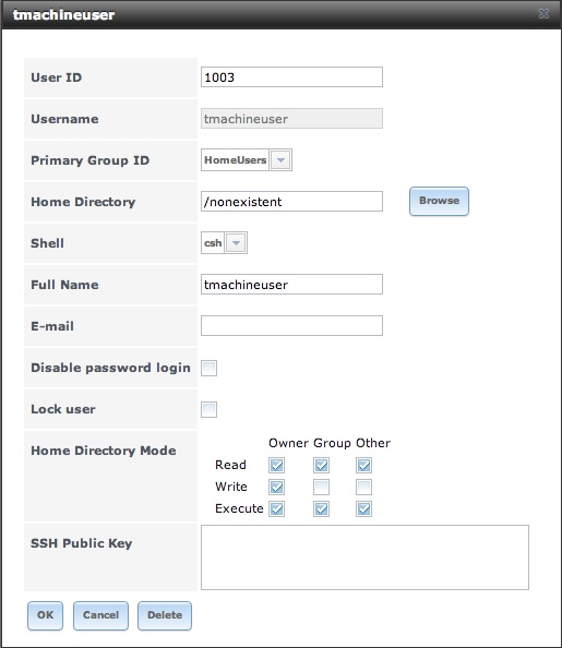

Thanks again. OK. I tried it. I created a new user, tmachineuser, on FreeNas. Put this user in the allowed list and removed Maggie from the allowed list. Now I cannot see freenas in Time Machine at all. (on my Mac, I am logged in as Maggie).
By the way, i don't have share password.
Anything else I should try?

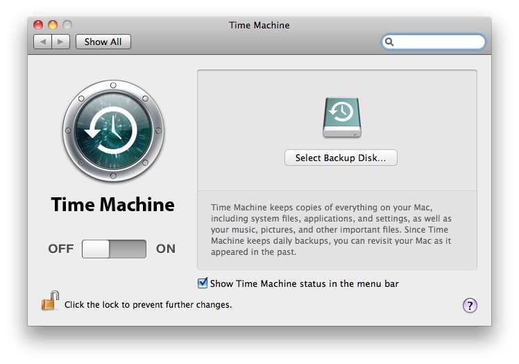

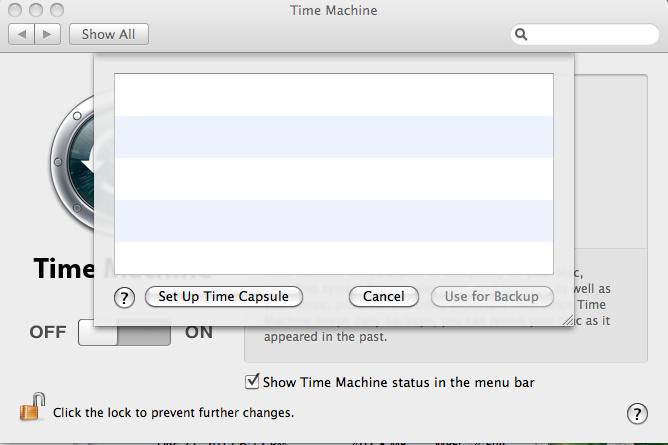

I can't find what you are describing. "TM Screen-1.jpg" attached is what i see when I go to System Preference: Time Machine. It has "Select Backup Disk..."
When I click on "Select Backup Disk" or click on the OFF-ON slider, "TM Screen-2.jpg" is what I see.
I figure perhaps I should go to Finder to mount the AFP share first. So, I go to Finder-Go-Connect to Server. I entered to Server Address afp://192.168.1.195. Entered tmachineuser as Name and the appropriate password. After clicking Connect, it asked me to "Enter the password for TMachine, on the file server freenas". It appears that it is asking for a share password, but I did not set a share password for TMachine dataset. Doesn't matter what I enter (or leave it blank), it tells me connection failed, "You do not have permission to access the server 192.168.1.195".

Okay, so TM isn't set up on that machine, which is fine. So, what should happen is that you click "select backup disk" and that second screen should show the TM share that you've setup on FreeNAS. You shouldn't need to log in separately. Have you tried turning the AFP service off and on in FreeNAS? Can you attach a screenshot of what the AFP and Time Machine share configurations look like in FreeNAS?
wachen
Dec 28, 2012
17
I turned the service off and back on in FreeNAS. The share did show up in Time Machine (at least some success)! However, I am getting the same error (OSStatus error 13) even using the different user name I created.

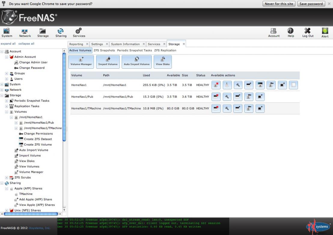

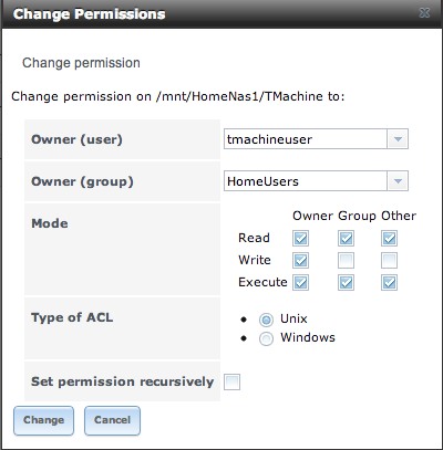

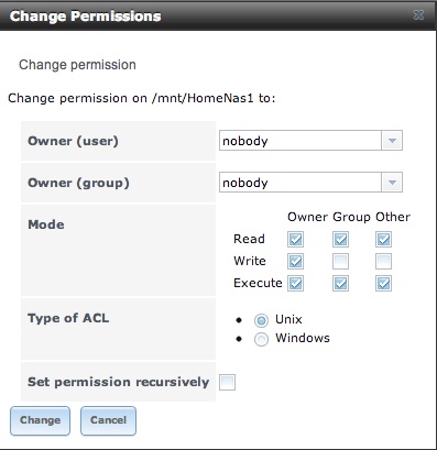

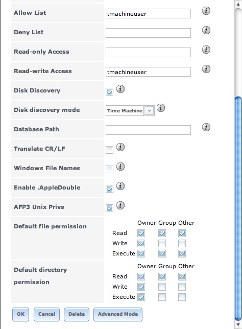

Here are some screen shots of the configurations. Please take a look.
I really appreciate all the help.

I think what I would do is change the dataset permissions:
First, try changing the permissions to include "recursively" -- stop/start the afp service -- try another TM Backup
If that doesn't work... Try changing the permissions to add write access to group and other recursively -- stop/start the afp service -- try another TM Backup
If that doesn't work... Start over. Turn off TM sharing on this dataset in AFP sharing. Then create another dataset with the settings that are supposed to work. stop/start the afp service, etc....
I really hope you don't get to step 3, but if the first two don't work, it's worth a try.
wachen
Dec 28, 2012
17
Thanks.
First two are not working. I guess I will need to start over and see if that works. Will report back later.
