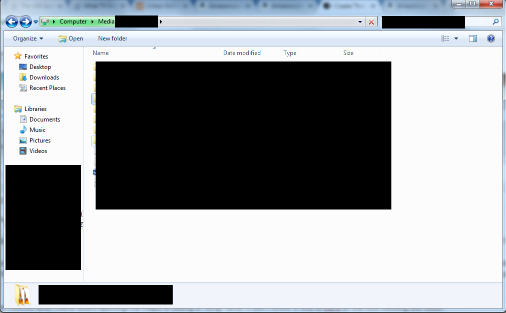

2) I've noticed after many years opening my maps is taking a "long" time. I don't know if this is CIFS or the box causing the issue. Opening a share takes 15-20secs. Picture included. What can I do to figure out what is causing this delay? But only the first time it's opened, and then again after 'some time here'. Looks like this is a caching thing but don't know enough to figure out what is causing it.

I found some settings on another thread about CIFS so I've adding the following:
ea support = no
store dos attributes = no
map archive = no
map hidden = no
map readonly = no
map system = no

The image has all the information blacked out. Not helpful.
Ya, but you see the green bar at the top? It says like that for 20-30 secs. I think I might have found a solution, but more testing will be needed.
