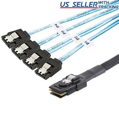

You would just need to flash it to IT mode..above listing comes with cables ..otherwise you'd need:
Length: 1.6 Feet / 50cm. • Adaptec ASR-5805/512MB SAS RAID. DIY OR PRO INSTALLERS both appreciate the convenience of a forward fan-out cable with an internal mSAS connector when expanding storage needs • Slim ribbon cables minimize airflow impact in a computer case.
Mini SAS 36 pin SFF-8087 to 4 x SFF-8482 cable. Internal miniSAS SFF-8087 to (4) SFF-8482 connectors with SATA power power. SFF-8482 side with the 15 pin power. 1PCS SFF-8087 to 4 x SFF-8482 Cable.
do you have a link to this flashing ?
www.ebay.com
this looks like it's the same SASD -> 4x SATA (but with included power point into which I then plug my connectors, Not sure I'm going to have space for my power connector fitting in behind this power connector on the side of my machine.
I'd prefer the other just 1 SAS -> 4SATA connectors but they seem to have run out of stock.

so ordered : IBM ServeRaid M1015 46M0861 SAS/SATA PCI-e RAID Controller = LSI SAS9220-8i
from one of the sellers on eBay, now to order a cable setup from someone local. going to be cheaper than also internally ordering it, as it is my shipment on the above card is 3x the cost of the card.
