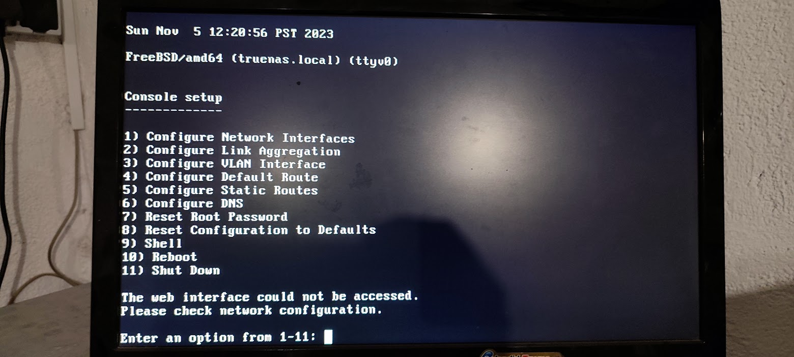

Hello everyone!
Previously on this computer I had FreeNAS 11.x and everything worked but it became obsolete.

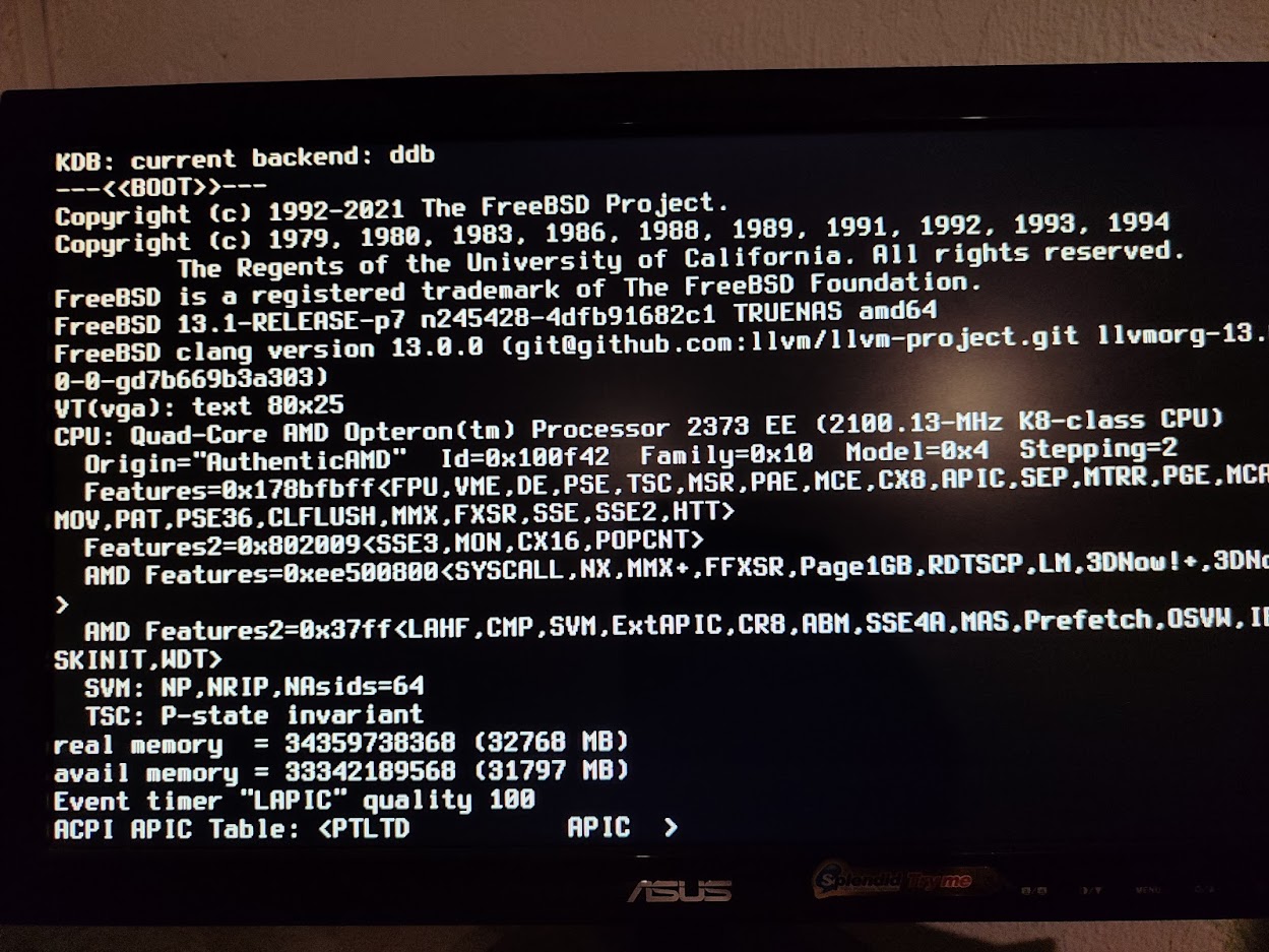

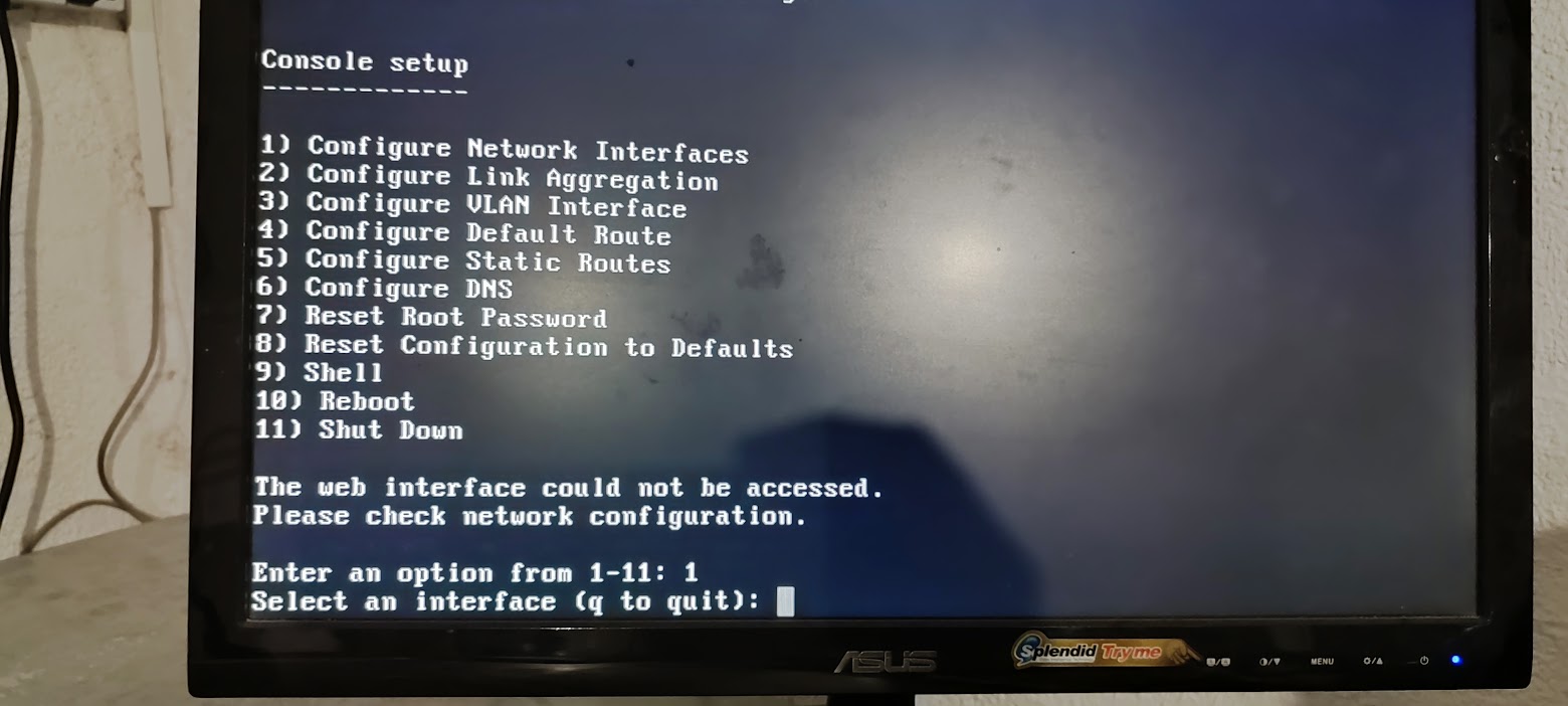

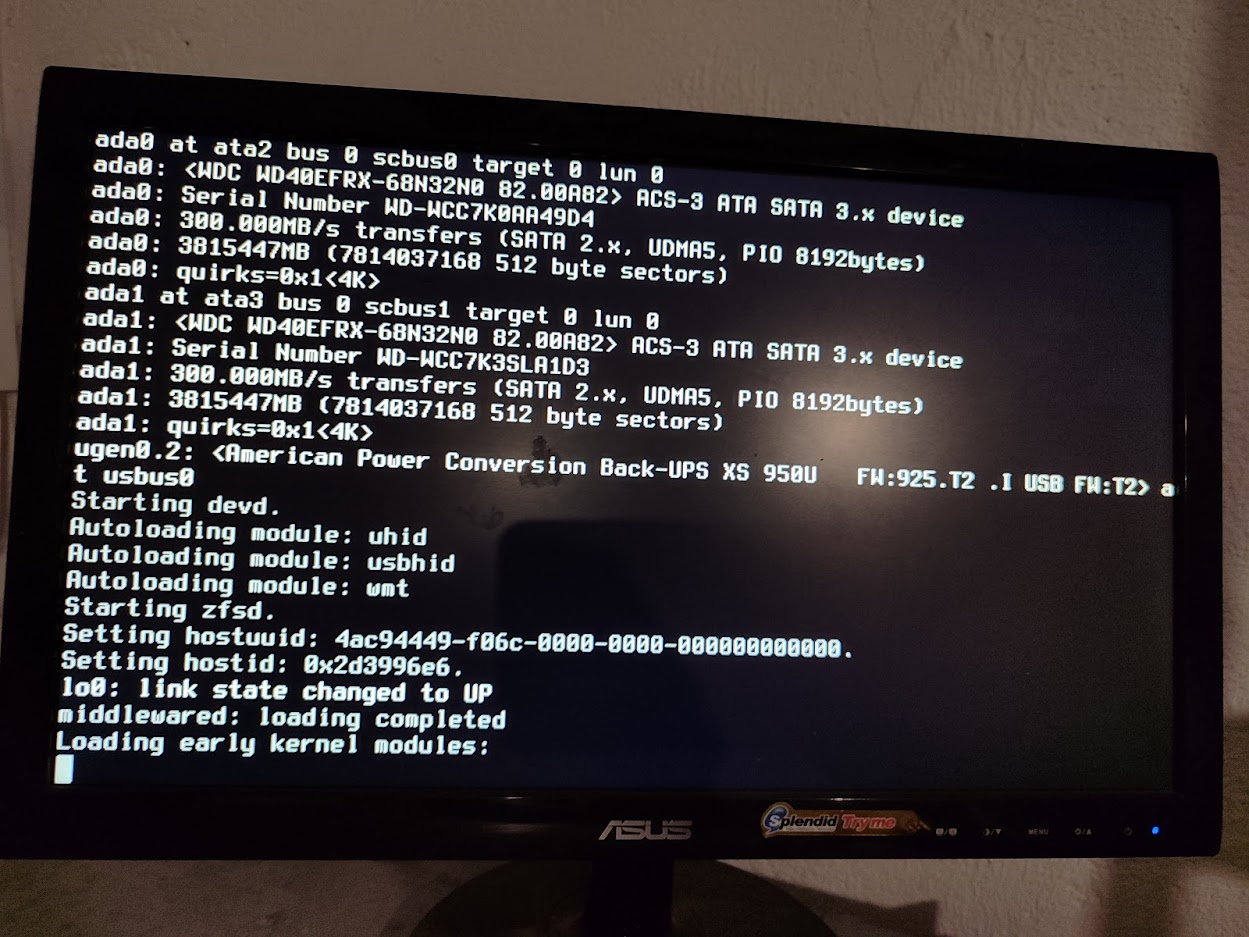

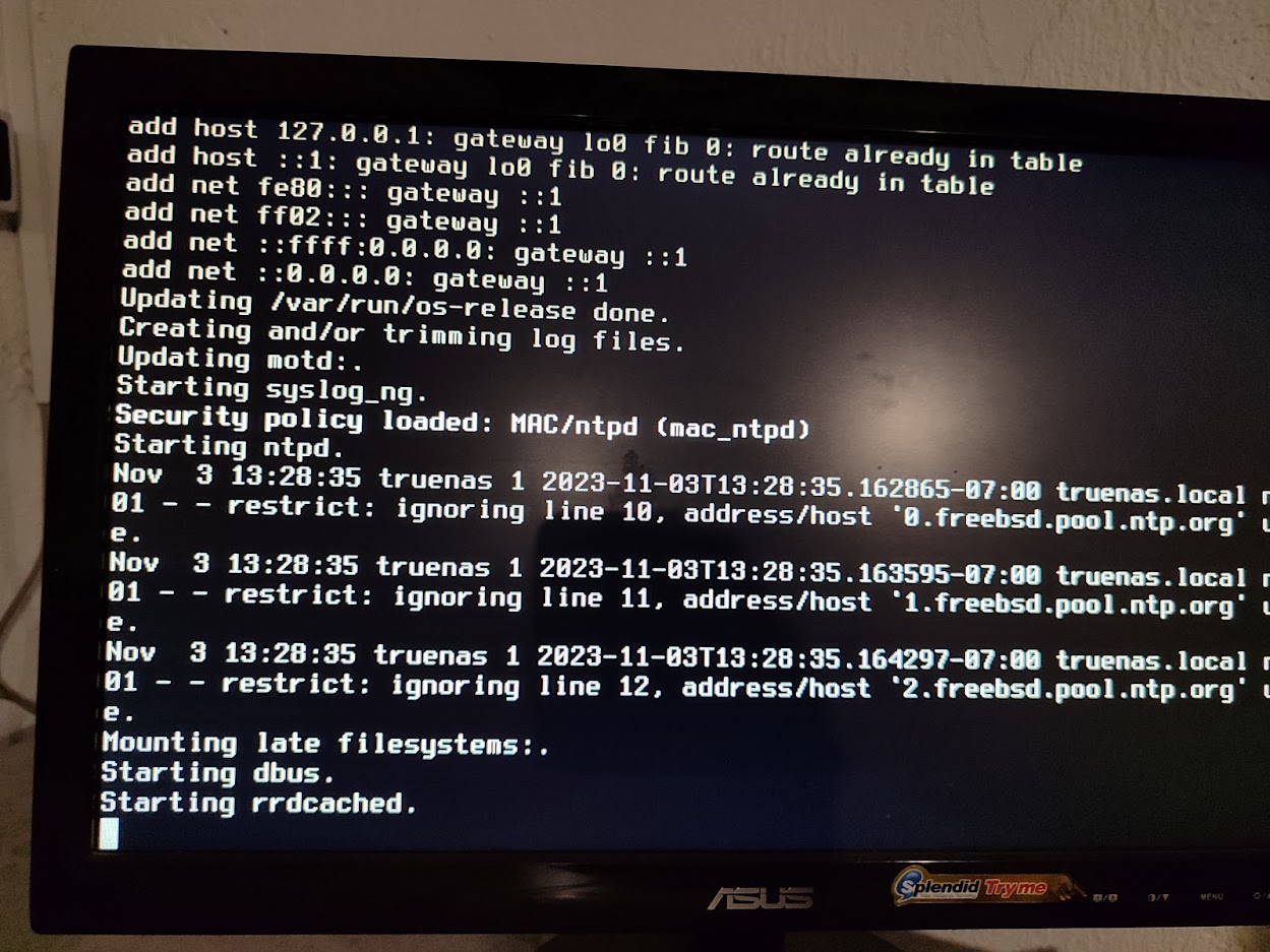

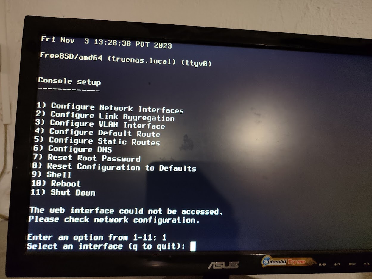

I have decided to start from 0 and it occurred to me to install TrueNAS (FreeBSD 13.1-RELEASE-p7 n245428-4dfb91682c1 TRUENAS), the installation was OK until the reboot where I discovered that I do not have access to the web interface.
I have tried changing the interface cable (since it has two) but nothing in any of the cases.

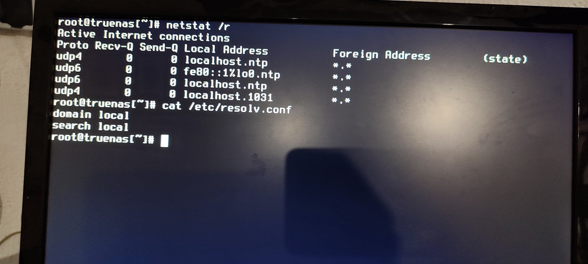

I leave you a little information

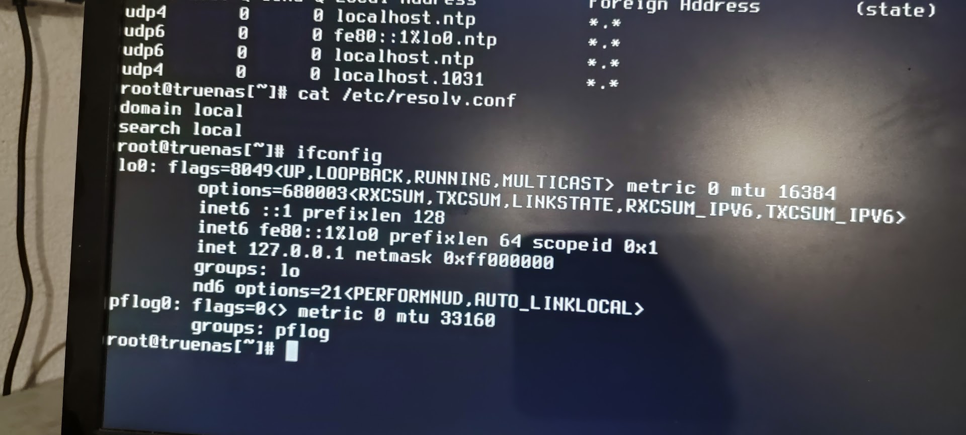

root@truenas [~]# ifconfig
lo0: flags=8049<UP,LOOPBACK, RUNNING, MULTICAST> metric 0 mtu 16384
options=680003<RXCSUM, TXCSUM, LINKSTATE, RXCSUM_IPV6, TXCSUM_IPV6>
inet6 ::1 prefixlen 128
inet6 fe80::1%lo0 prefixlen 64 scopeid 0x1
groups: lo
nd6 options=21<PERFORMNUD, AUTO_LINKLOCAL>
pflog0: flags=0<> metric 0 mtu 33160
groups: pflog
root@truenas [~]# |
Any suggestions? I
From already thank you very much.
I hope you can help me

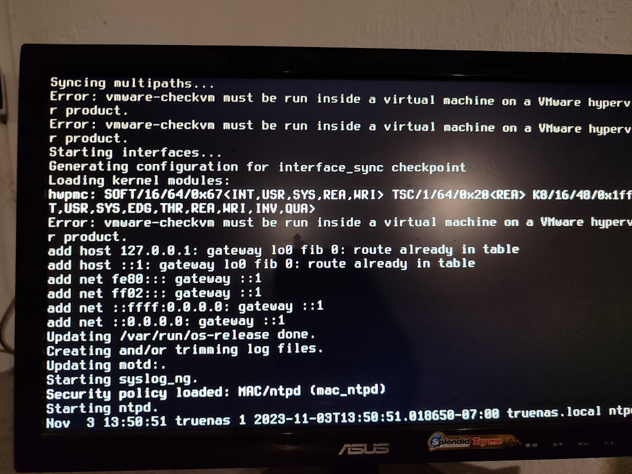

If I remember that chipset, it supplies an Ethernet port through the nVIDIA chipset. That chipset is pretty old. Like 15 years old. It appears that TrueNAS Core does not have the drivers for that chipset any more.
You may want to try TrueNAS Core 12.x and see if the network interface shows up.

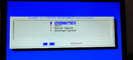

20

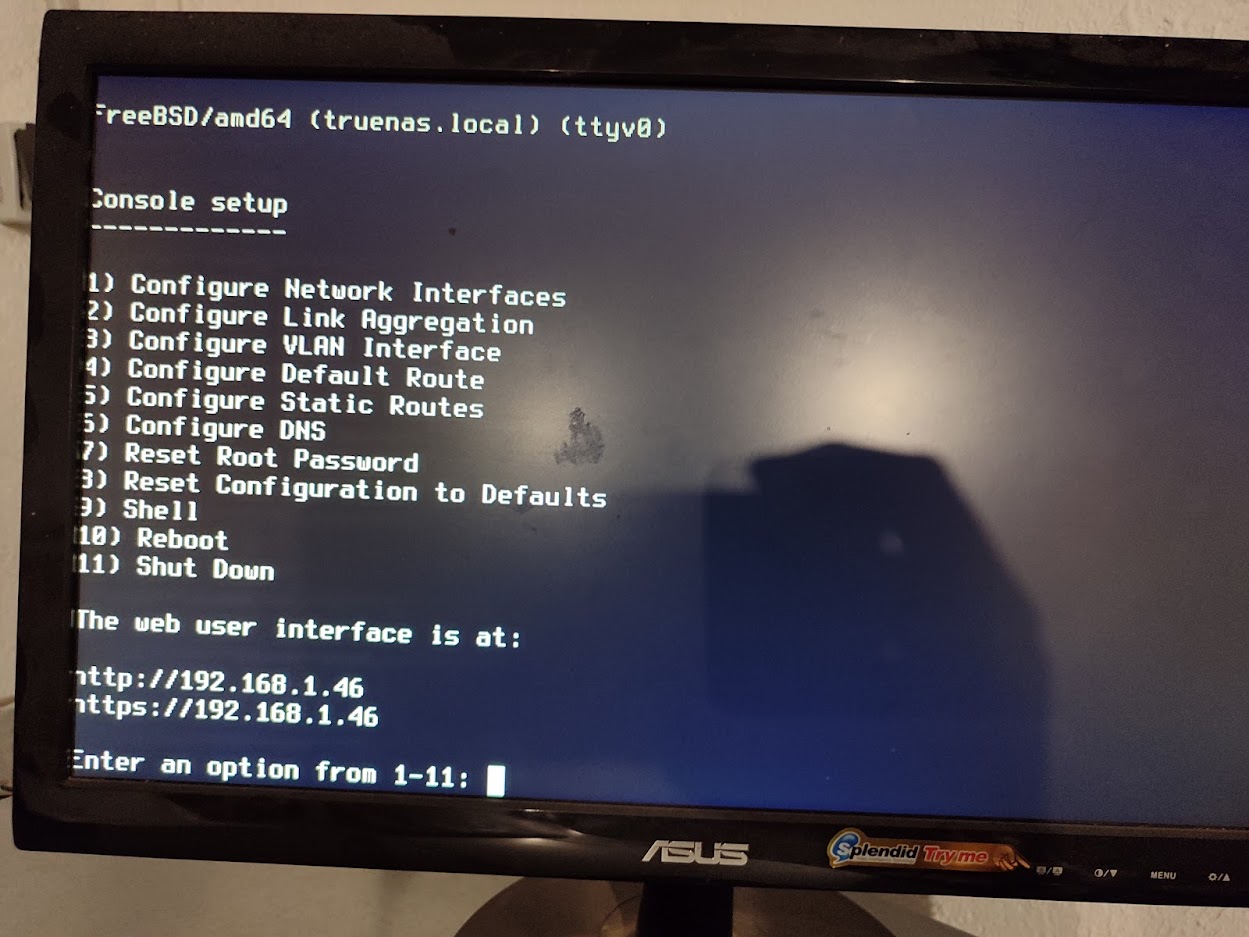

@Arwen I just did the install but unfortunately with the same result .....

Then, if you want to stay current, their are 2 options, buy a supported Ethernet card. Or perhaps try TrueNAS SCALE.
However, the second option seems like it would not work for you. SCALE is based on Linux, which does not support Jails. SCALE does have Apps and VMs which might work for you. Though the development is on-going which at times reduces stability.
On the first, Intel Gigabit cards are highly recommended and are pretty cheap, at least in the U.S.

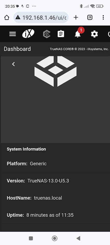

@Arwen I finally got a much newer SuperMicro so when I installed it to test everything went smoothly. Thank you so much
