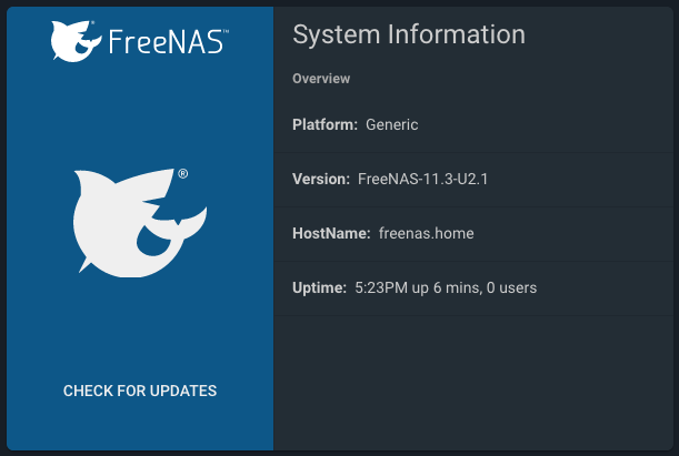

Update to 11.3-U2 done.
Haven't discovered any problems yet. But what is awesome: the bug introduced with 11.3-U1 (change of filedate when you called the file via SMB) is now fixed! That bug caused a lot of trouble on my machine especially for users who uploaded there photos in their home directory. Glad that this is fixed now!
So thanks again iXsystem for fixing this and for an amazing product! :)

Quick update to 11.3-U2.1. Reboot. Done. It just works! :)

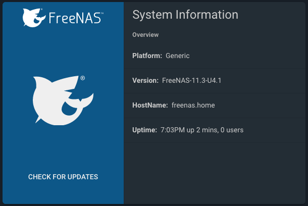

Last update before the next big step and upgrading to TrueNAS 12.0 ... :smile:
So far no problems, reboot, done :smile: Thanks iXsystems :smile:
